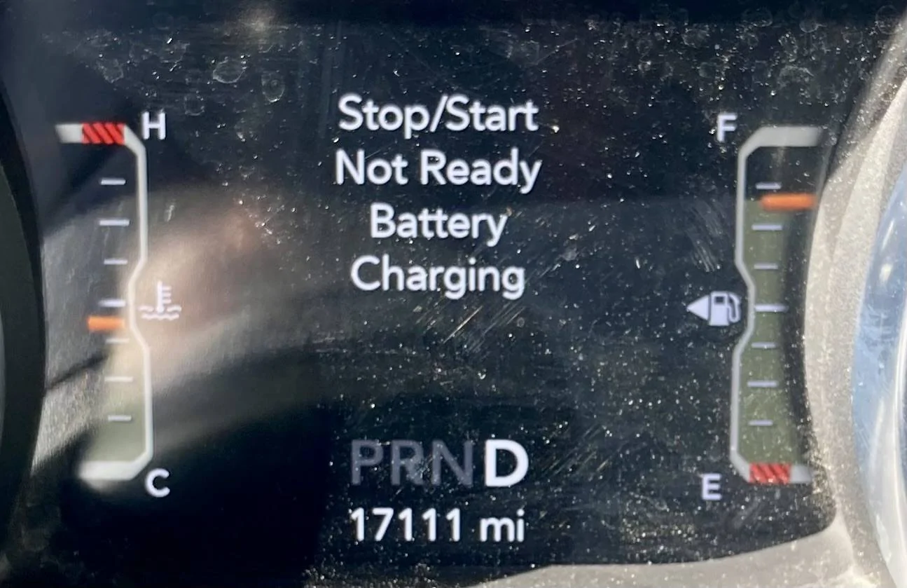

2020 Wrangler showing this message. The battery is fine. Does anyone else have this issue?

Not uncommon if most of your driving is relatively short distances. A longer drive (more than 2 hrs, say) should take care of charging it up. I've gotten this along with "Battery Protection Mode" recently in temps under 45F. Both go away after a long drive. My main battery is 2yrs old now (aux battery only 6mo), so it may be showing wear even though it tests fine with a load tester.
Why/how do you say battery is fine?
You know you have two, correct?
Did you check the voltage?
Did you check each battery's voltage independently?
If they aren't 12.7 volts, then they aren't 100% charged. 12.4 or less tends to show this message.
If you don't drive daily, or you don't drive over 30 minutes a day, they won't stay charged up.
You need to check the voltage.
Then - disconnect the negative cables from the main battery, separate the two negative cables.
For a 2020, the top cable should be the ground cable for the aux battery hidden under the PDC.
You can connect a volt meter to that negative cable and to the positive of the main battery and check the aux battery voltage that way.
Check each battery.
Use a good AGM charger (a real charger, not a 2 amp or less tender or maintainer) charge each battery independently.
With them disconnected, check the voltage of each battery after a few minutes. they should read at least 12.7 if they took a full charge.
Reset the IBS.
When done charging the batteries, and having let the IBS sit disconnected from the main battery for 10 to 15 minutes, put it all back together.
Unless you checked the battery voltage - then checked each battery by itself, you can't say both are good.
Frankly, a 2020 means 3 year old batteries and that's about it for these.
Especially if you don't drive it regular, and don't drive for long enough times. Batteries with reduced charge don't last as long.
That's really low miles for a 3 year old vehicle - and that alone suggests to me your batteries are needing to be at least load tested (only after a full charge of each) and likely replaced. Those miles indicate infrequent and/or short drives, reducing battery life.

Thanks for the details. It goes to the shop for corrosion paint correction next week. It helps to have some knowledge going in. Let ya know what they say.

My shop confirmed both of the batteries are shot. My Jeep is out of warranty for the batteries but they are replacing them at no cost to me. Angelena at AutoLand in Springfield NJ is the best! They are also sorting out my corrosion issue.
