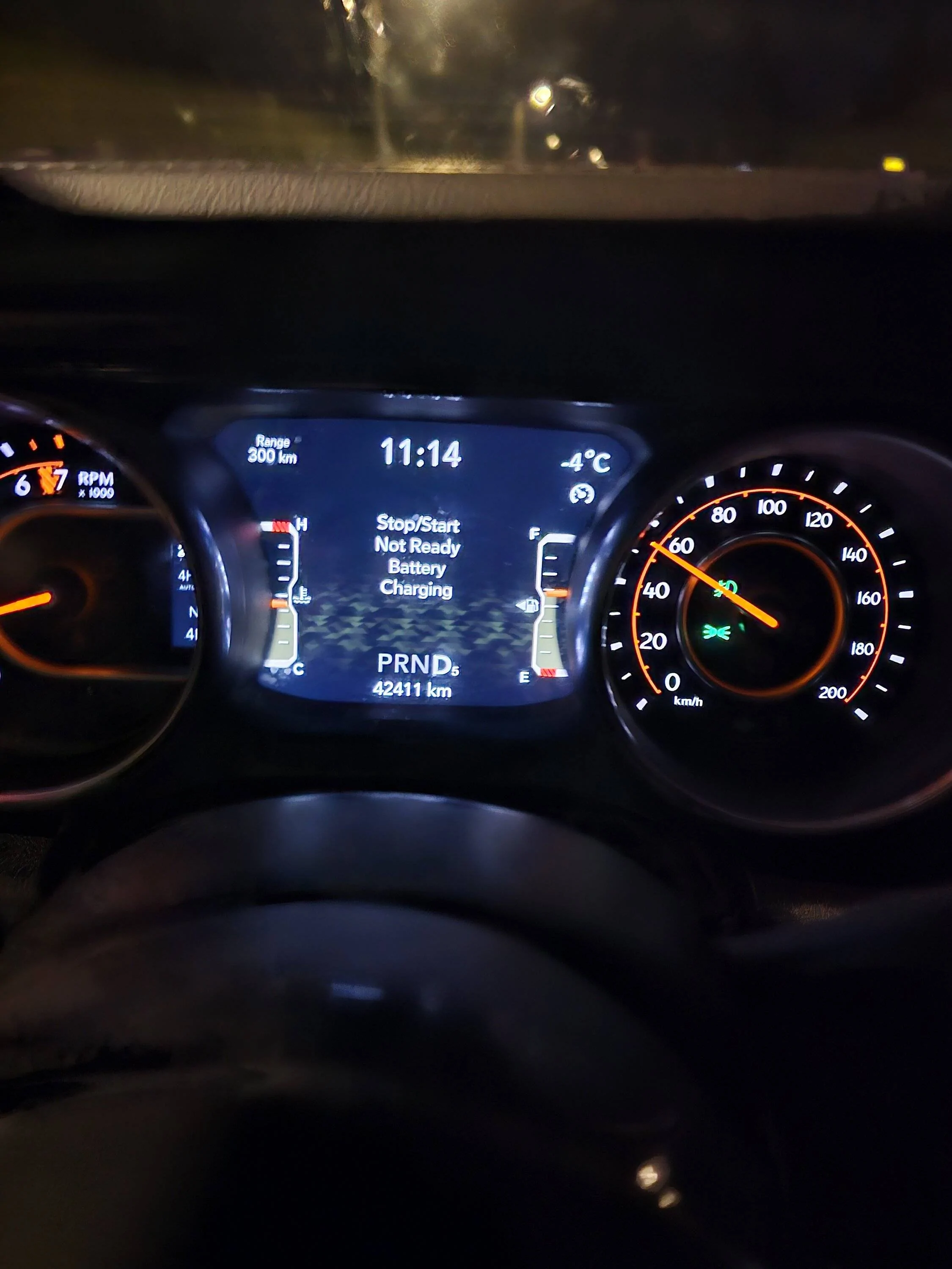

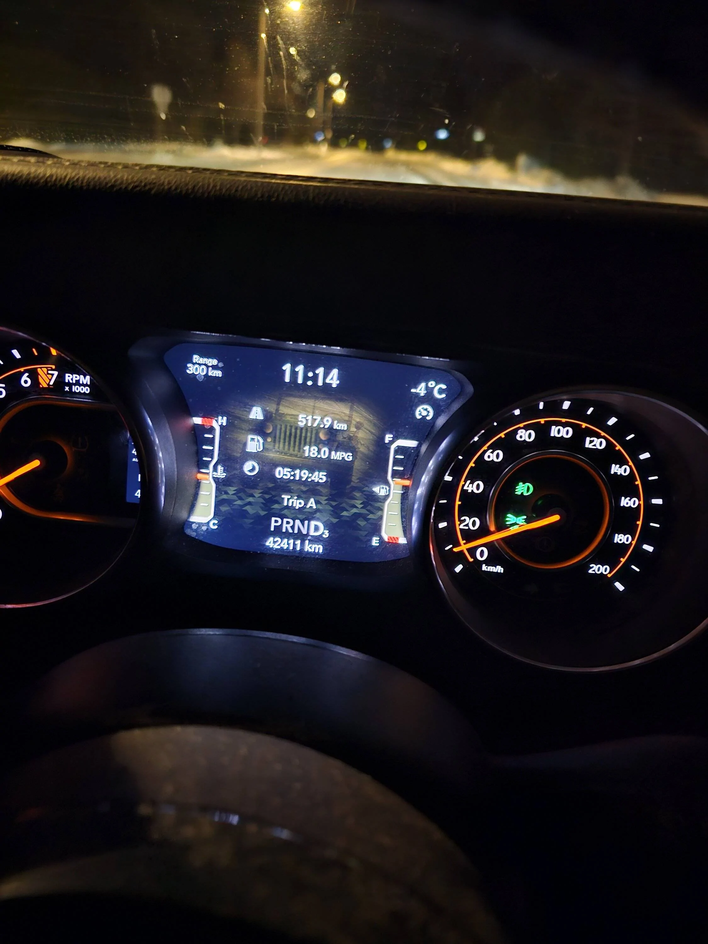

Well 4 times at the dealer with no resolve. Drive the Jeep a good distance I was told. Well 519km later at a speed of over 80kmh I still have a charging battery message. Well 2 years and this is my last Jeep. To many issues that I have never experienced in 20 cars and a few Jeeps in that mix. $70k piece of crap Hopefully, sales will decline like the quality has
Besides telling you to drive it, what else did the dealership do?
If your Jeep is a 2020 and the batteries are the originals… I’d start with replacing those..
"70k" but you can't just put a couple of batteries in it?
It's a 2020 with 40,000km or 25 000 miles. Not the only issue that had to be fixed. The dealership said that it would
Yep 70k piece of crap
