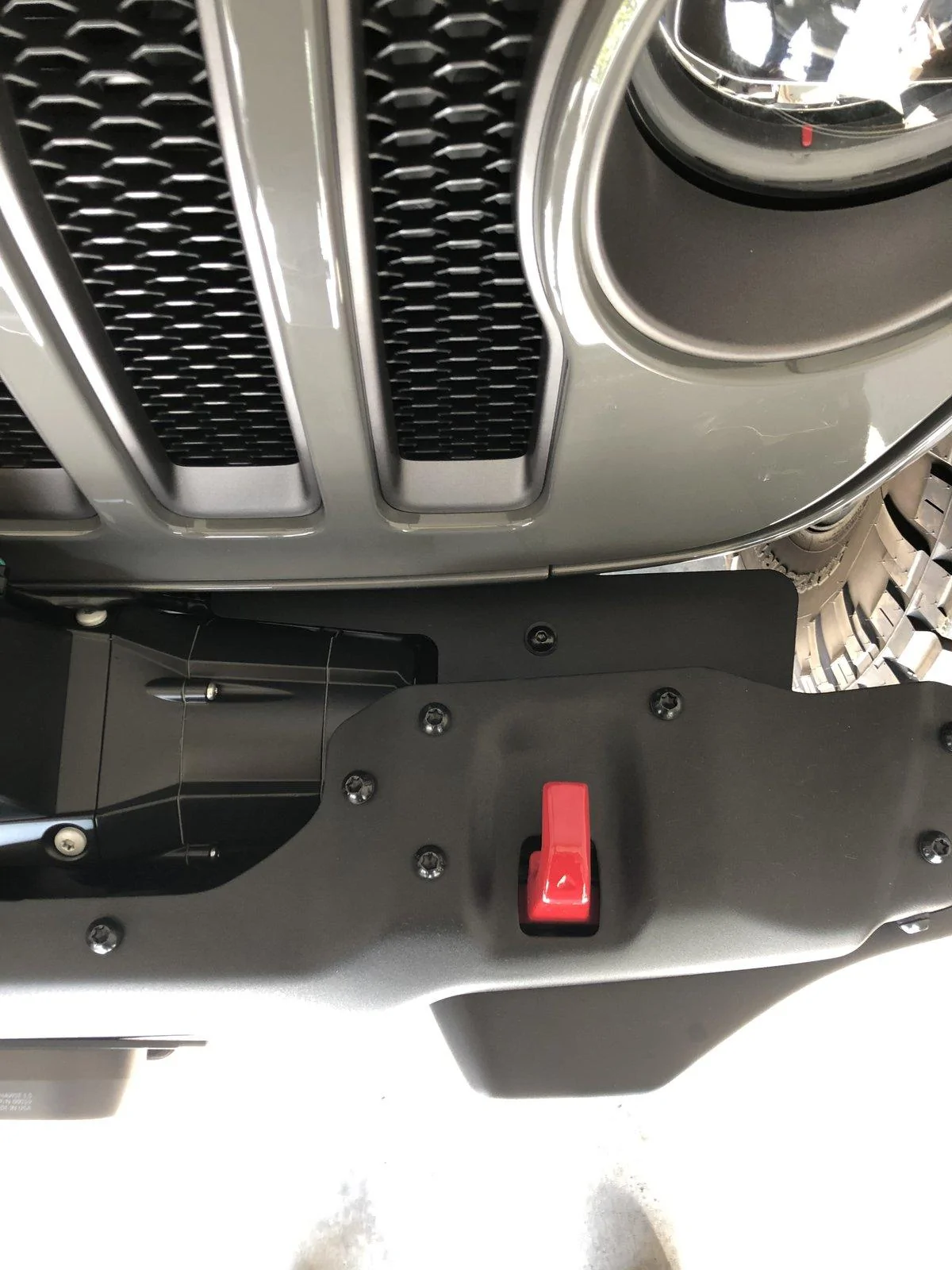

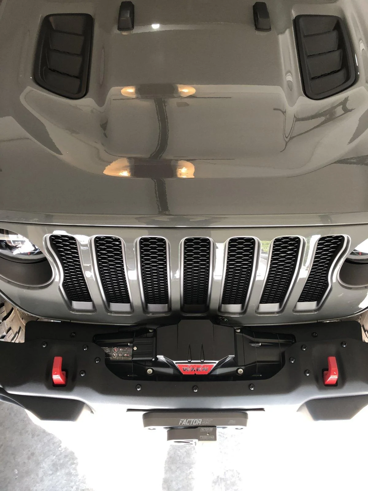

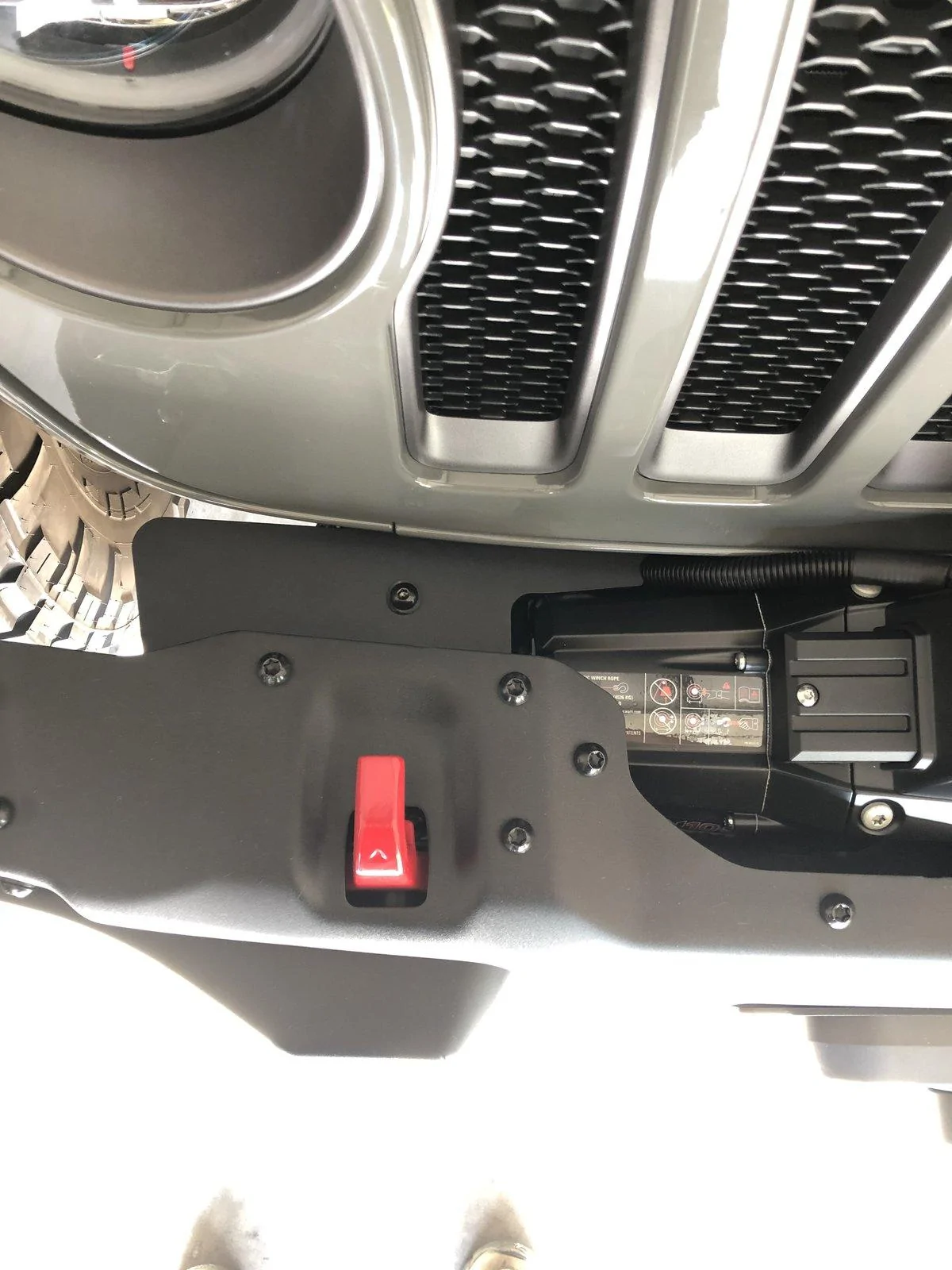

Here's some pictures of my Maximus plates (along with some ugly cube light wiring I still need to zip-tie out of the way). They are very good quality and very easy to install. The provided self-cutting screw taps threads into an existing hole on the bumper. Maximus sells two plates - one for Warn winches and another for all the other winches, be sure to order the right one.
Thanks for the info I'll be sure to get the correct filler plate. That looks like it fits great do you think it would be a good idea to find a cover for the top of the winch?
Thanks Again for the pics!

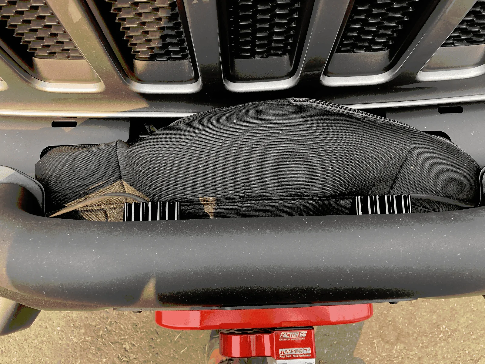

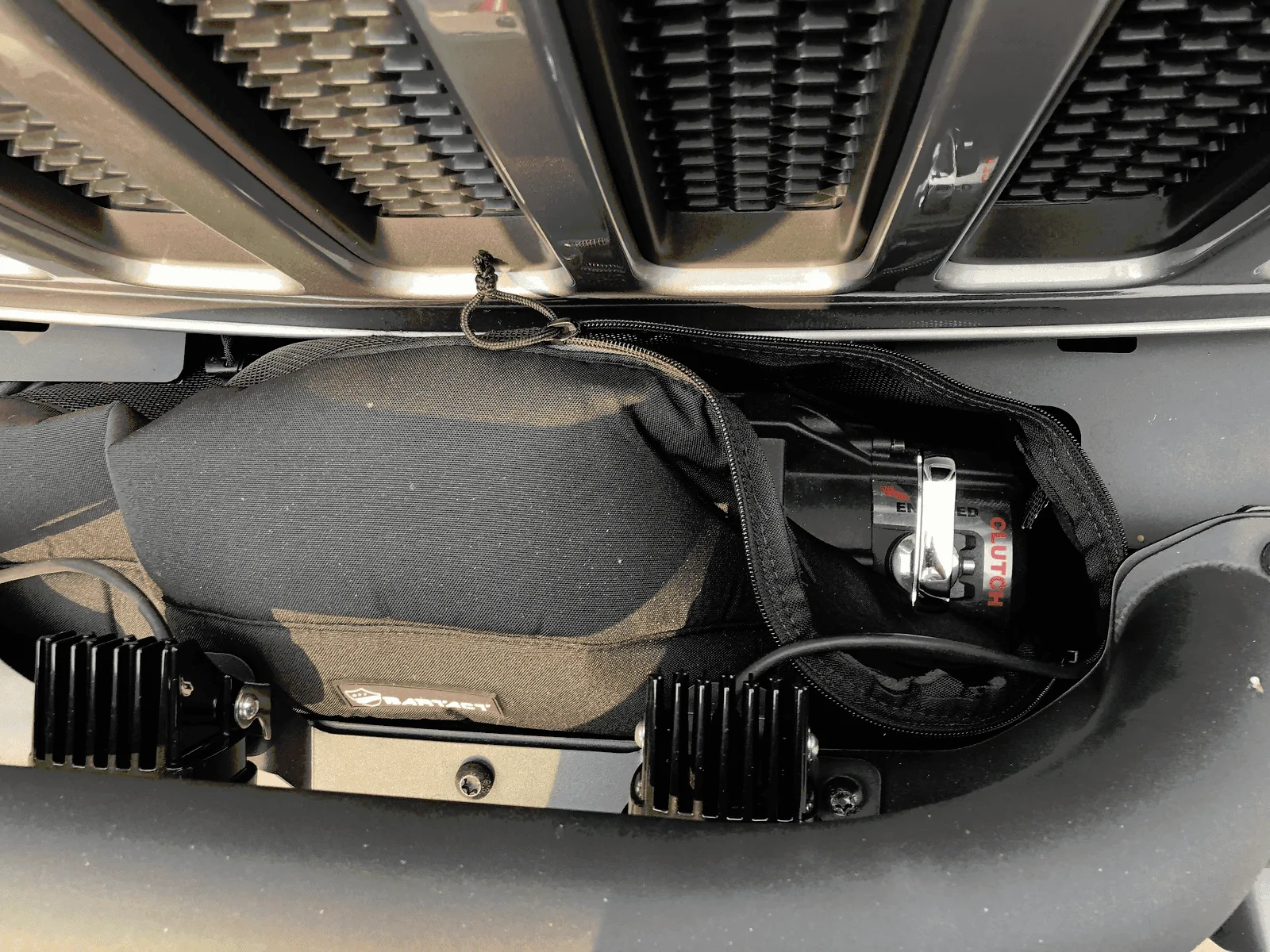

With the steel bumper group and the filler plates from Maximus-3 is it still possible to fit a winch cover to protect synthetic line? If so any recommendation?
FYI I will be installing a Smittybilt X20 12000lb winch with synthetic line.
The Bartcact winch cover looks good and I found a few reviews that say it fits the x20 but with the way the winch is sunk into the bumper and with the filler plate I wonder if its possible to put on...
Did you ever get a winch cover installed with the plates?

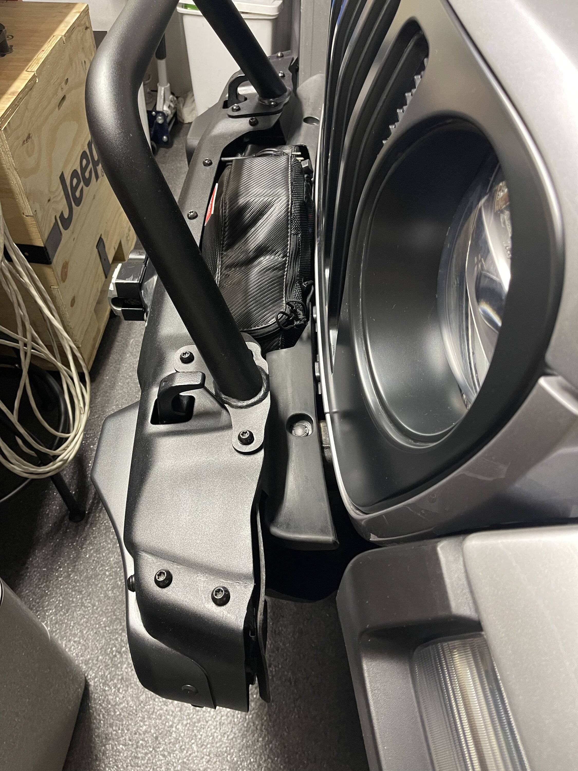

Thanks, did you have to remove the trim plates to install the cover?
Yes you do have to install with the trim plates off (easy to do) but after it's on and the trim plates are installed you have all the access you need through the zipper to operate the winch.

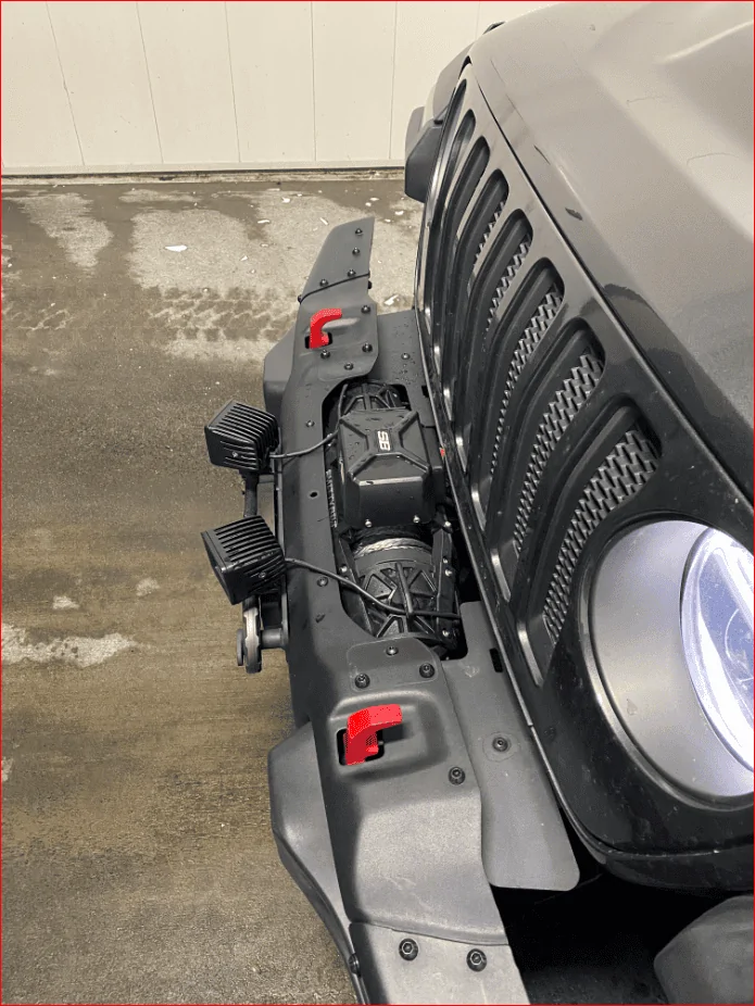

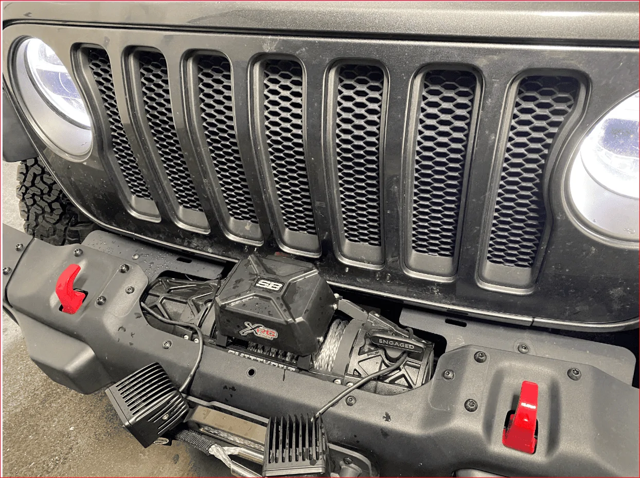

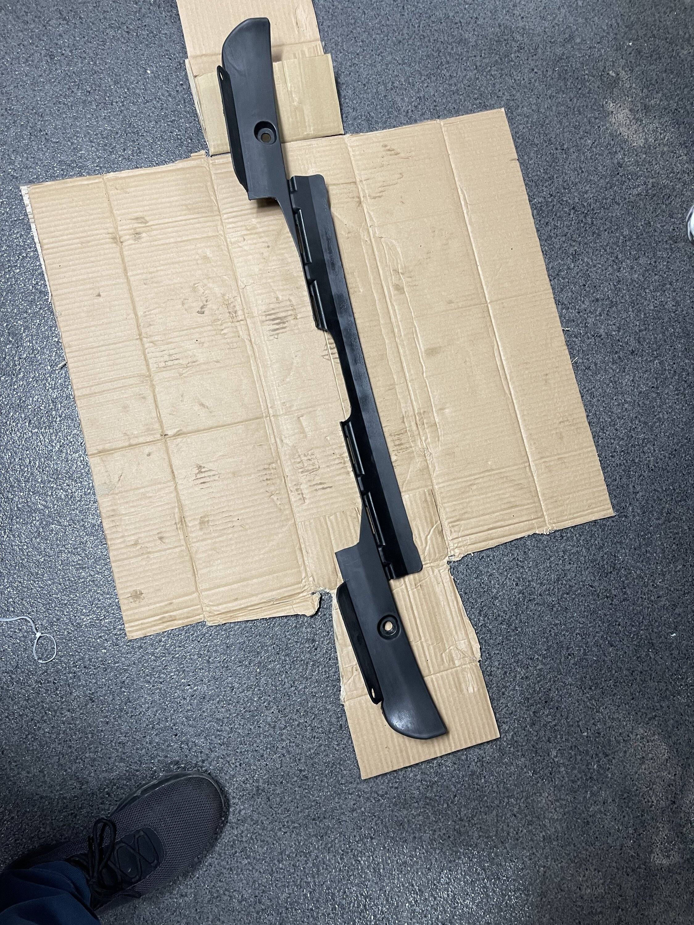

Reviving an old thread for search sake since I just had to deal with that unsightly gap myself and wasn’t aware about options to adress it til now.
Anyways what I did was use the finishing panel from a plastic bumper optioned Sahara/Rubicon, cut it to shape around my Warn Evo 10s. Worked out great imo.
