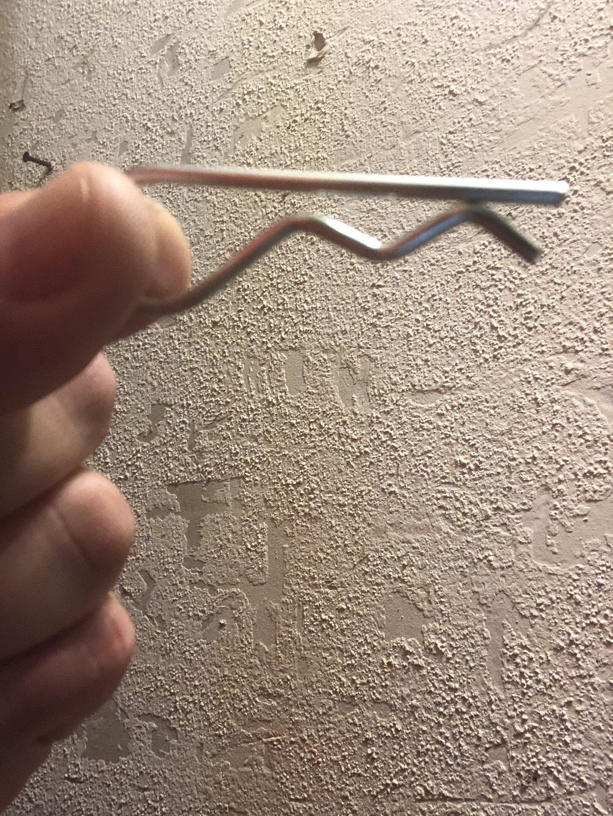

My soft top window was warrantied by Jeep and I greatly appreciate that! However, for anyone that has a 2018 Rubicon/Wrangler JL with the premium soft top I would highly encourage you to seek additional "securing methods" for the soft top panels when in use. There are no zippers or snaps for these panels and they will "fly off" at some point due to the plastic wearing out, stretching, etc. We've only had our soft top in use for 3 months. I'll be adding a high grade velcro or straps to help keep them in place going forward.
Aug 12, 2019
NH
2018 Jeep Rubicon JL

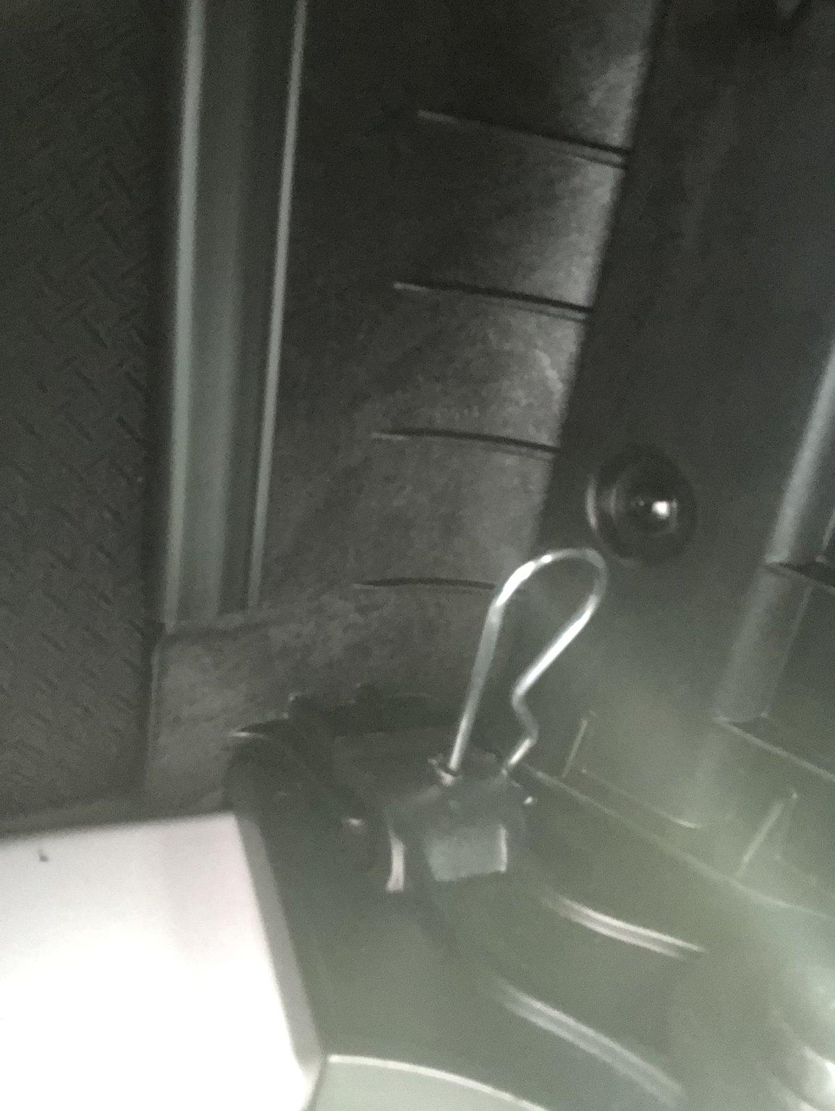

Update: I drilled a pilot hole through the window mount and base mount to place a pin in it. Trimmed a 1/16th of an inch off on both ends of pin to secure it. Cheesy fix but should withstand a blowout.

No sweat! I figure @68 cents each from Home Depot is a better alternative than losing a window and waiting for a replacement. I might make it “Gangsta” and paint them black to hide them a bit. We’ll see what the mood strikes

Hasn't happened to me yet but I could easily see enough pressure causing that bottom slot to pop out then a window would take flight. Schism75 has an excellent idea though I keep wondering what else might look "prettier" than a hitch pin. Not that anyone else would see it. A self-tapping screw would probably just strip or become loose over time.

Thanks! I’ve found that the pins hold better if reversed, facing forward ,and pitched down so the end of the pin hooks in the opening of the plastic mount. I’ve ran highway speeds several times with zero issues. Tried different variations like sun rider mode with windows up and sun rider with all windows down. Cheap fix and I also
tethered my pins to the roll bar when not in use.
