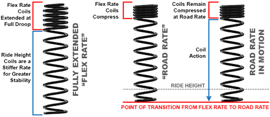

Jeep Wrangler JL Shock Question For the Experienced Guys... True-Dual-Rate-Coil-Ride-Height
Nice gif showing Metalcloak's "True Dual Rate" and road rate. As stated earlier, their road rate is not progressive. Unfortunately I've never seen Metalcloak give spring rate values.
In my opinion the only advantage to a dual-rate spring is if you're shocks are long enough to unseat the coil, otherwise they will perform exactly like a single-rate spring (as shown in the gif above). This happens in the front when the shocks are at 26.25"/27.5" (Sport/XR), rear 27.75" (Sport). Spacers will increase these distances proportionally.
For example: a Sport with a 1.5" spacer will unseat the springs at roughly 27.75" front, 29.25" rear. This is enough to cover almost every 2"-3" shock, and many 3"-4.5" shocks. Plus you get the benefits knowing the exact lift height, lower cost, and not changing the spring rates (which may or may not be desirable).
