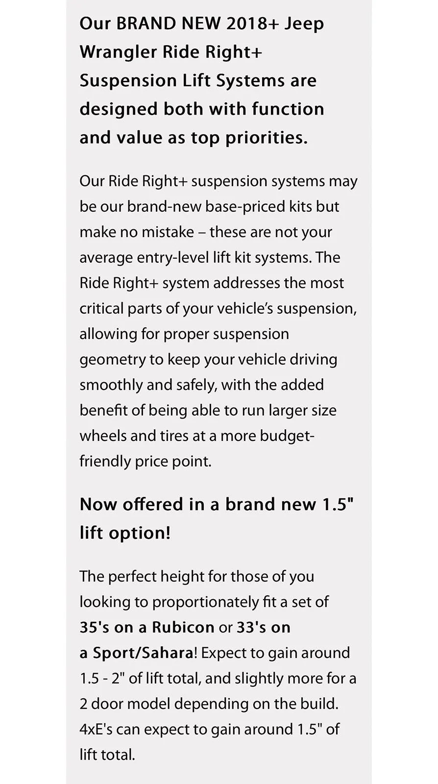

The Clayton Offroad Ride Right set up is exactly the kind of solution the OP is looking for.
https://www.claytonoffroad.com/product/jeep-wrangler-15-ride-right-lift-kit-2dr-2018-jl
That's all well and good, but has anyone actually checked to see what the spring rates are on these new right right systems? It seems to me based on their expected height increases that they're just packaging their existing springs with less parts to bring the cost down. If that's the case, I'd still be cautious of how stiff they ride on the road.
Something I figured out pretty quickly after having Teraflex, Metalcloak, and Rock Krawler springs is just how different all 3 ride based on their different philosophy's. Teraflex largely likes to keep their springs linear which is similar to stock, but the result here is a rate that's the same regardless of where your suspension is in it's stroke. In my experience, that was a pretty harsh initial jolt over bumps before the shocks could dampen the impact. Metalcloak being a dual rate helps minimize that initial jolt but leads to a lot more squishy roll in the meat of the spring that the shocks have to compensate for. Rock Krawler having a triple rate spring gives the planted feeling throughout the range to account for different stages of suspension movement. Something they figured out through their off road racing program. It's extremely satisfying to live with everyday because regardless of what I hit with the tires, the suspension just soaks it up and it doesn't feel harsh at any point. The Fox IFP's I paired with these springs really do work well to balance it all out.
Unless I'm mistaken, I'm fairly certain Clayton takes the same approach as Metalcloak but ups the spring rate to account for that extra squishy feeling which I've seen a couple times be reported as very firm/stiff as a result.

The next line is important: "*2-door Jeeps may receive slightly more lift than advertised due to differences in vehicle weight "
You’re correct and the OP started out by asking about shocks where this is a lift solution without addressing shocks. Threads go off track and I’m guilty of that here.
