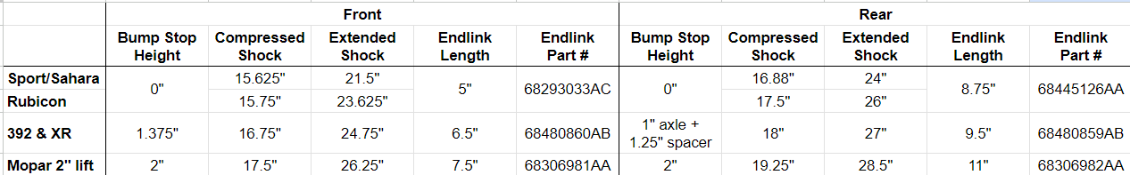

I wouldn't automatically add bump stops for no reason, just because it's included in a kit... I would take more bump travel. Some 35s won't rub when stock, and if they did only +1" is all that would ever be needed (assuming proper offset on a Rubicon). Or match the bump stop height to shock's compressed length as I did with the 392 shocks.
To me Synergy's front sway bar link relocation brackets are cheap (actually $85!?)... but aren't a good solution. They add potential failure points, have slightly worse geometry, and probably won't work for longer shocks. Especially when it's so easy to get a longer OEM endlink as a used takeoff for way less than $85, or even two new rear Mopar Lift endlinks and relocate the old rear ones to the front. Sidenote: I recently bought a full set of stainless XR endlinks on eBay for $45 shipped... MSRP is an unreal $1,079.
Jeep Wrangler JL Shock Question For the Experienced Guys... Screenshot 2024-03-12 210629
And finally, I would prioritize shocks above everything else in the budget... and spend it here. Ride height can be tweaked for cheap with spacers/shims (to a point... I say 1.5" max but many run 2"). Running spacers doesn't make a "spacer lift" either... spacer lifts have brackets so that the OEM shocks & endlinks can be used, in addition to spacing the springs for ride height gain. I don't see anything wrong with the factory rates as long as you don't need multi-rate for longer extension. In my opinion a good bump stop is better than a progressive/multi-rate spring, as it only adds rate right where you always need it: at full bump. A progressive spring might not be designed correctly for your load and end up too stiff or too soft, which would allow your suspension to crash into the harder/less progressive factory bump stops. This could all be mitigated with good adjustable shock tuning anyway (unless the spring stiffness restricts flex), which is why I say to prioritize the shock budget.

You can definitely change the shocks now without changing the ride height. Scroll through a few posts by @Trill in this thread. This will work on a Rubicon since the bump stops are the same, it will just have more bump travel. https://www.jlwranglerforums.com/forum/threads/the-2dr-sport-only-thread.15647/page-20#post-1040143
Products used are Fox's (Foxes?) 0-1.5" IFP shocks: https://accutuneoffroad.com/product/18-jeep-wrangler-jl-front-2-0-fox-shocks-ps-ifp-0-1-5-lift/ & https://accutuneoffroad.com/product/18-jeep-wrangler-jl-rear-2-0-fox-shocks-ps-ifp-0-1-5-lift/
Alternatively, the Fox 2-3" lift shocks seem to be perfectly sized for a +1" bump stop. This ends up with 1" less bump travel, which is livable but not ideal. The upside would be that no 35 would ever rub with OEM wheels (or something with similar offset).
