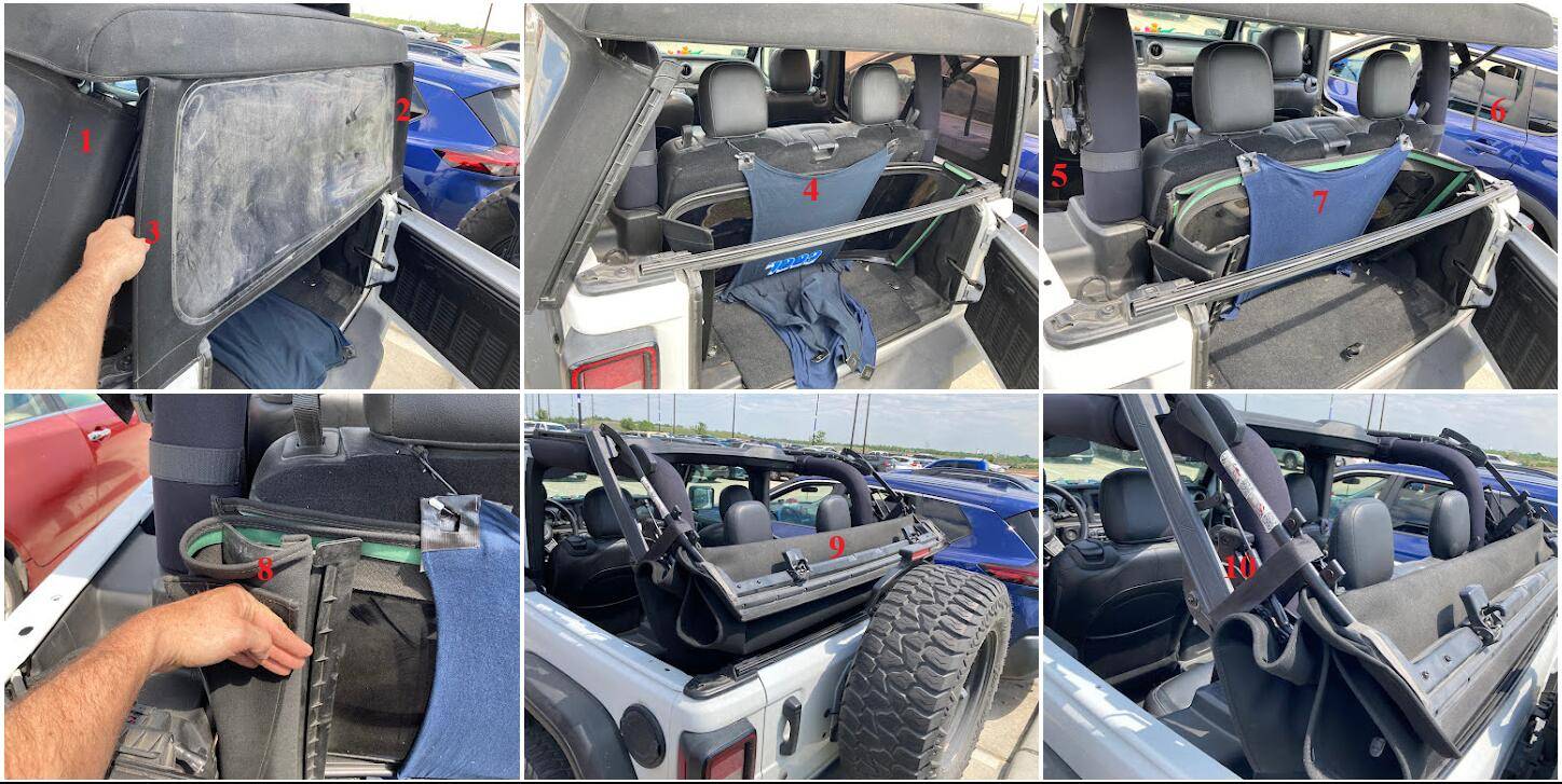

I plan on doing a writeup on my build and talk about this, but this was an issue for me that deterred me from soft top originally, but i ended up finding one on FB marketplace for $300 and couldn't pass it up, so it forced me to figure out a way to store my windows. this has been a game changer for me. i got it as a non professional looking setup using old tshirts, and some hooks i had lying around, but i wanted to prove it to work good before buying something that looks more legit.
I took these pics after getting everything all dusty on dirt roads, but it shows the process.
1. pop out the side window on the driver side, 2. undo back window on passenger side, 3. slide out rear window. 4. put rear window in upside down and hook first tshirt to back seat. 5 remove driver window and put in upside down and hook next tshirt to back seat. 6 remove passenger window and hook next tshirt to back seat. 7. now all windows are strapped to back seat within a couple minutes and the tshrits support them from folding and drooping down. 8. to drop top, i have to hold the corners in against the backseat so top will go all the way down, 9. lock the top in the down position, 10, i got some velcro that i attach to keep top secure in down postion.
now i keep windows protected, i still got my backseat, and it doesnt really take any room in the truck, i put my tool bag and some other small stuff back there still.
