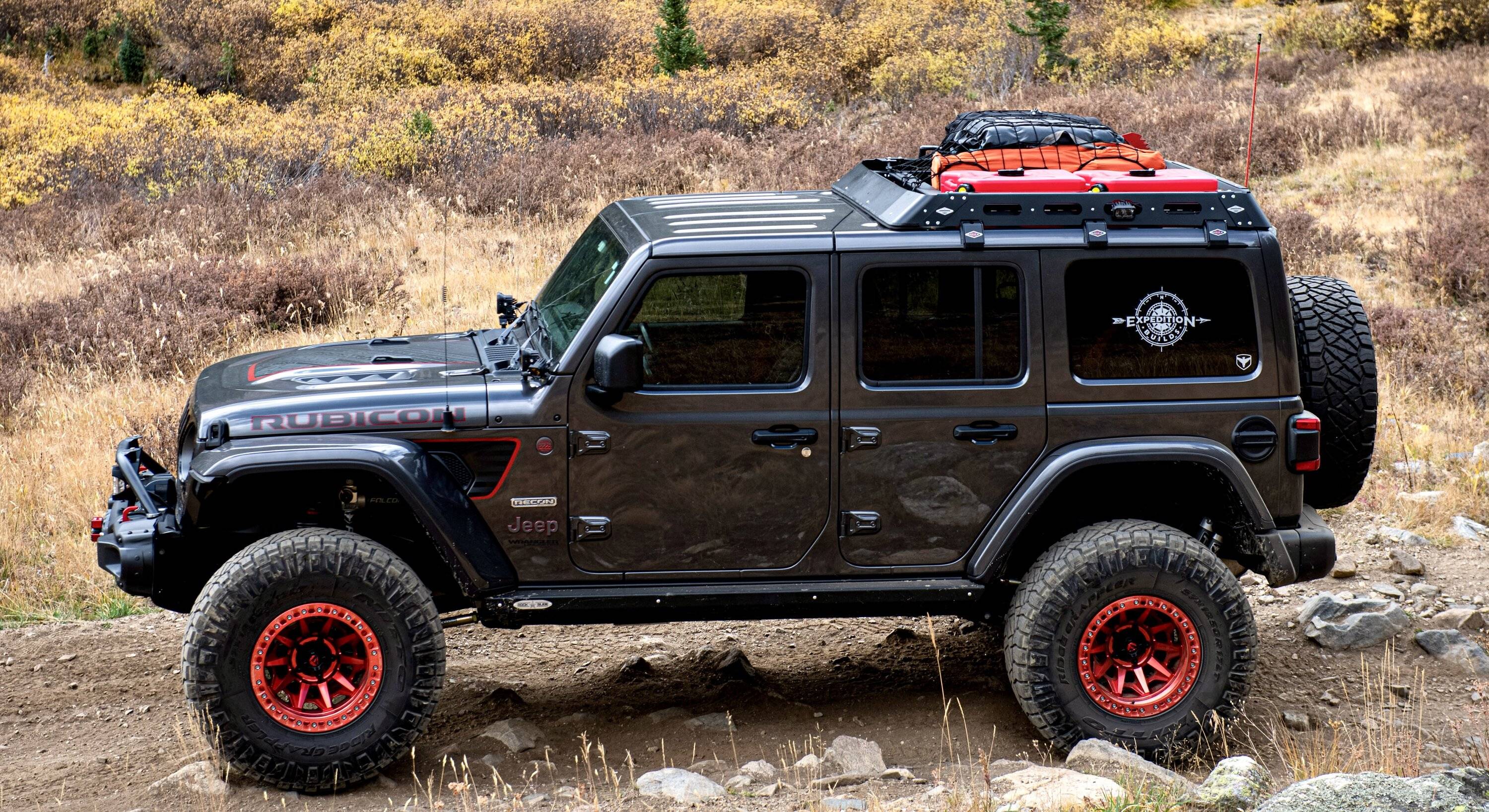

One of my favorite builds on here! If I ever get a driveway, higher garage opening, or street parking I am getting that Expedition one rack.
This rig needs to be able to:
- Cruise the interstate at 85mph all day long, with my wife being comfortable behind the wheel.
Is this still true? ?
Thanks kubicon, appreciate that!
Yup, it's still true. She's built to cruise the interstate at 85mph, with my wife comfortable behind the wheel.
With gas prices where they are, I try not to push the brick through the wind that fast very often ;)

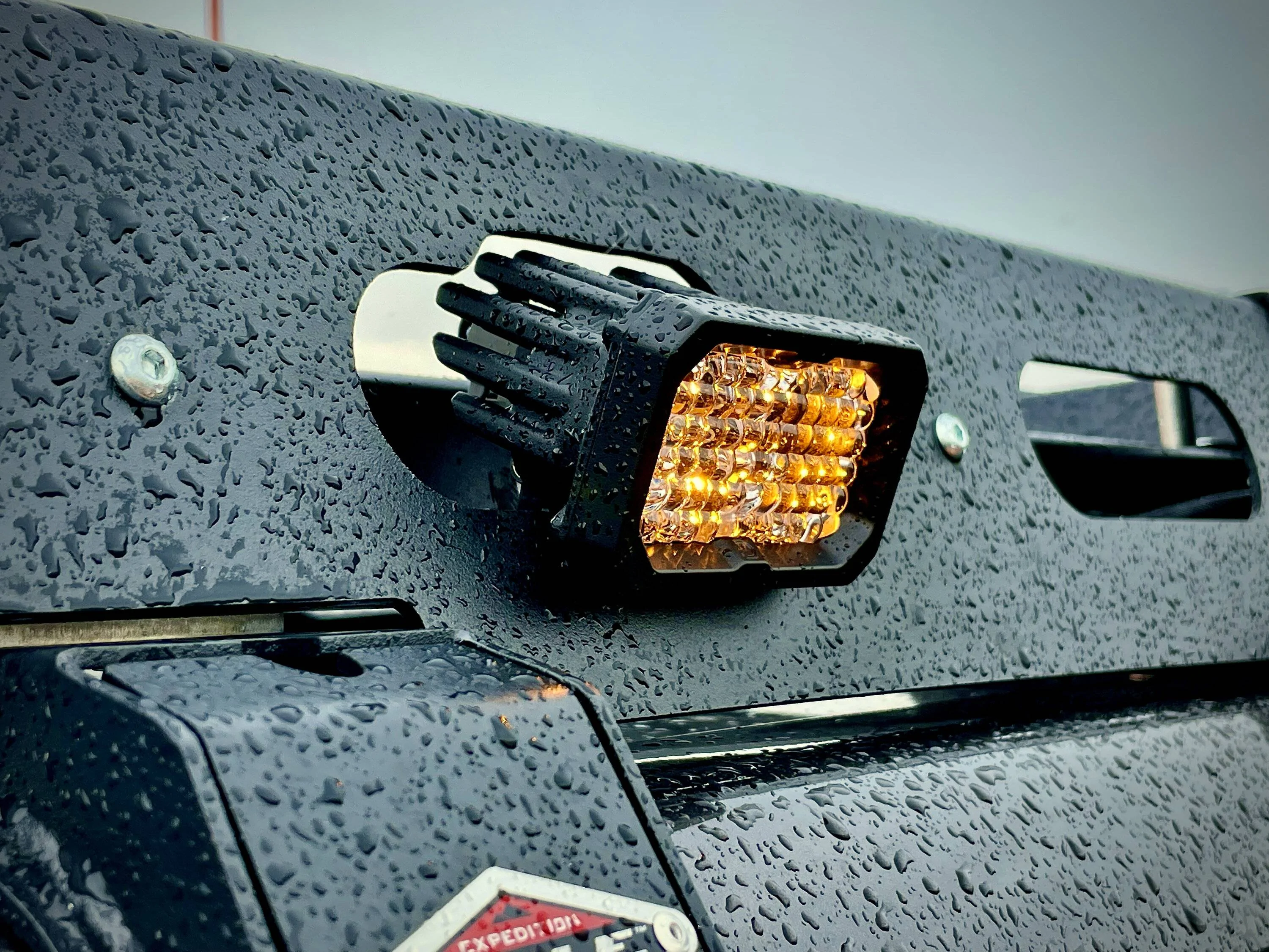

On the topic of my Expedition One roof rack, I need to mention the build quality on it.
The finish still looks like I just installed it even after a couple of salty Chicago winters and a lot of use. I can't say that about every aftermarket manufacturers finish I've used on my Jeeps. Expedition One got it right??

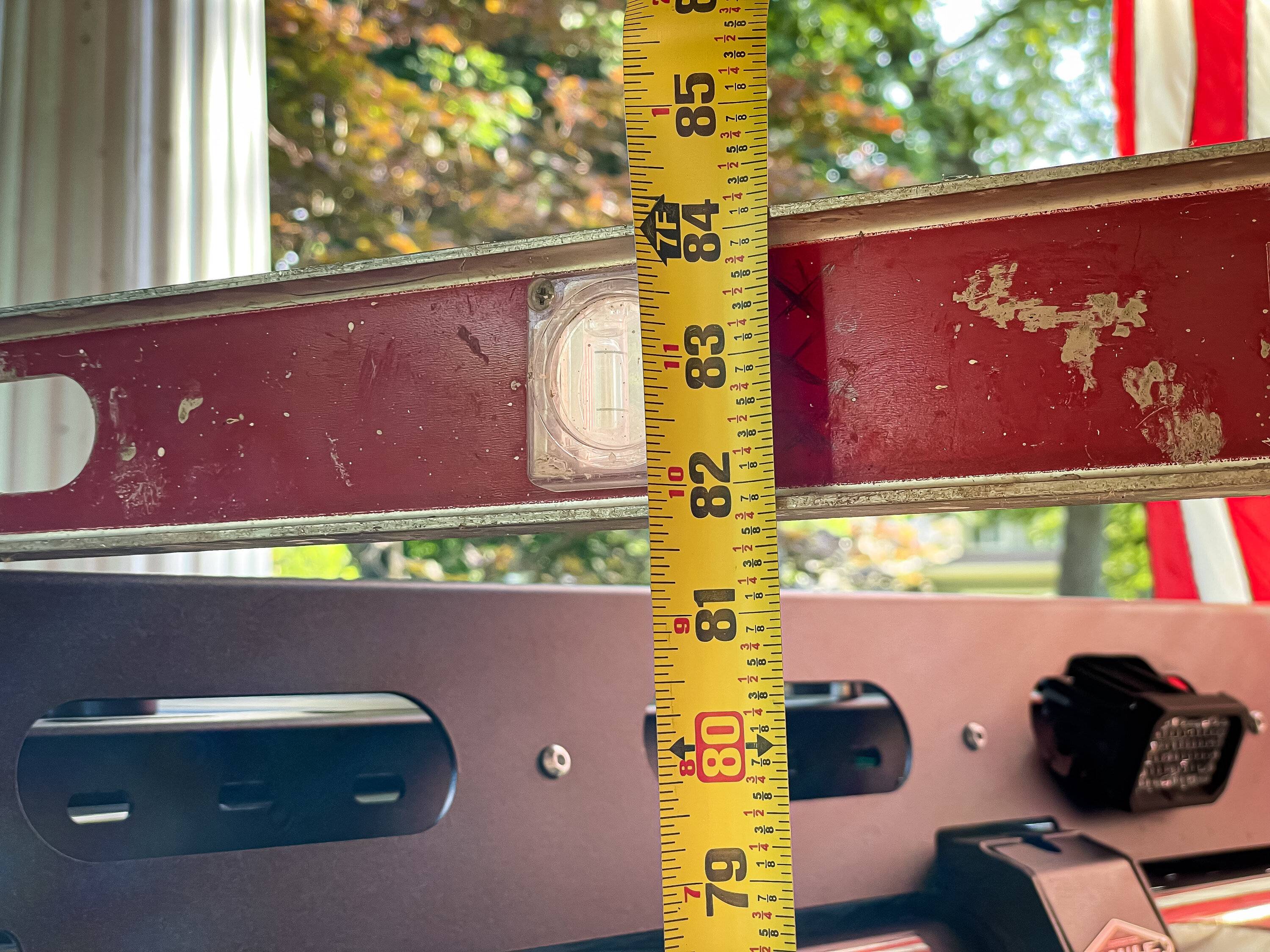

What do you measure with the Rack ground to top?

When I get home, I'll measure the rack height for you.

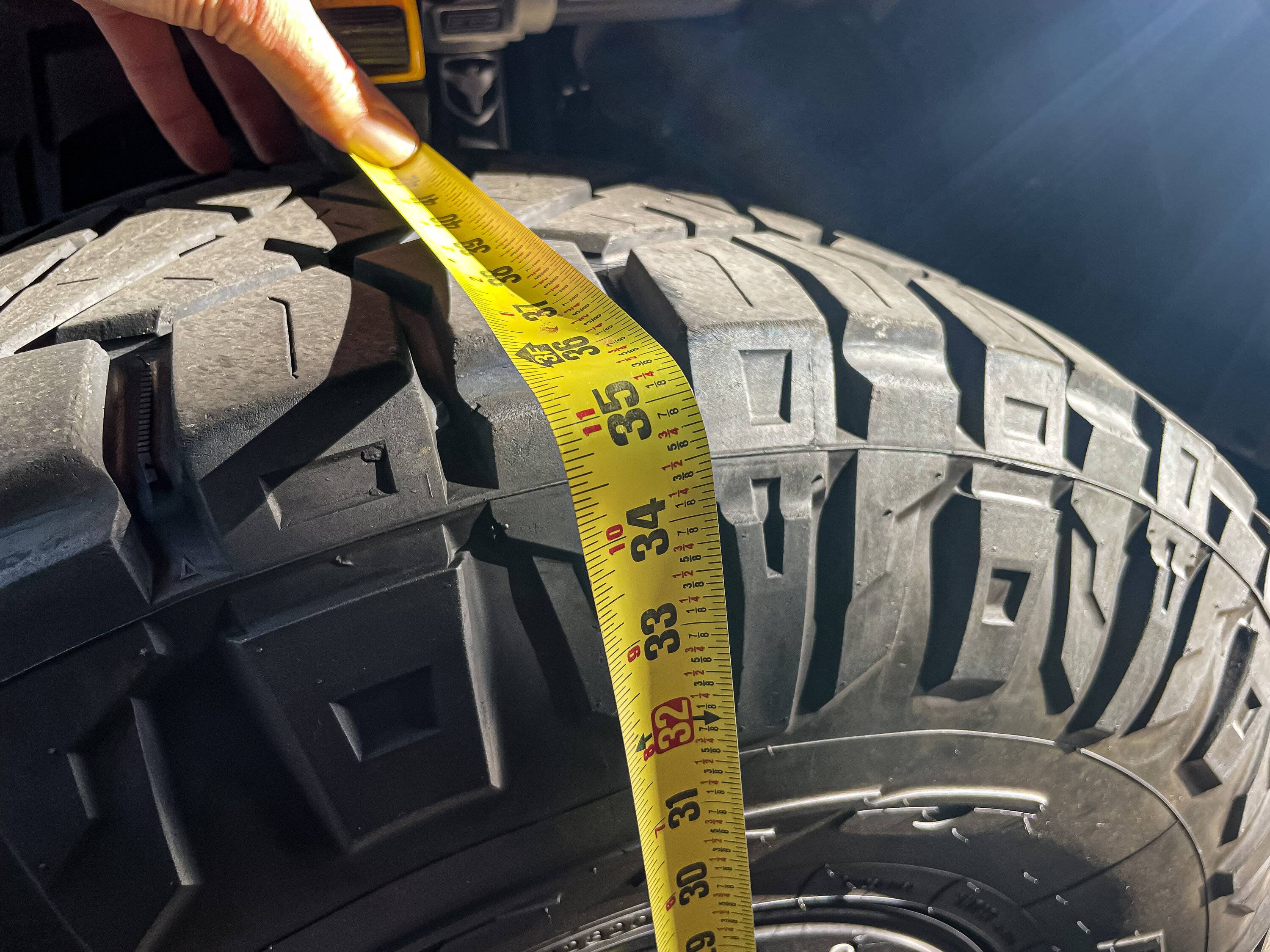

I went to the 38 Nittos, and I think they are 36.75 (30lbs PSI), will doublecheck when I get home
We felt a noticeable difference in lack of power from 37 KM3's to the 38 Nittos, are yours measuring 36 ish?

My mistake, I thought you were on the KM3's. I'll measure both the tire size and rack height when I get home. I'll get back to you today.

Wouldn’t the measurement for roof rack be 81-3/4” or am I missing something ?
I’m a little confused on that one also ?‍♂

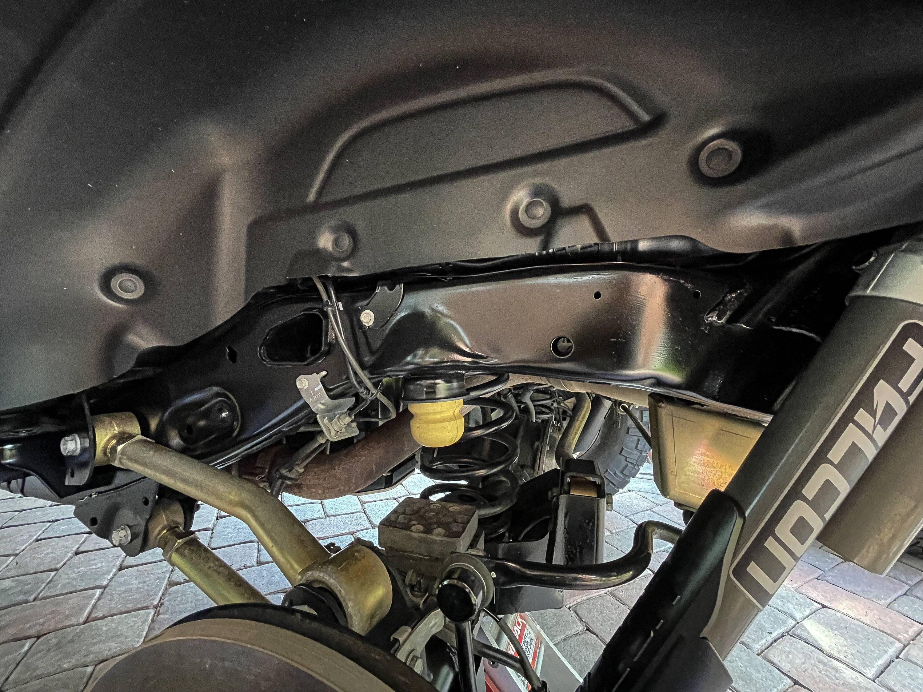

I finally got around to getting some paint on the rear frame rails. I said it before, I really don't like the paint Jeep is using to coat their frames...it's thin, open and is allowing rust. We see some salty winters here living in the Midwest.
I previously did this with the front frame rails and spring perches.
Jeep Wrangler JL Rubi Recon IMG_5623
Here's some before and after pics. After washing everything off, I wiped the frame down with lacquer thinner, did a quick masking off and applied a several coats of Rustoleum Black semi-gloss spray paint.
Jeep Wrangler JL Rubi Recon IMG_6125
Jeep Wrangler JL Rubi Recon IMG_6126
So much better now!
