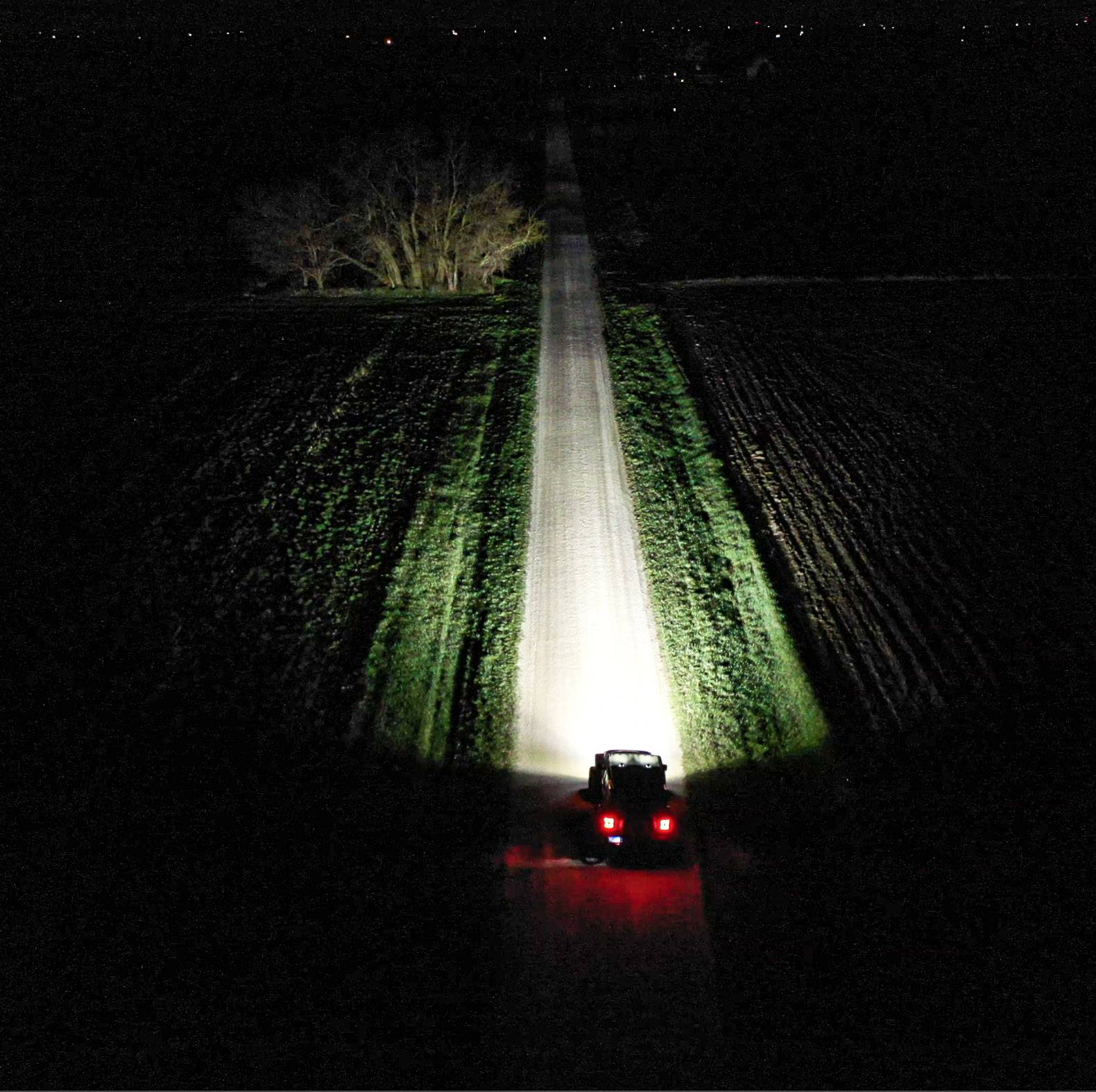

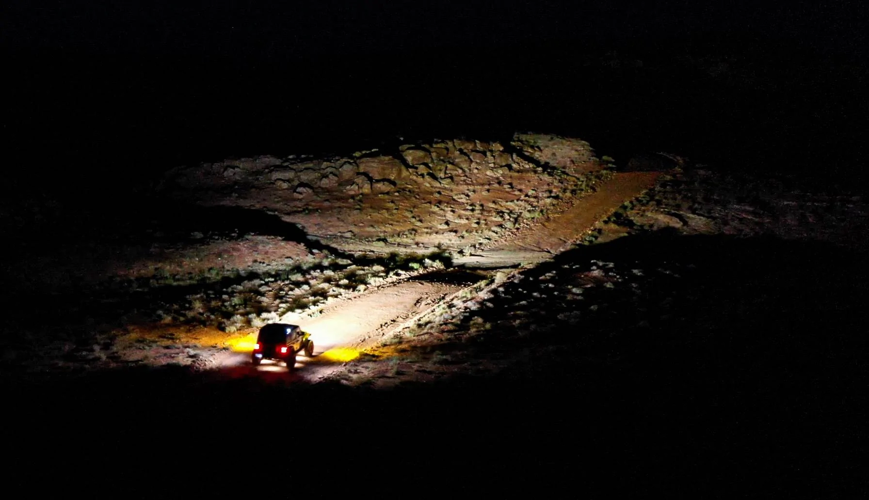

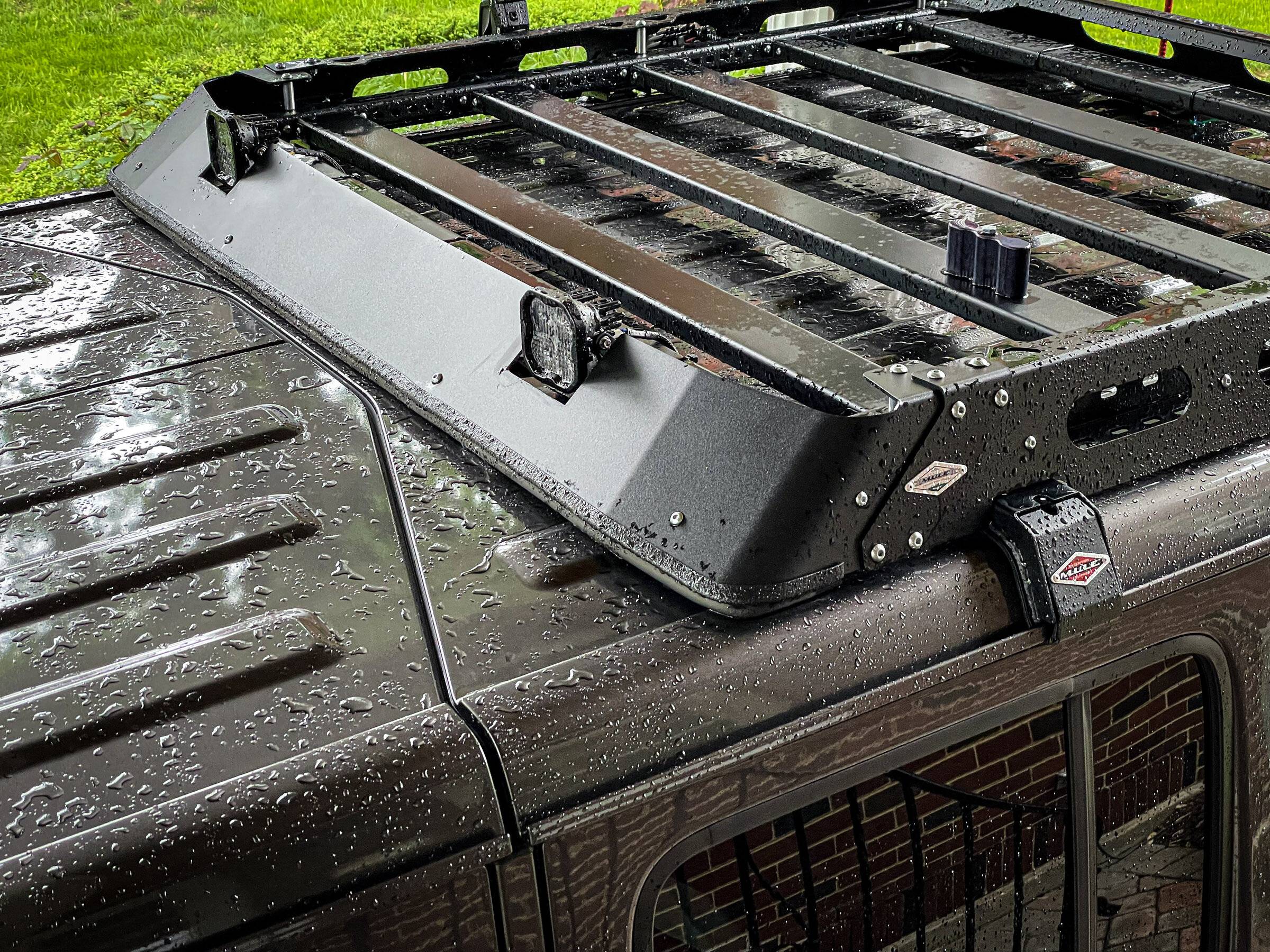

Here's a shot from above showing the Diode Dynamics SS3 Max Pods in action.
Jeep Wrangler JL Rubi Recon Diode Dynamics Roof Rack Lights

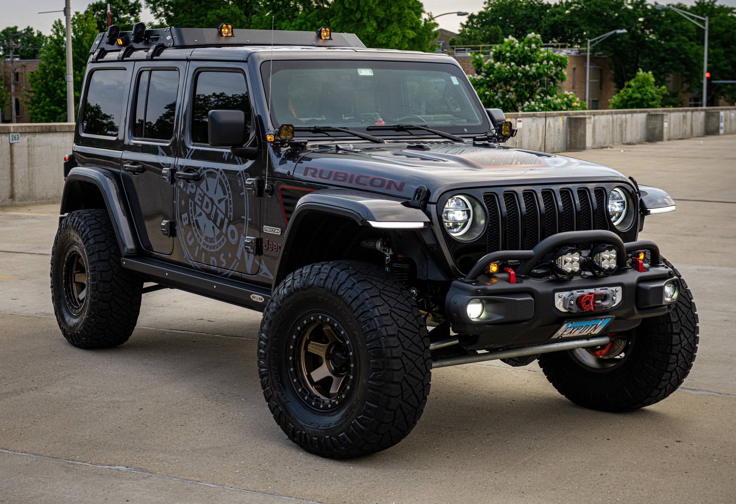

I have these mounted up on the front of my Expedition One Mule Rack.
Jeep Wrangler JL Rubi Recon IMG_5954

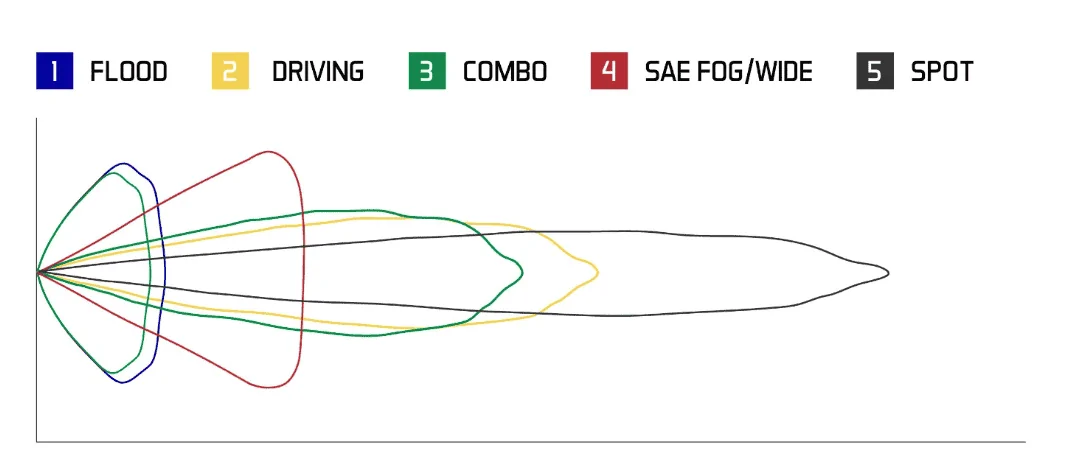

The Max with Combo Lens produces 46,000 cd. The Combo lens combines both Driving and Flood optics with a focused 65x25 degree pattern. My thinking here was that I will use on the last long stretches of trail we run in Moab coming after dark. Having them mounted up allows great coverage.
Here's a quick guide of the different beam patterns for reference.

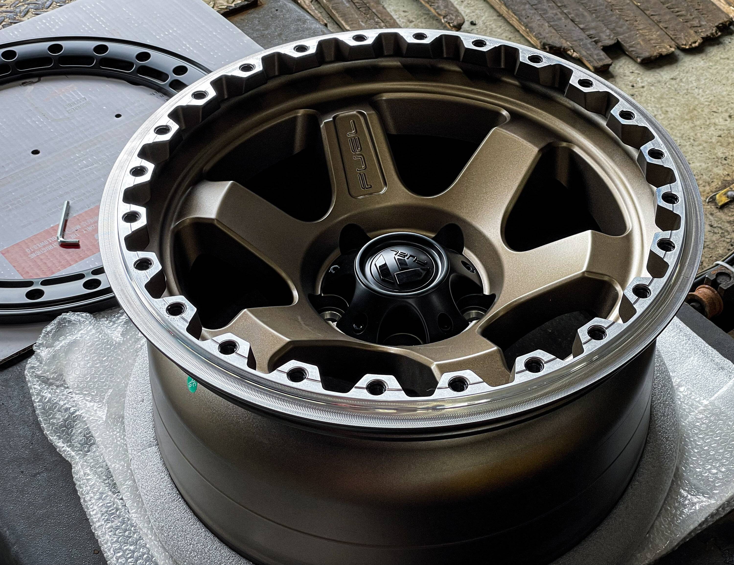

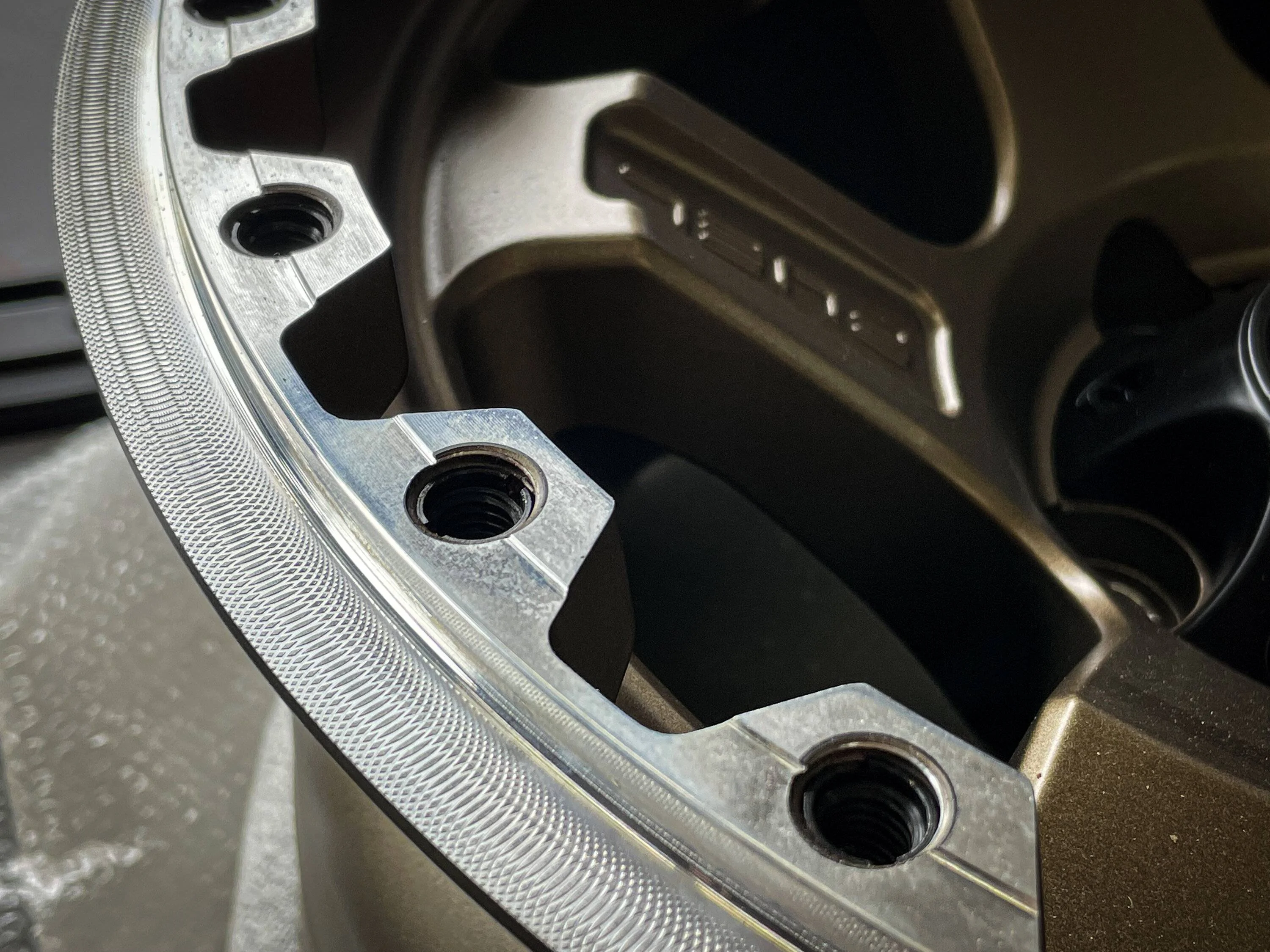

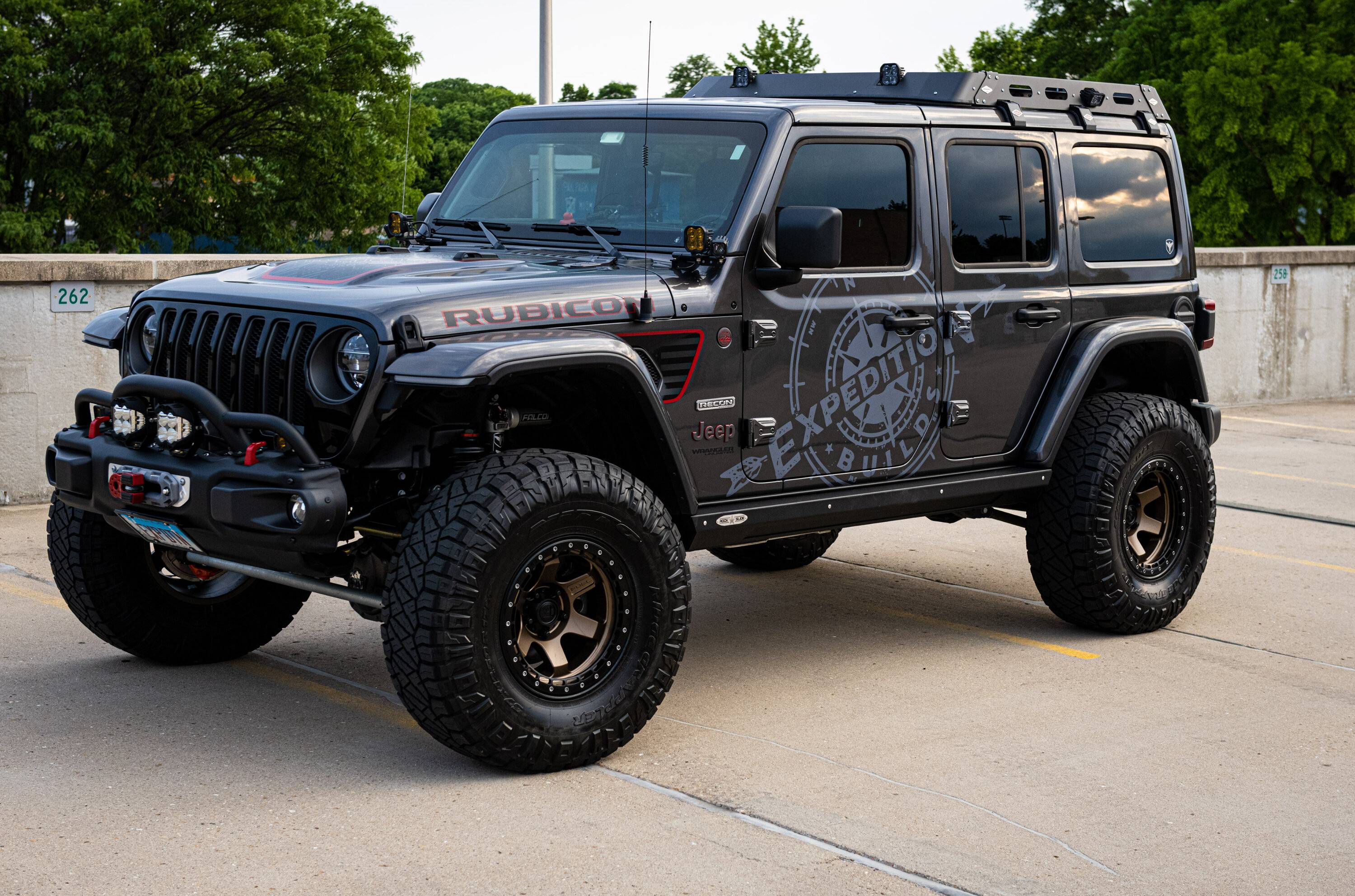

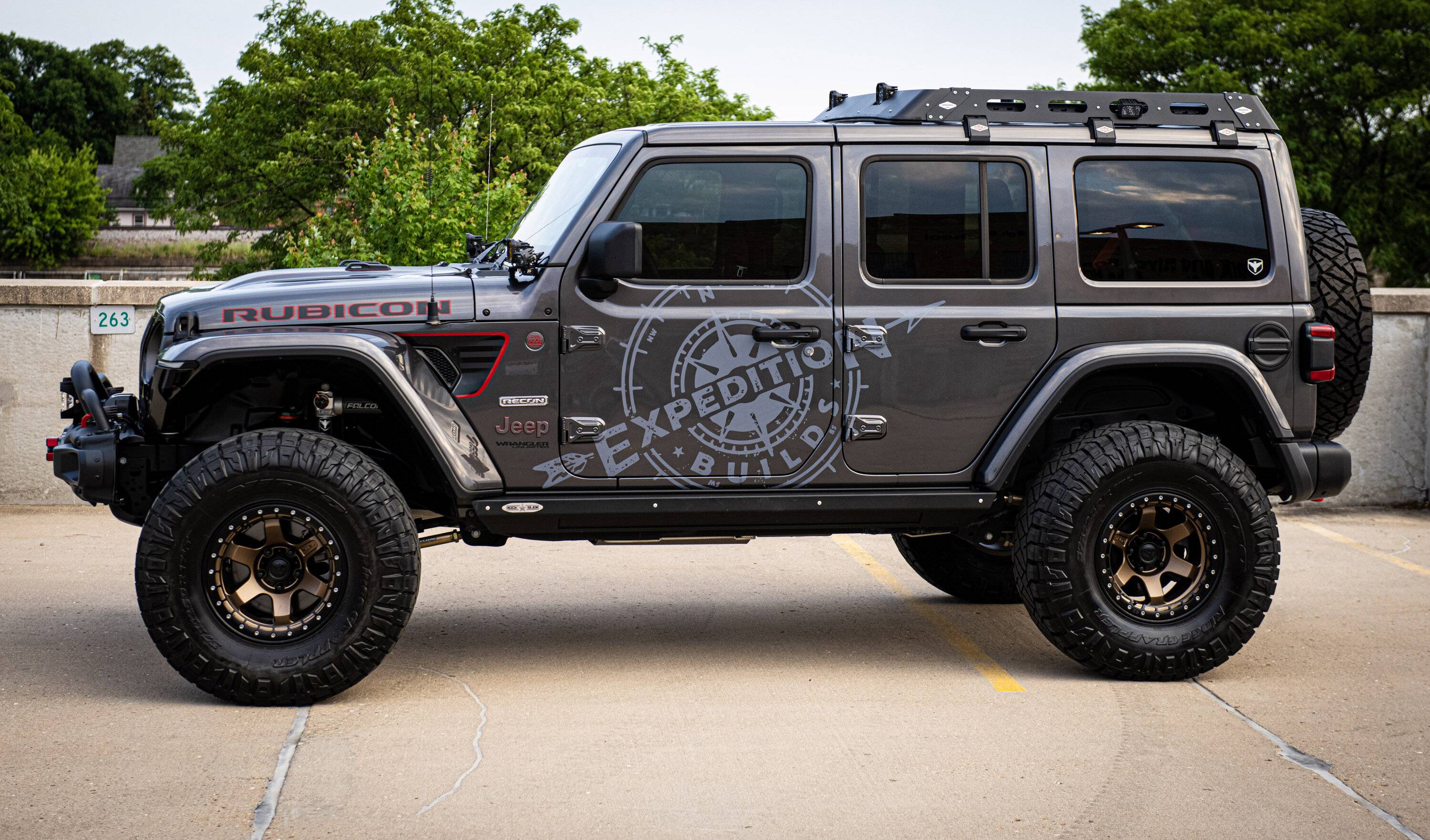

I figured I'd post the specs on the new wheels as it might be helpful for anyone looking at new wheels.
Here's the specs:
- Fuel Off-Road, Block Beadlock D124.
- Offset -15mm, 4.41" B.S.
- 17x9
Jeep Wrangler JL Rubi Recon IMG_5999
I ran a 3.5"/-32mm Offset on my first set of wheels for my JL buld, which was pretty aggressive offset with the new wider axles on the JL Rubicon. I think this 4.41"/-15mm is a better all around fit, bringing the wheel in ~ 1" from my previous setup. I still have plenty of offset so the tires/wheels will keep the body off the obstacles on the trail, which was important to me.
