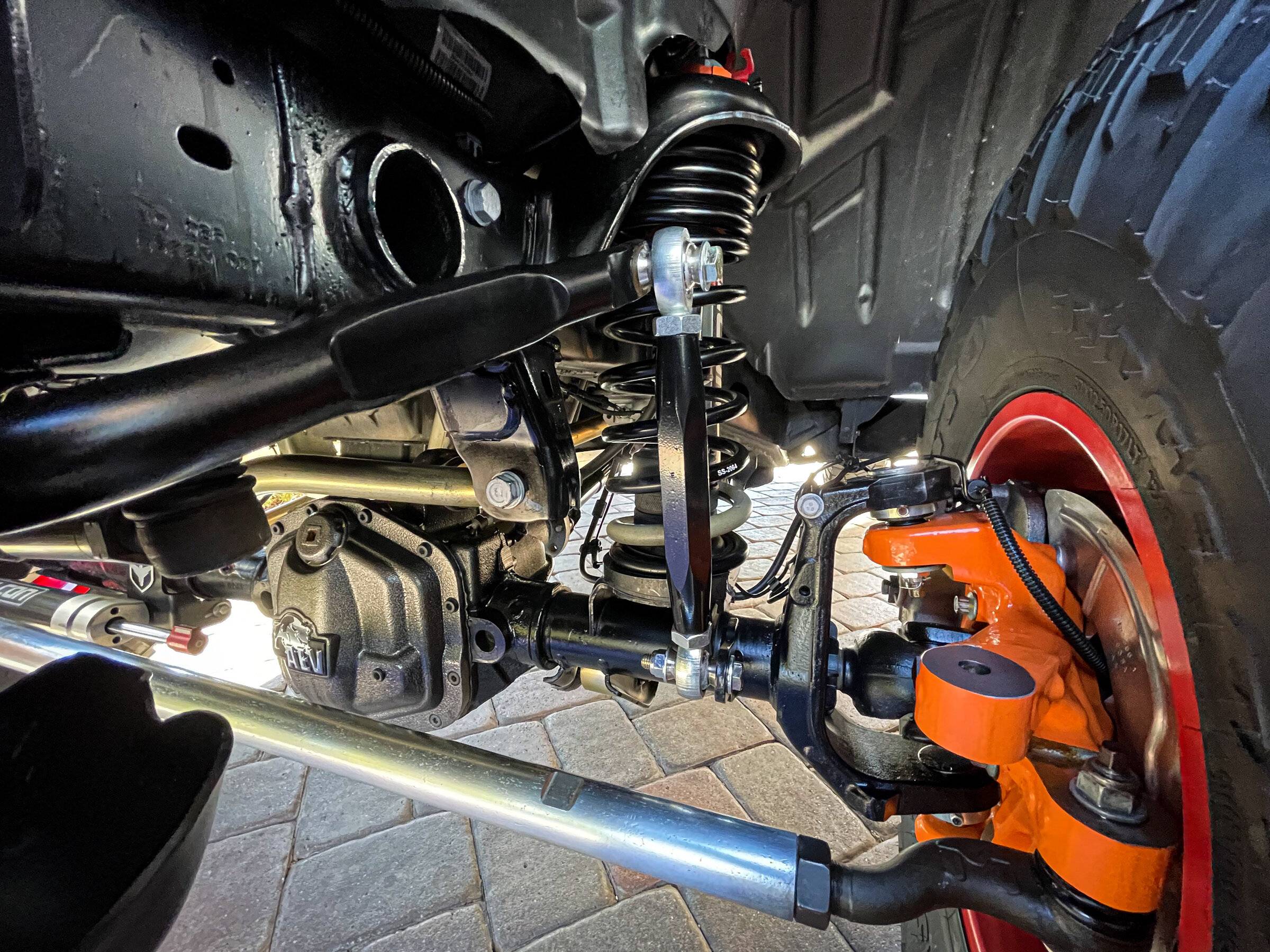

RK No Limit Sway Bar Links installed...
Really looking forward to getting these on the trail soon. On street observation(s), you'll feel a little more of the road as these are virtually a solid link (no NVH dampening). I may choose the switch back to the TeraFlex links I was running for a more comfortable on road drive when I'm not wheeling. Steering might be a tad quicker/more direct with the RK links.

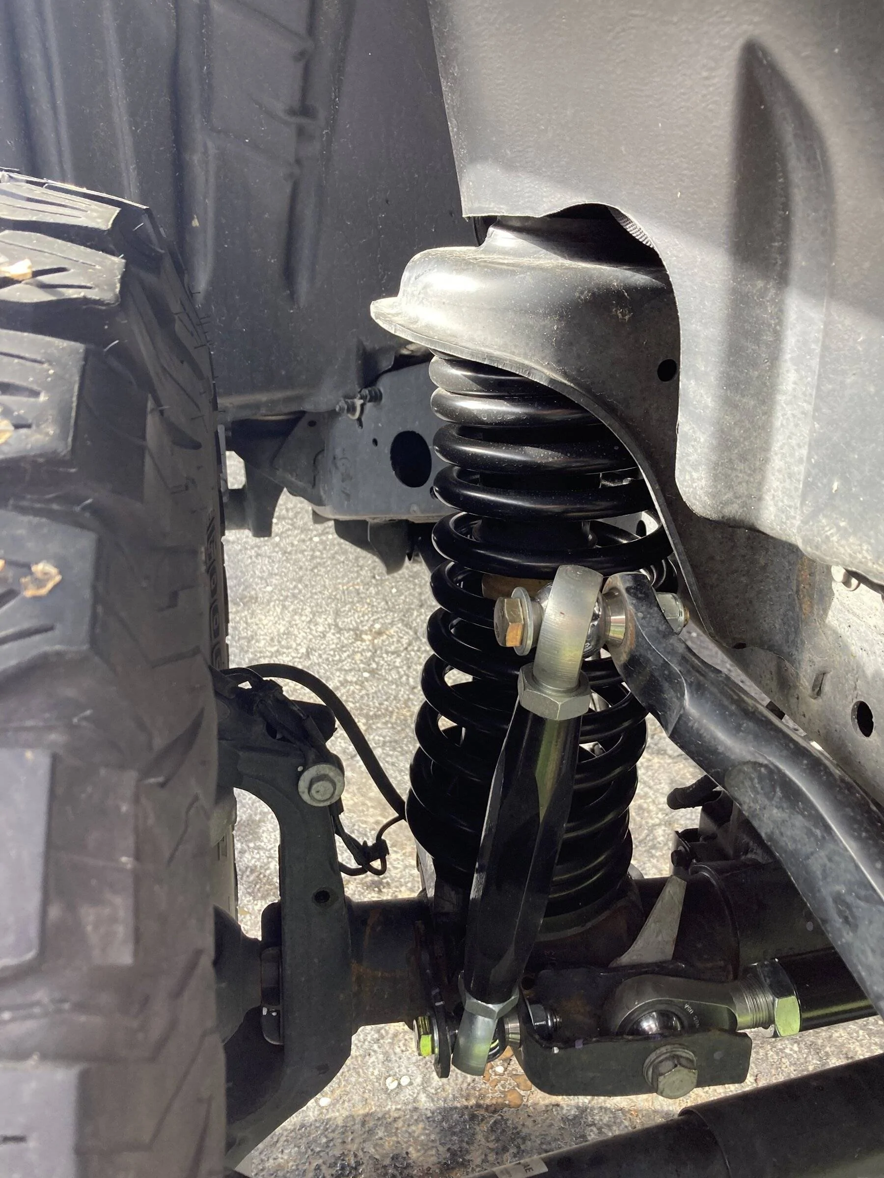

was Looking for a post like this. I had a jeep shop install a rock krawler lift for me yesterday, and I have the no limits links. I was looking underneath after our monsoon rains stopped, and noticed one of links looks crooked. The driver’s side is straight like yours. Is this normal? Do they move around? Thanks in advance for helping a lift noob.

Hi Brad, great hearing from you! Yes, that joint they are using (Heim) will find its own orientation while running on the street. Once flexed, it will then come straight again.
We're making our way to EJS now and as I was looking things over on the Jeep while gassing up I noticed mine flopped as well. It doesn't look great, but it's not a problem at all. Looking forward to getting these on the trail soon?.

Thanks for the reply. Great looking Jeep by the way. Safe travels.

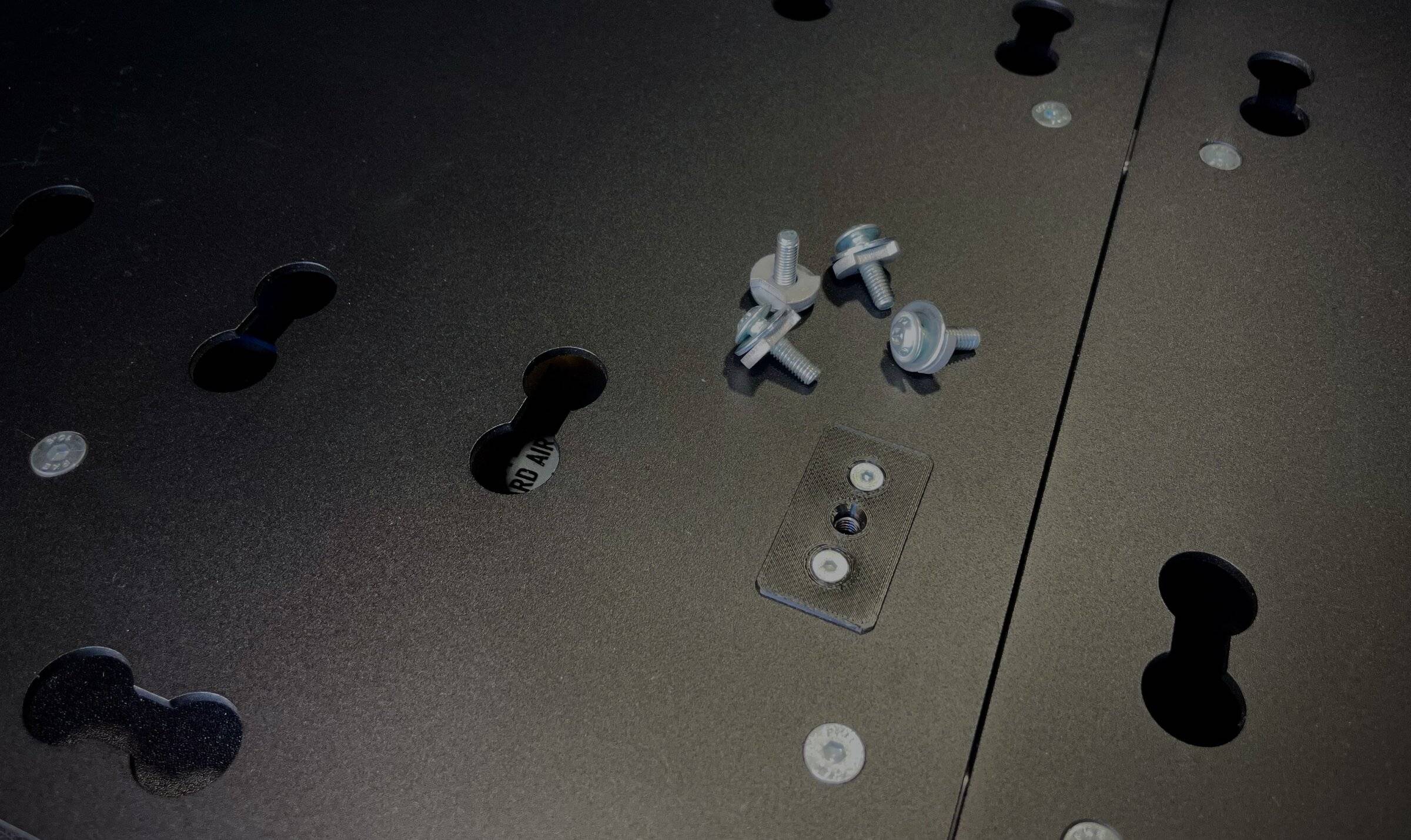

Getting ready for EJS means getting Rubi loaded with gear. When we're not out exploring, I keep my cargo area open (no Fridge Slider) making it easier to carry things.
Jeep Wrangler JL Rubi Recon Cargo Liner
I carry a RTIC cooler on the Adventure Labs Fridge Slider when we head out on road trips, trail running. Installing the Fridge Slider back into the Jeep takes only minutes, simply attaching the four bolts that hold the Slider to the AAL Platform. I really appreciate the versatility the AAL system provides.
In 5 min. the Jeep is ready for the cooler...
