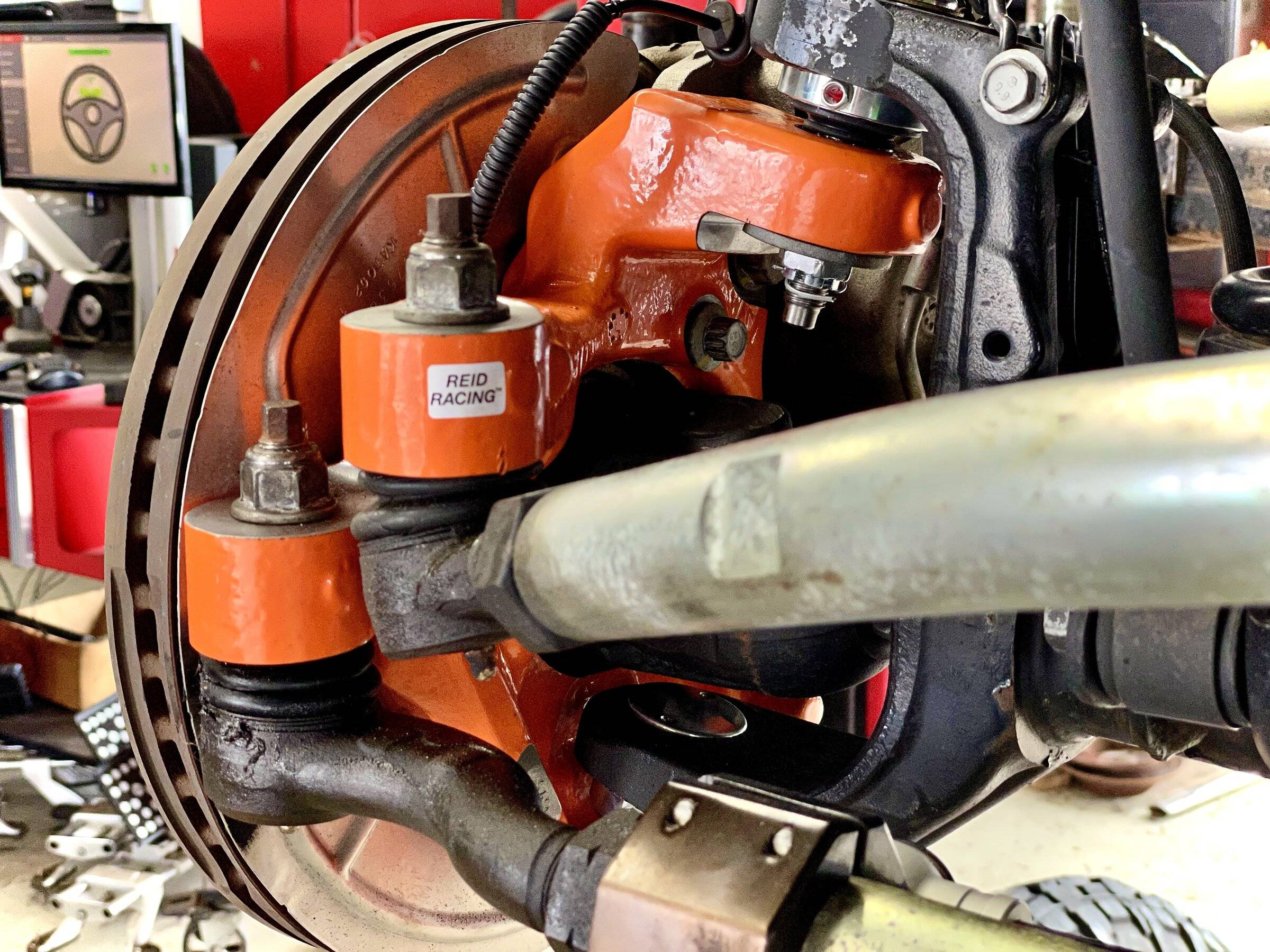

I just unboxed the new front end upgrades going on Rubi this week. The Reid Racing knuckles kinda blew my mind with the quality and weight of them...they look like they should be bulletproof.
Jeep Wrangler JL Rubi Recon IMG_5484

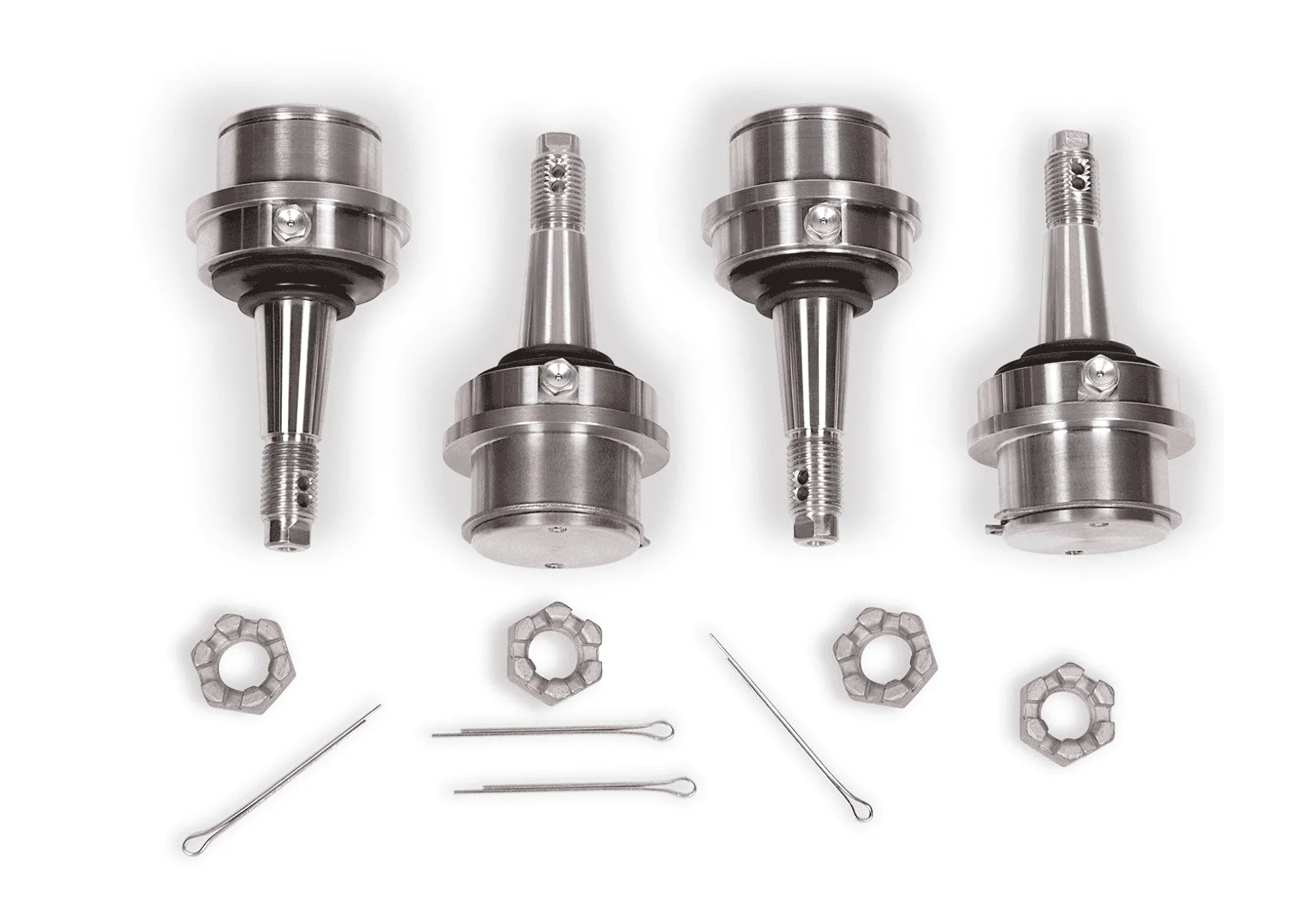

Dynatrac HD Ball Joints
Jeep Wrangler JL Rubi Recon IMG_5483

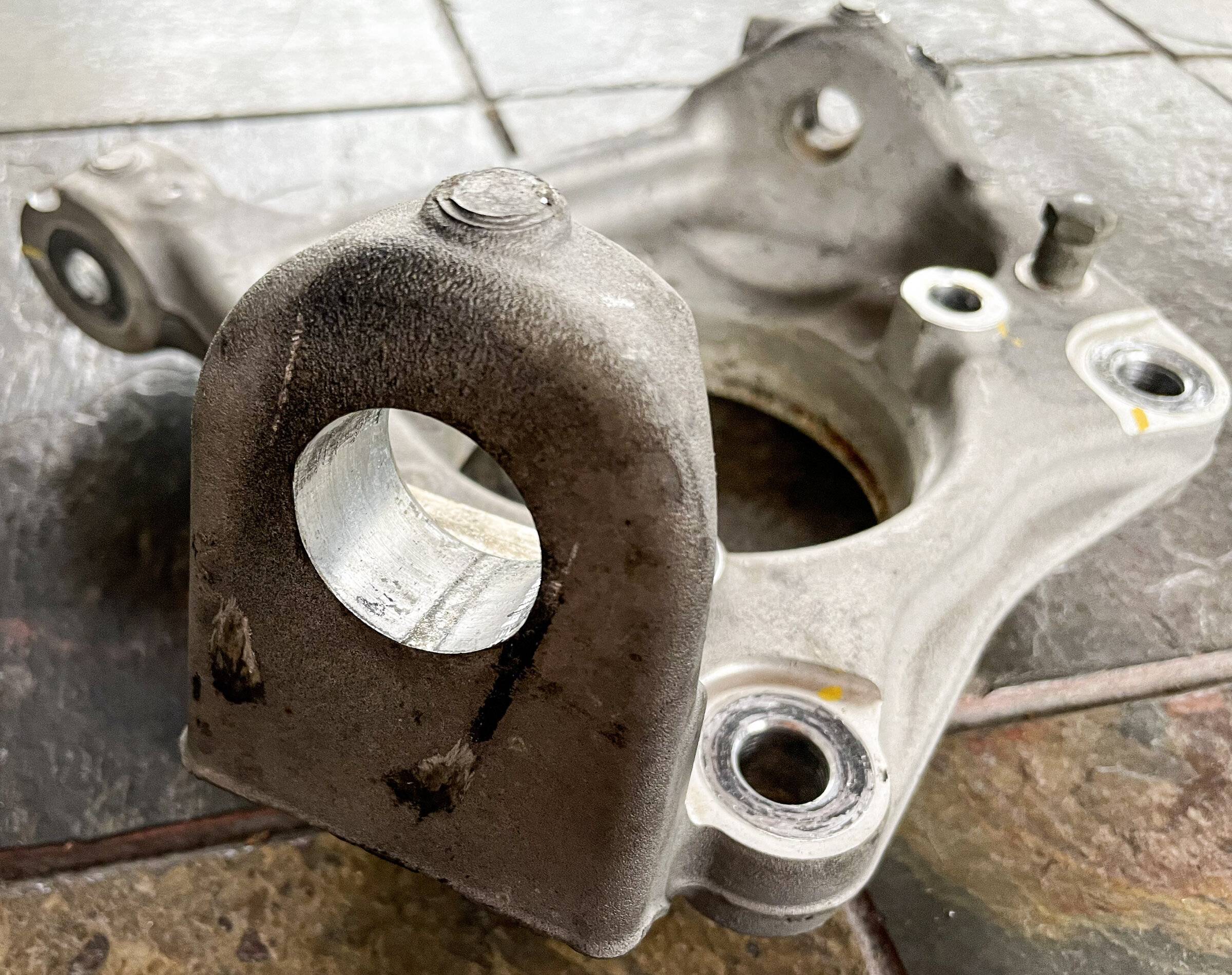

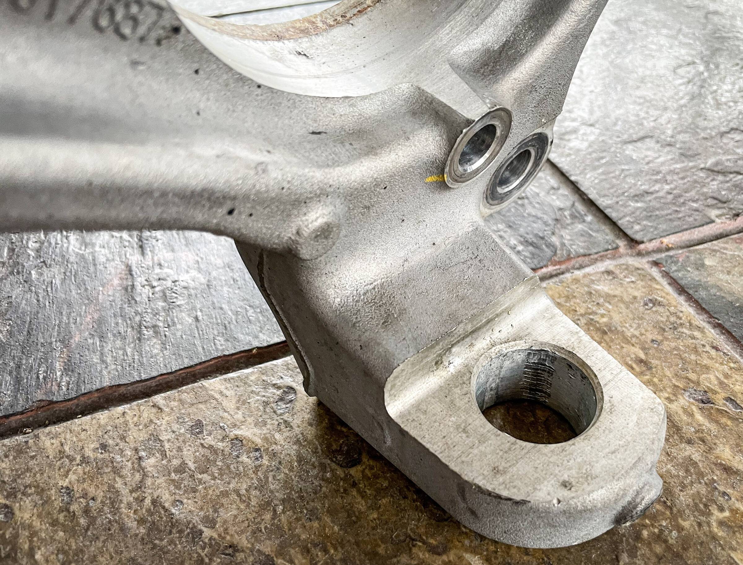

Here's a look at the the stock knuckle as they came off the Jeep. The ball joint contact areas looked pretty good, no visible signs of loosening. The stock ball joints were still very tightly seated in the aluminum knuckles.
Jeep Wrangler JL Rubi Recon IMG_5577
Jeep Wrangler JL Rubi Recon IMG_5578

The Reid Knuckles are really on Rubi for strength and longevity. Taking @Roky advice, we had it torn down and changing the knuckles was pretty easy at that point. Being able to grease the Dynatrac ball joints leads to believe they will perform well and take the abuse of off roading and running the 37's and larger offset of my wheels.
Jeep Wrangler JL Rubi Recon Dynatrac HD Ball Joints

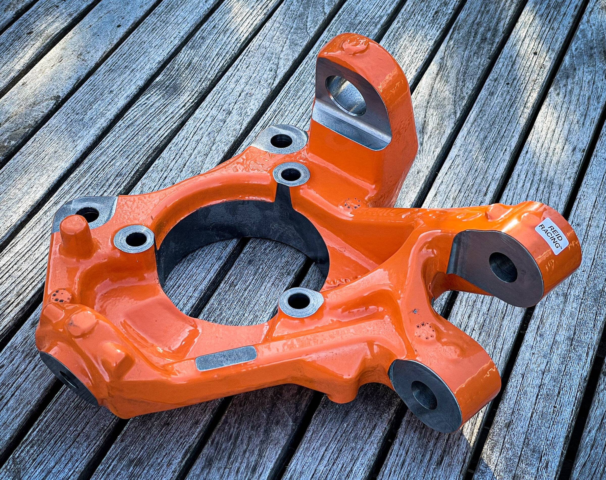

Finally, here's a look at the new front end.
Jeep Wrangler JL Rubi Recon _DSC3570
