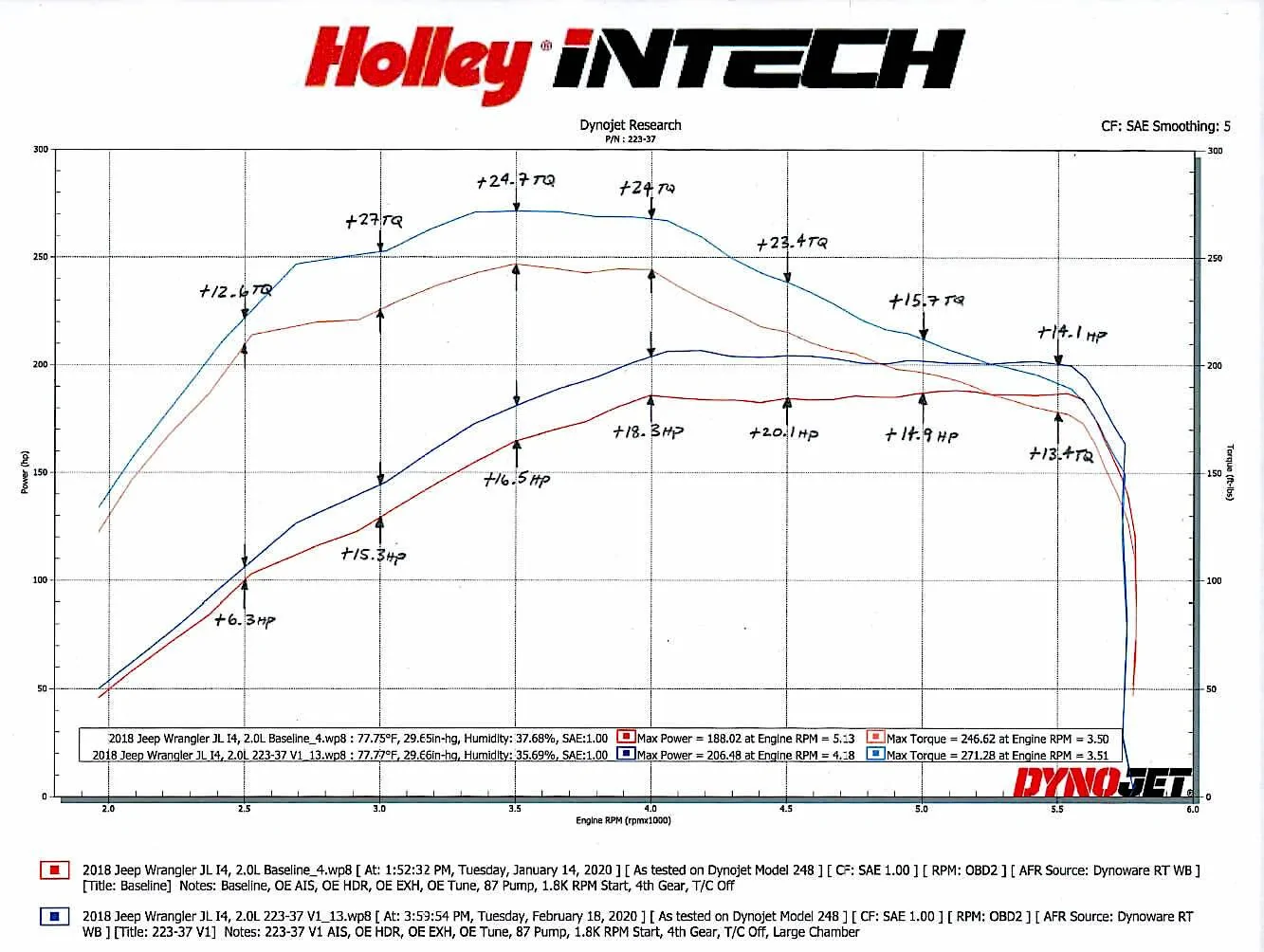

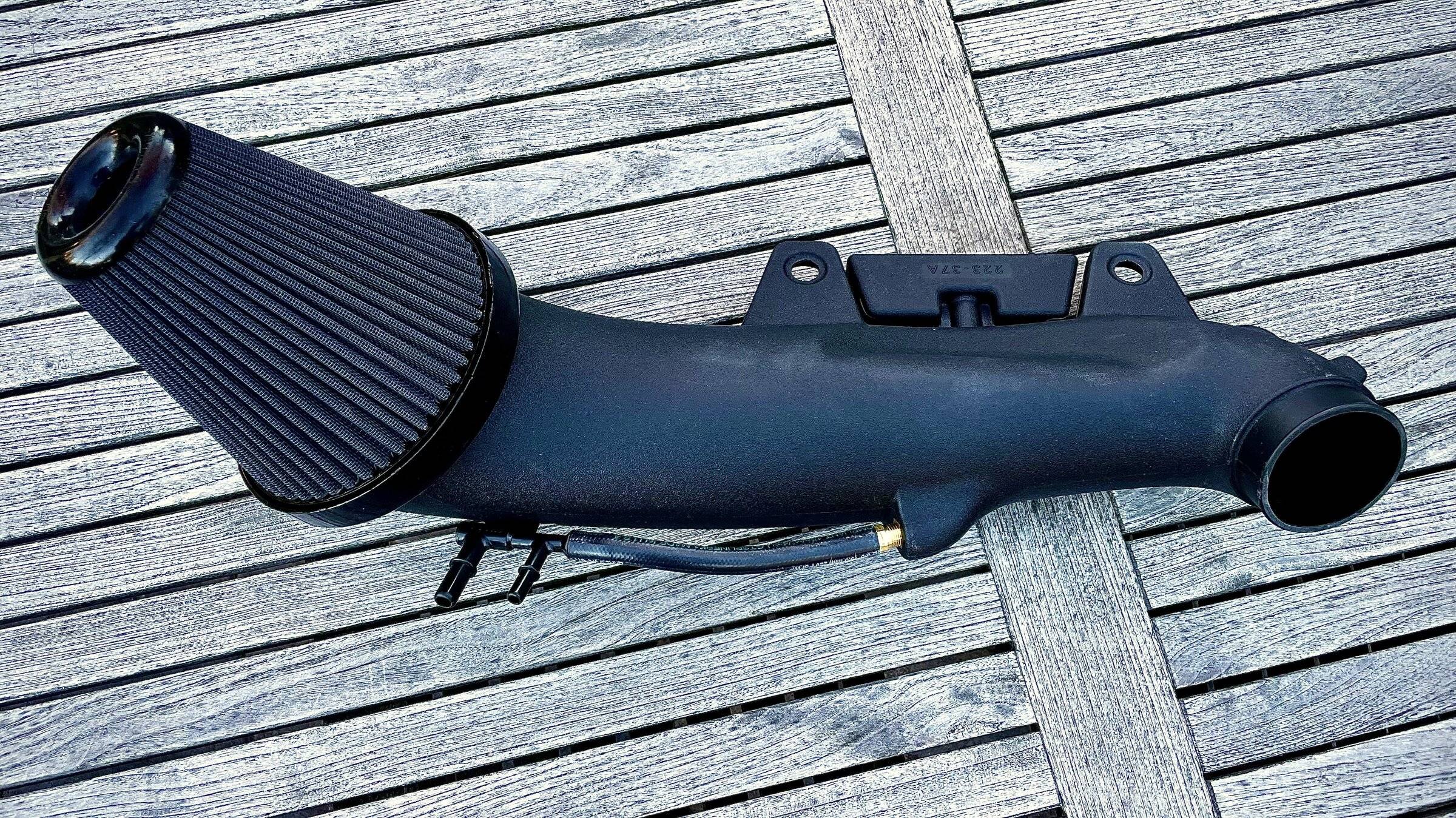

So, here's the first performance mod, Holley's Intech Cold Air Intake. I settled on the Intech Intake for a couple of reasons. First, it utilizes the factory air intake location. This was important to me because I know the engineers at Jeep spend some time working the details that allow for maximum water fording. Secondly, I liked that Holley posted the dyno chart on the performance of this intake, so I felt this could yield some tangible performance benefits.

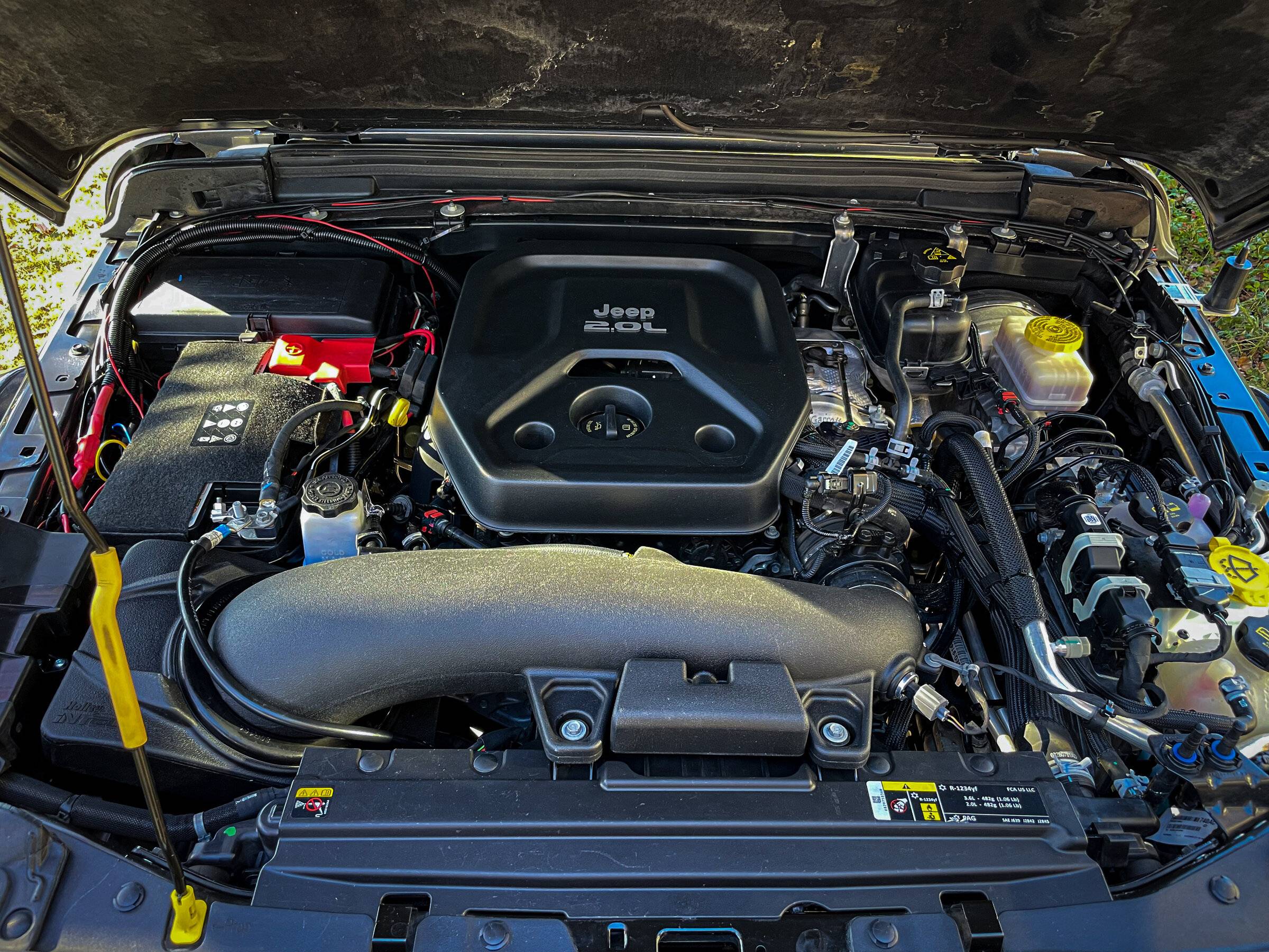

Here's the intake installed...
Jeep Wrangler JL Rubi Recon IMG_5147 2
True to Holley's statement, it takes a few miles for the ECM to learn the new set-up. After driving about 30mi. or so, I could really feel the difference in power delivery on my Jeep. What's really great about this intake design is it's making power lower in the rpm range.
