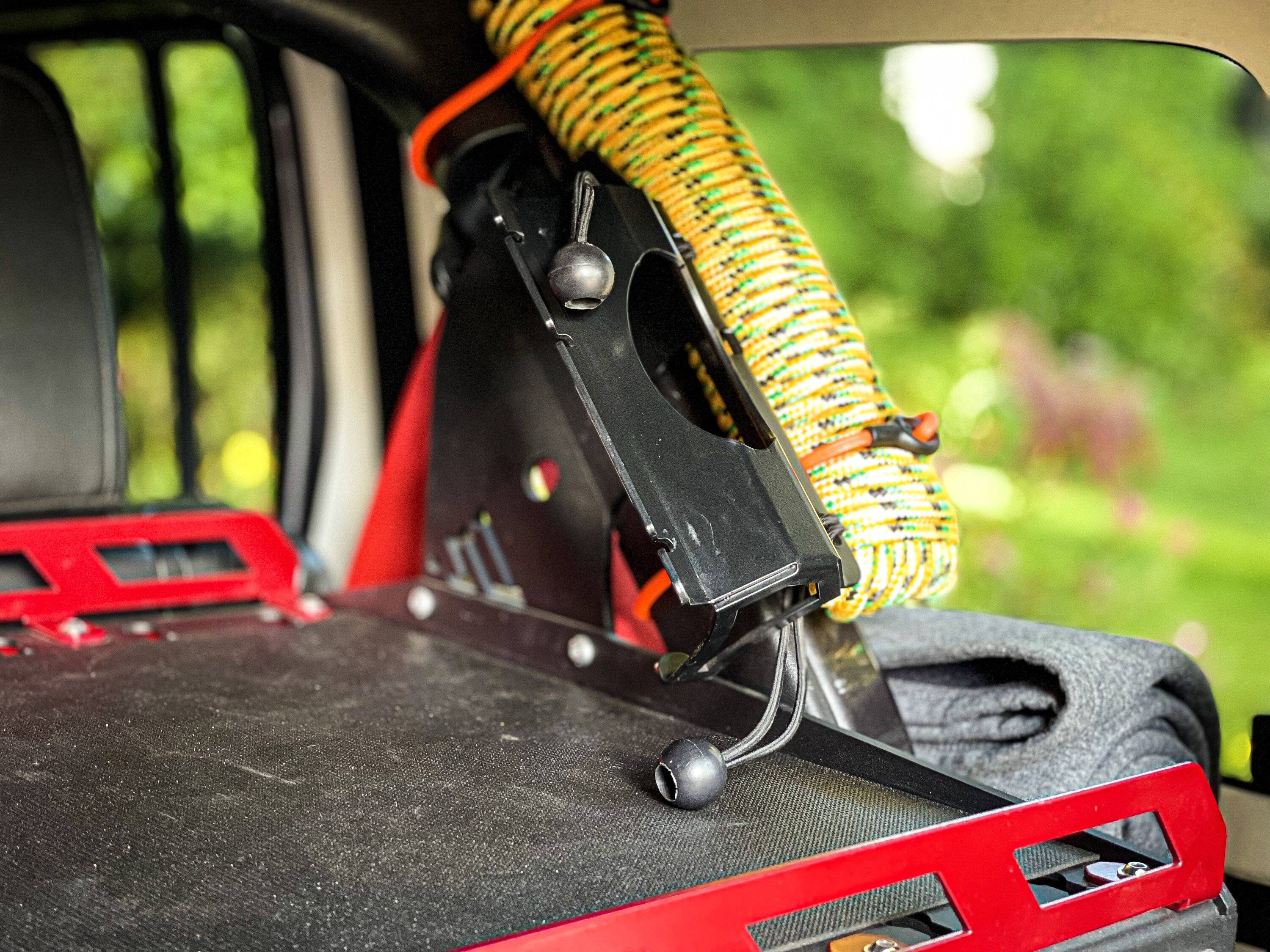

Hi Jason,
Here's a couple of pics I promised.
Jeep Wrangler JL Rubi Recon IMG_6420
Jeep Wrangler JL Rubi Recon IMG_6419
As you can see, I simply flipped the M.O.R.E. bracket to make it work with the AAL MASS Shelf. The elastic bands hold in place securely and you can still remove the fire extinguisher in seconds. Hit me up with any questions you may have.

You are correct, the F.E. bracket will not clear the shelf at the height I'm running mine, hence the inverted mounting.
I am running my MASS Shelf at the highest mounting point which allows my cooler/slide to fit. If the shelf is mounted in a lower configuration, you might be able to use the F.E. bracket right side up. I am using the bolts supplied with the AAL MAAS Shelf. The whole setup runs absolutely silent. I also like that the F.E. mounted where it is utilises the space well.
Here's a few more pics that will show the exact mounting location.
Jeep Wrangler JL Rubi Recon IMG_6422
Jeep Wrangler JL Rubi Recon IMG_6421
And this last pic so you can see how it all relates.
