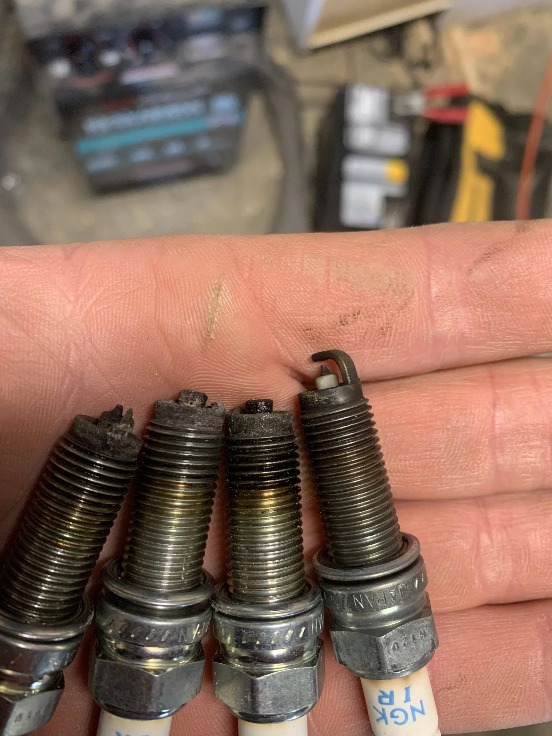

This community is the best I appreciate all of the advice and possibilities. Here is a picture of the plugs. In actuality all 4 were burnt up I just held one that wasn’t next to the three for comparison. Showing my girlfriend
Late to the party, but that is detonation, IMO.
