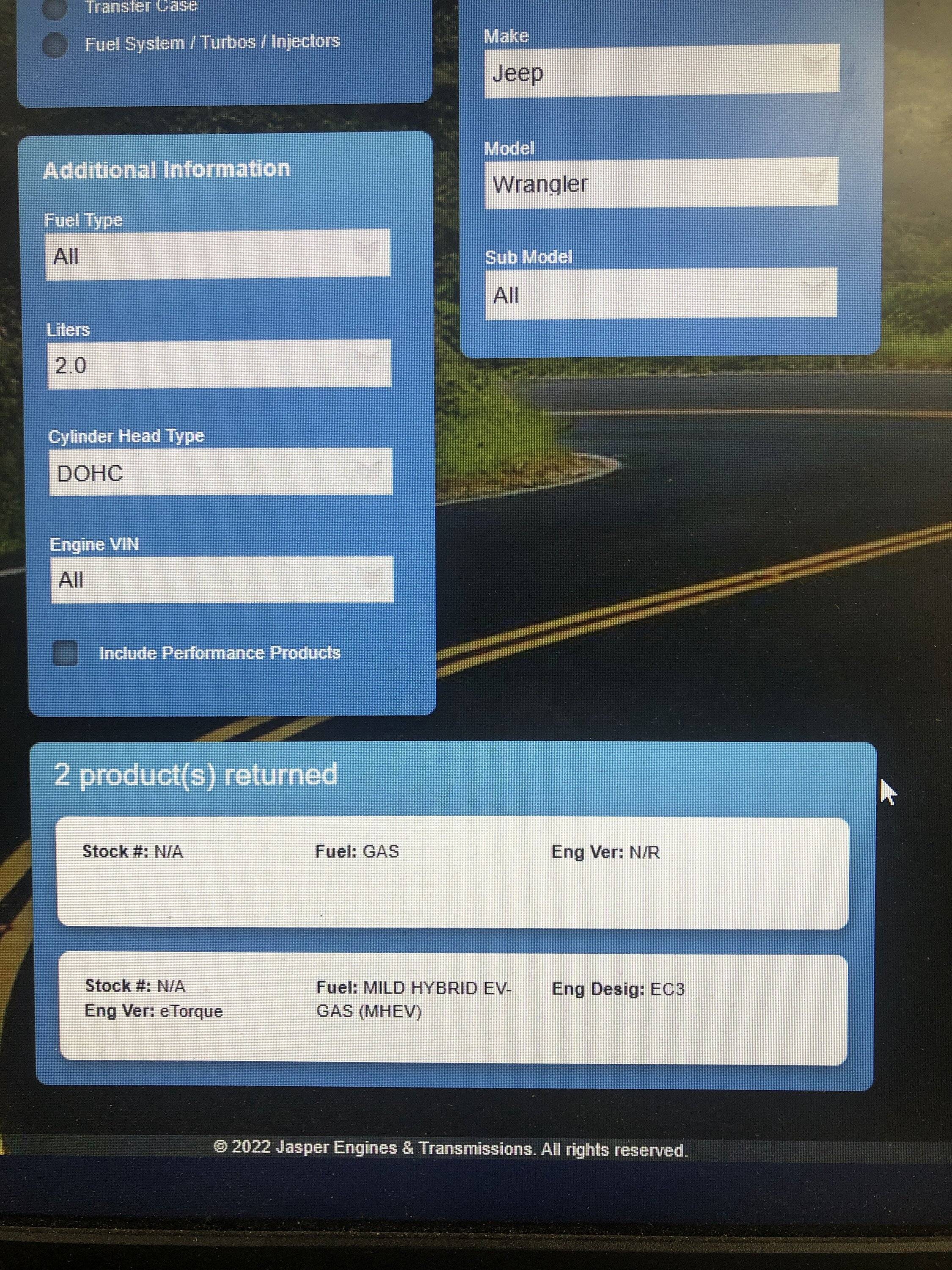

Nobody makes a 2.0 but Mopar.
Are you stating nobody sells new 2.0 engines but mopar? If so, you are correct. Companies do sell remanufactured 2.0 mopar engines. Do your homework and you can find them.
Do my homework, lol. If you want some shitpile half rebuild slopjob, you can always find one. Jasper doesn’t build these.
Trust me bro.
Jeep Wrangler JL Repair or replace my 2.0 engine image
Titan doesn’t do modern engines at all.
