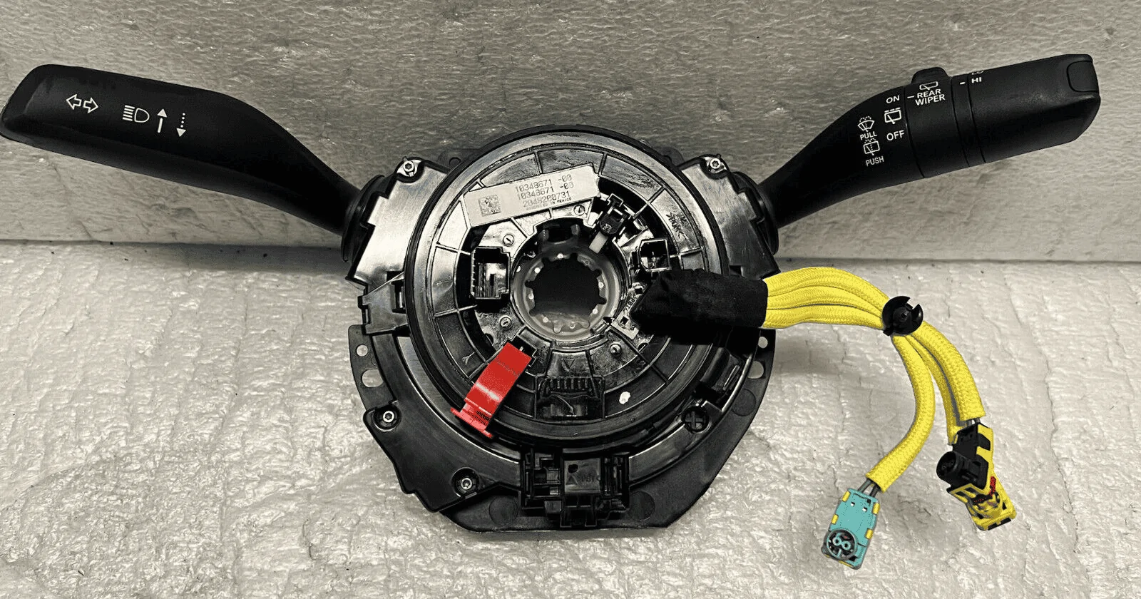

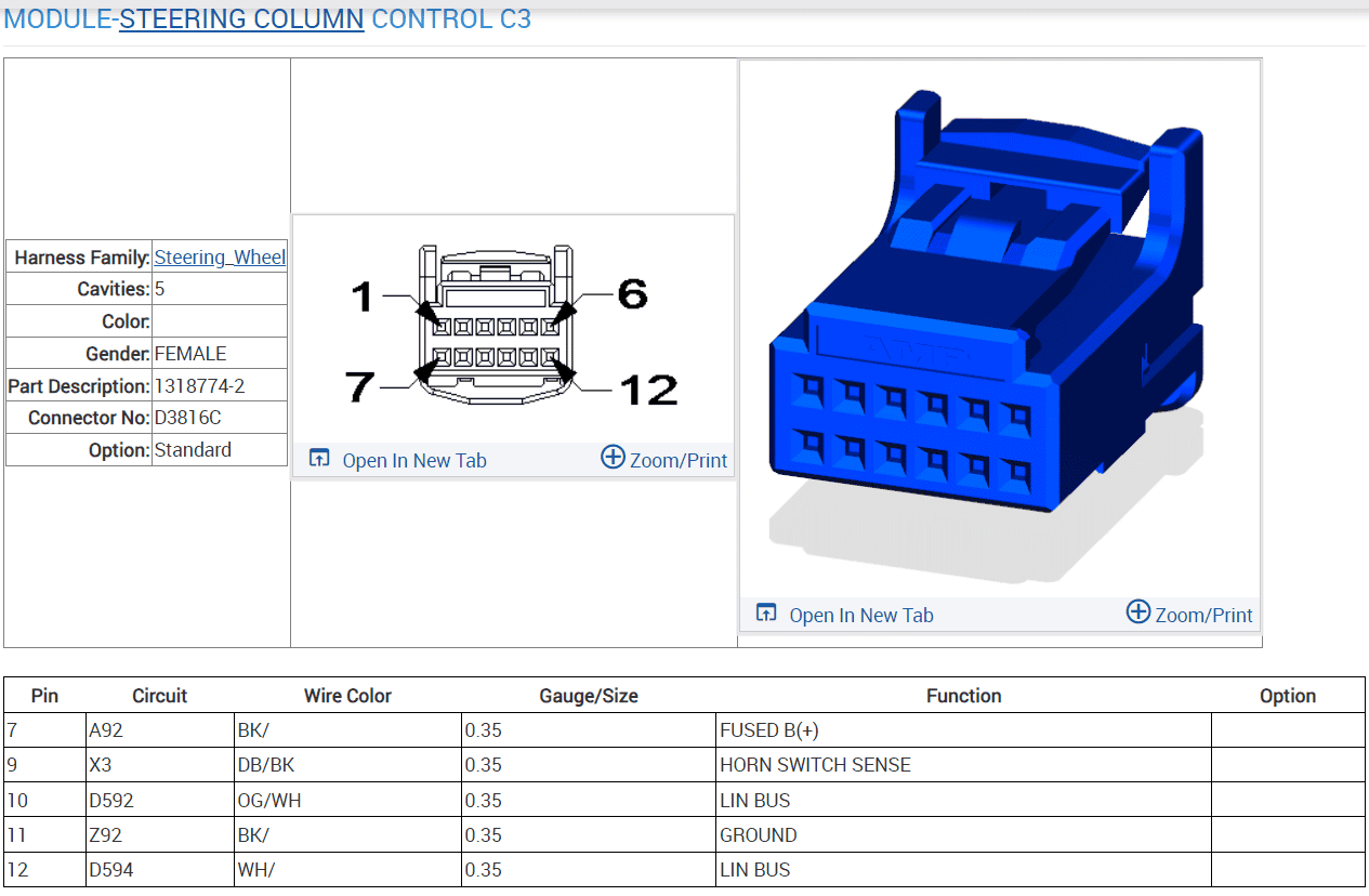

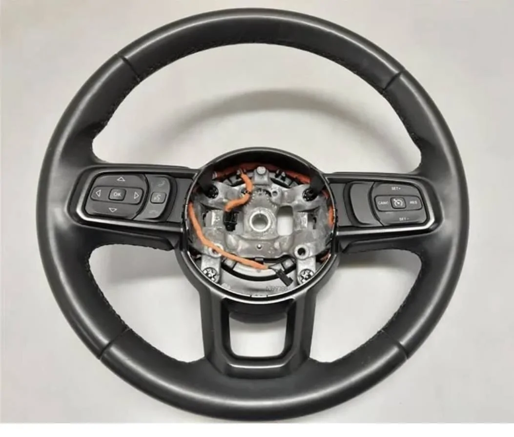

Pulled the diagrams, and you're right. Everything's can and then distributed in the wheel harness. Heated wheel can go away, and you'd need to get rid of the six air bag "squib" conductors.Actually there isn’t that many wires, I count five if you don’t have a heated wheel. I believe it’s doable.
image swiped from eBay.

Worse case, you could relocate the horn and that would get you down to four.
