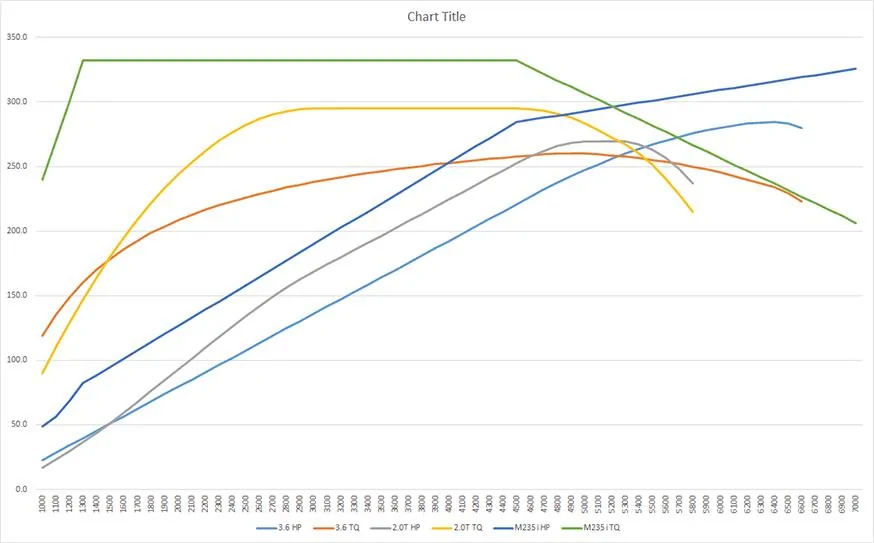

Bull shit. Well into boost by 1900rpm? Nope. The 3.6L makes more torque than the 2.0t until about 2200rpm because it's not into boost yet. And who cares if they are both gutless below 2300 rpm? You don't want/ need to be at peak torque or boost when cruising around at low loads which is the whole point of having 2 overdrives. Some people act like the thing takes more than a fraction of a second to downshift and get into the power/ boost.
Also found this chart posted on this forum too. Shows that at 2000 rpm the 2.0 is making 40-50 more ft-pounds than the 3.6. The TQ cross over happens around 1500rpm when the boost starts building.

I promise you and @grimmjeeper can attest, these new 3.6s do not do SHIT until right after 1900rpm.
I've watched 2.0s on 4.10s and 35s spin both tires on pavement without launching it on the converter. The 3.6 won't.
The dyno chart doesn't lie, neither engine makes shit for power below 2k rpms. The 2.0t makes less than the 3.6L below 2200 rpm period. But hammer the throttle on either and you're well beyond that nearly instantly. The 3.6L needs to get to 4k plus for peak torque and 6k plus for peak horsepower which is the diffrence you're feeling. Below 2200 rpm both are gutless. Beyond that and into the boost the 2.0t comes and strong and fast. The 3.6Ls torque output just remains gutless and no amount of gearing is going to fix that. Unless of course you cruise around at 4k+ rpms, but that's dumb.

So you didn't look at the chart I posted?
That clearly shows at 2000rpm that the 2.0 is making more HP and TQ than the 3.6?
Jeep Wrangler JL Regear or Not 1752265145800-66
That pull shows 1600rpm to 2200rpm. Yellow is 2.0TQ, orange is 3.6TQ. gray is 2.0HP, light blue is 3.6.
The boosted one is ahead at 1600rpm and not by a small margin.
Any chart that smooth isn't a real dyno chart period. The perfectly flat m235 line is even more comical. I'll stick with legitimate dyno charts from reputable sources. Go ahead and put a boost gauge on the 2.0t and see for yourself if it's well into boost below 2k rpms. It's not and I know that for a fact as our 2019 had a gauge on it.

It does if you find one that starts the run off the throttle above idle. Especially with a turbo.
To get the most accurate dyno run you should be in 6th gear (1-1) I'm pretty sure you can't even get it to manually shift into 6th at idle?
