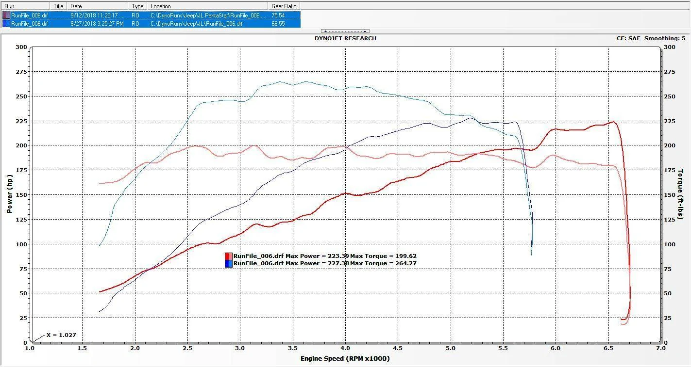

Bull shit. Well into boost by 1900rpm? Nope. The 3.6L makes more torque than the 2.0t until about 2200rpm because it's not into boost yet. And who cares if they are both gutless below 2300 rpm? You don't want/ need to be at peak torque or boost when cruising around at low loads which is the whole point of having 2 overdrives. Some people act like the thing takes more than a fraction of a second to downshift and get into the power/ boost.
Jeep Wrangler JL Regear or Not 20v36_all-jpg

I promise you and @grimmjeeper can attest, these new 3.6s do not do SHIT until right after 1900rpm.
I've watched 2.0s on 4.10s and 35s spin both tires on pavement without launching it on the converter. The 3.6 won't.
Yep. The difference between the real world and bench racing with out-of-context stats.
