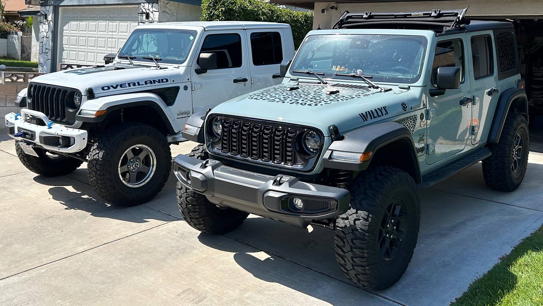

My wife runs 37s on her 24 Willys with no issues on 4.10s, I think you’ll be fine with 35s. If you can put your thumb between the tire and lower control arm now, then you shouldn’t have any problems with 15 more millimeters in terms of rubbing. Any generic off brand spare tire relocation bracket will work to raise the spare enough to clear the bumper. Might add a hinge reinforcement plate while you’re at it.

Can share some pics?

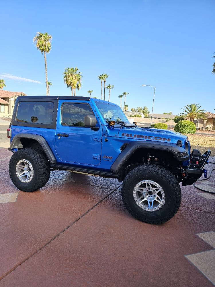

I run the Mickey Bajas LT315-70-17 (35s) Load Range E on my 23 Wrangler "IZARUBI" 2 Dr with Methods 106 Beadlocks running 4.10:1 and I am not seeing any problems them. My turning radius is awesome. I can make a very sharp u-turn with no problem.

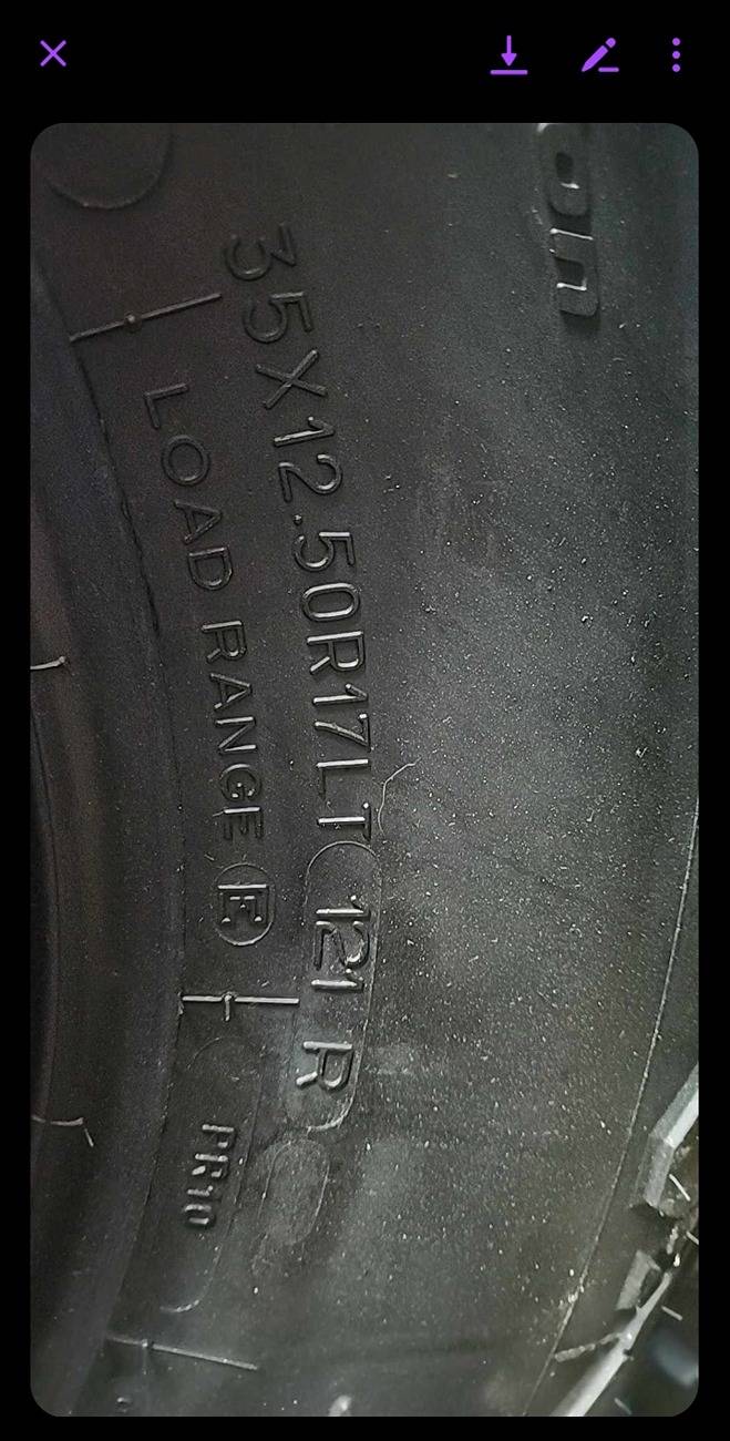

Found a set of used set bfgoodrich ko2s with only 3k miles. Theyre load E 10 plys, how much difference will this be campare to my falken wildpeak ride wise?
You'll definitely want to run lower air pressure to make it comfortable.
