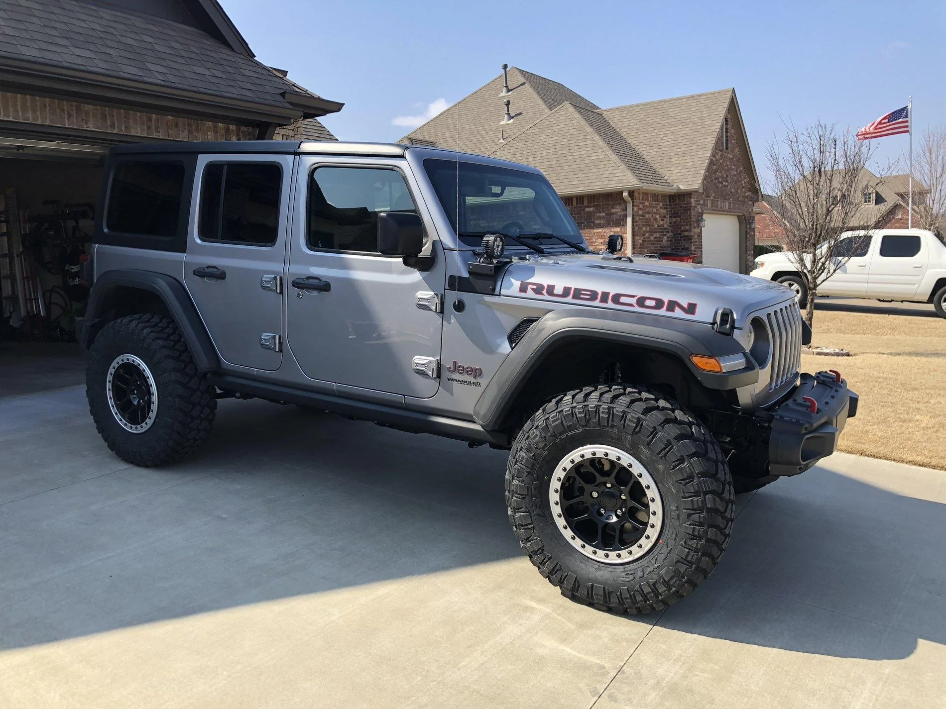

So the auto tire size calibration appears to work. I had 37’s put on my JLUR yesterday and using my MPH app on my phone I validated that my speedometer was off by about 5mph around the 35mph area (speedo showing 31 when my gps app was showing 35) and about 10 off in the 70mph area. Today as I was crushing along it seemed like I was going slow and vehicles were passing me like I was a moron out for a Sunday drive on the highway. I looked down and it showed I was doing 60 so I thought I was cruising at about 70mph. I pulled up the MPH app and it showed I was doing 60 just like my speedo showed. I sped up and slowed down and the gps app matched the speedo at every speed. This all happend within 20 miles of the new 37’s being put on. And yes it was accurate with 37’s picture of my Jeep with 37’s for proof. I’ll try and post a shot with the gps and speedo together later.

Ok, here is an update. And by the way I have the 8.4” screen. After posting that it work and auto corrected, on the way home I noticed that it was off again. I pulled up my gps app and sure enough it was off by 5mph like it should be. I left the app up and running and about a mile into my trip home it self correct and was accurate again. This is got to be totally driven by the gps/nav system communicating to the speedometer. My guess is it will revert back to the factory setting each time the power is off and the Jeep sits for a bit. So a programmer (when one is available) or a dealer programming will make it more accurate and not have to be relearned every time the car is turned off. The plus side is I won’t have to shell out $125 at the dealer because it works good enough for now and will get a programmer when they are available. I am supplying picture for the people in doubt (I would be too) to show the speedo is correct with 37’s on it. My daughter took the pics for safety reasons, :like:
