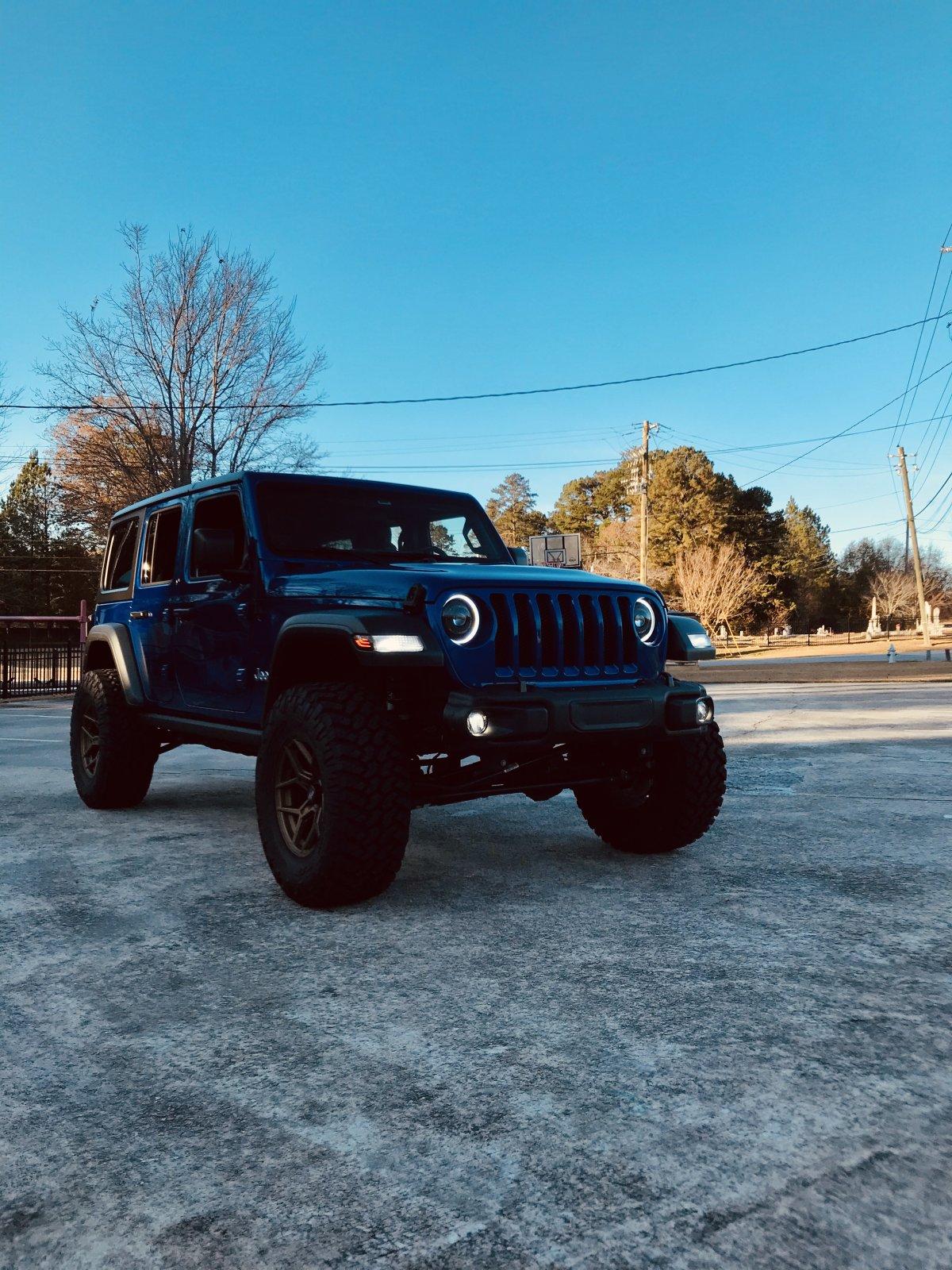

I prefer a good bit of poke, so -18mm would prob be my cup of tea. Was actually looking at the same wheel recently. I’m running a -12mm 4.5 bs wheel rn and it clears fine. Pretty aggressive look but not over the top poke.
I like poke as well, part of getting it to look a little more aggressive. But i’m more concerned with rubbing if i’m flexing it out. Have any photos of how much your wheels poke?
I figure -18mm offset is the same as a rubi running 0 offset however if my math is right.
Oh yeah, I’ve got a strong feeling mine would rub a bit in the rear if flexed out.....I’m only running a 2” lift so my up-travel is limited.
Then again, mine is a daily driver and I don’t have any intentions of doing hard core rockcrawling atm ??‍♂.
