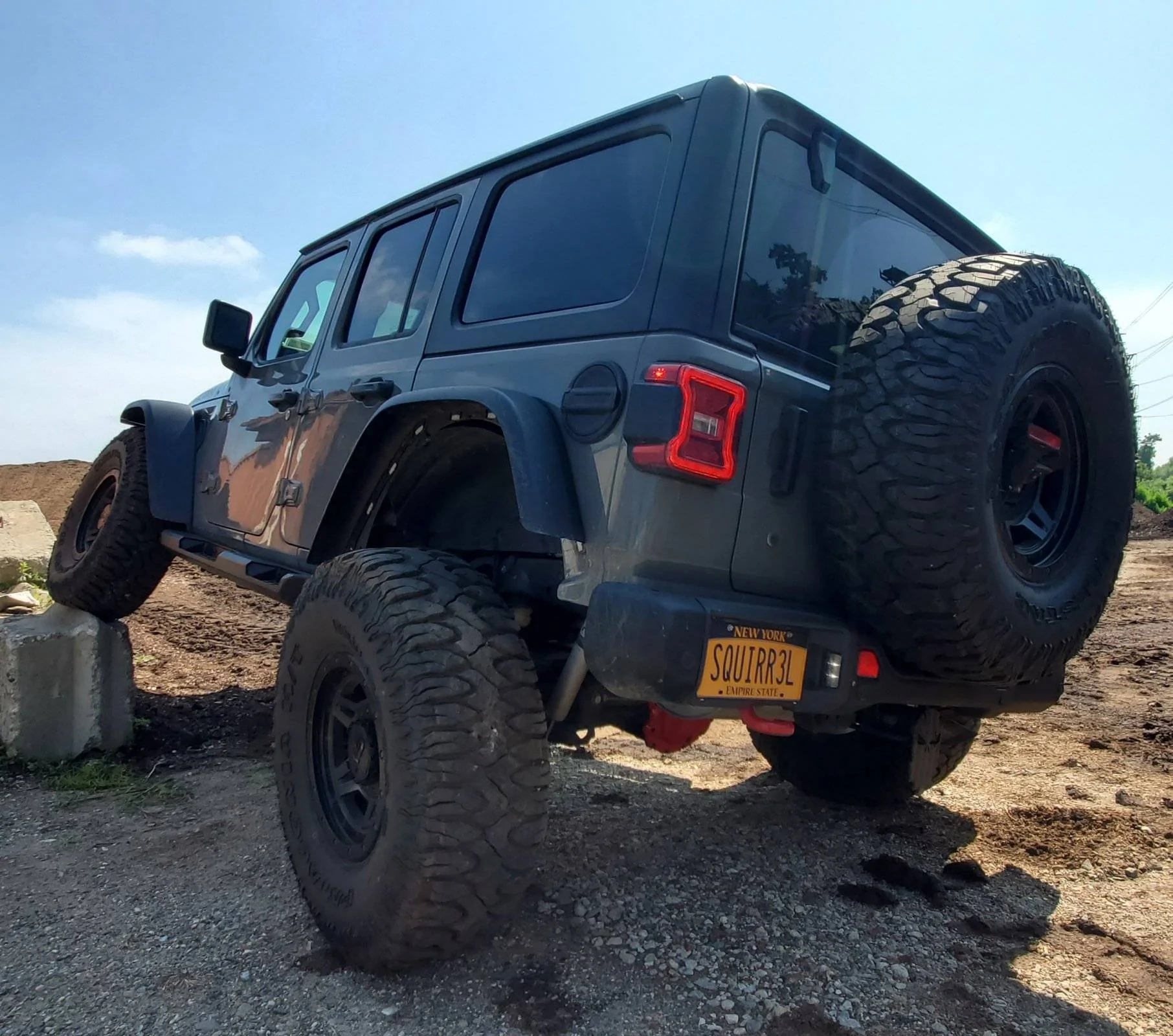

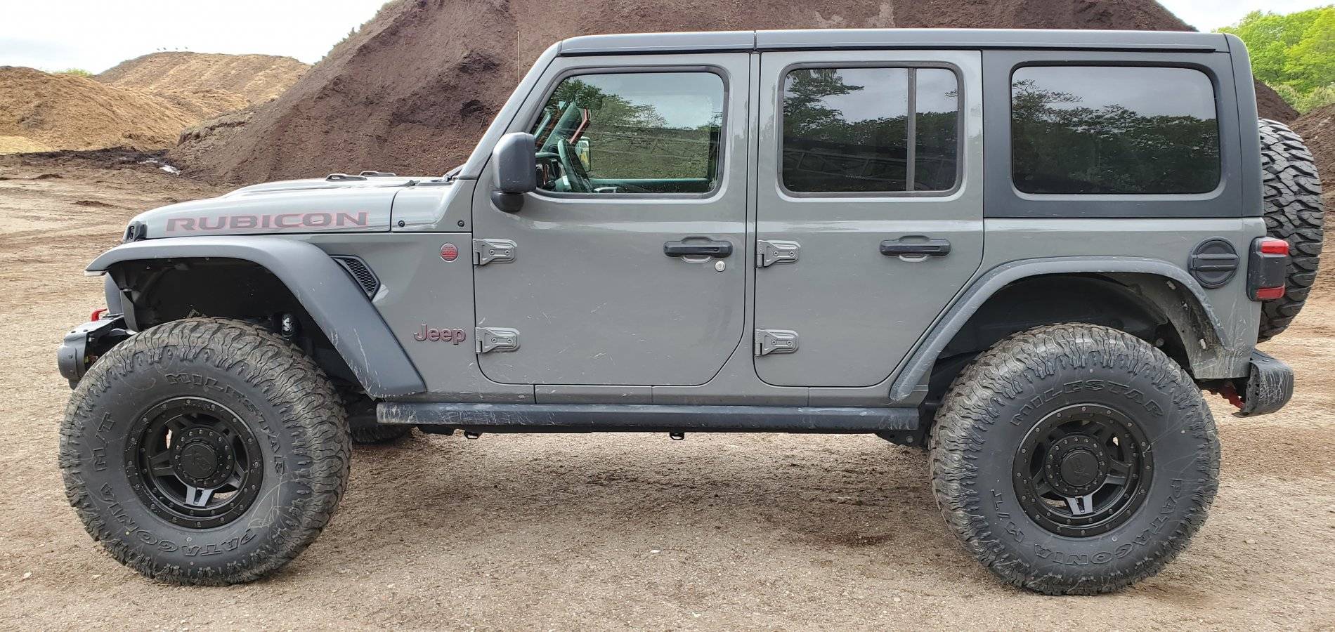

Here's my 19 JLUR on 38x13.5's wrapped around 17x9 wheels with -12mm offset and 4.53" backspace, and my 1st lift the true 2" Dynatrac Endurosport. It's not a very flexible suspension system, just like factory Rubicon and the Mopar lift setups.
how do those 13.50 ride?
The Milestar Pat's have treated me well. I've seen misty rain that lifts the oil out of the roadways and torrential downpours that flooded the roads, and am only recently getting a little slippage after about 30k worth of wear. This past winter gave my area 2 snowfalls that dumped about a foot each, and they didn't let me down at all. I was originally skeptical about the added floatation of the 13.5 over the 12.5 for bad weather road driving. This jeep is my daily driver. But this specific tire is designed to not use the full width when aired up, so it's like driving around with a narrower tire. I've been overall very pleased.
