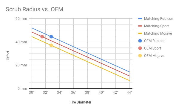

Don’t get a wheel wider than 8.5” unless running bigger than 37” tires. Don’t get the 13.5” wide 37s, get the 12.5”. The jl steering is sensitive and keeping that scrub radius to a minimum is very important. Cheers. .
FWIW: The scrub radius is effected by the tire diameter.
