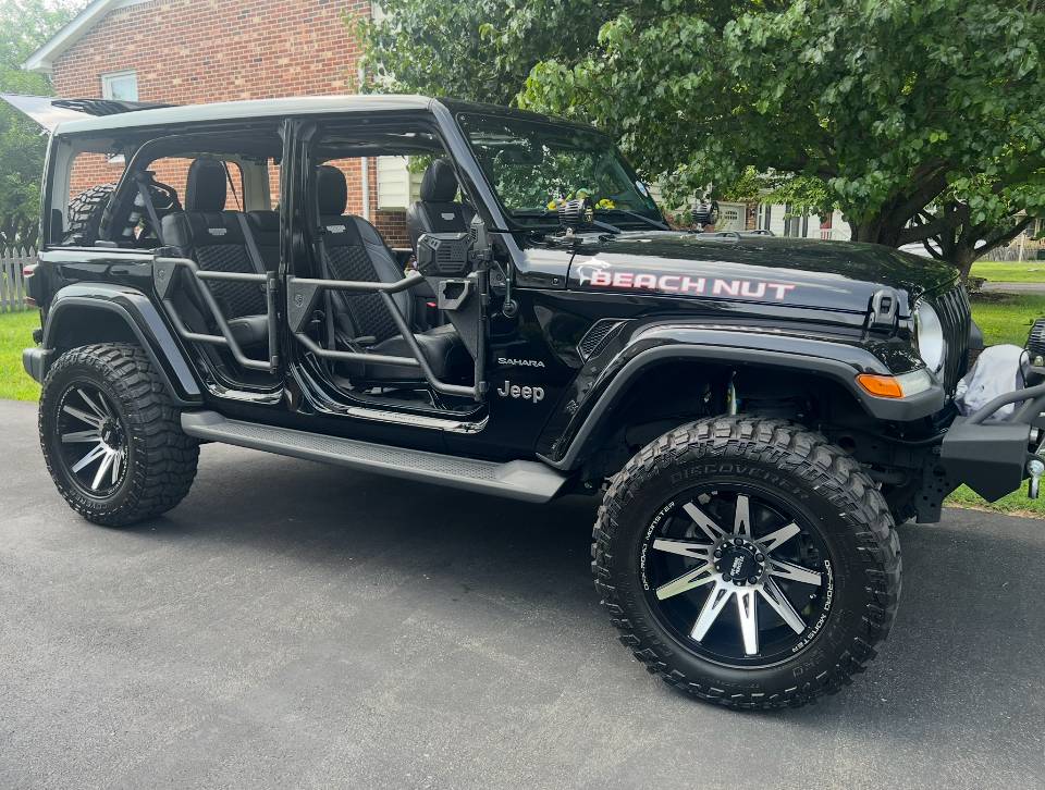

I’m running the Clayton 2.5 Overland Kit on my Sahara with 35s…plenty of clearance…however, with this kit, all you need is the 3.5 springs and possibly shocks to go higher. My 2.5 yielded a bit over 3” from stock…it handles great on light to moderate off road situations! Bilstein 5100 shocks.
