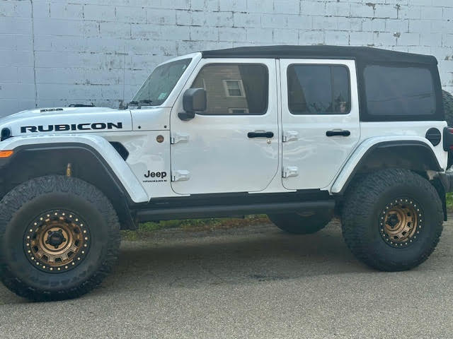

392 w 456's gives 0 fucks about 38's
Jeep Wrangler JL Regear or Not jeep38-1
