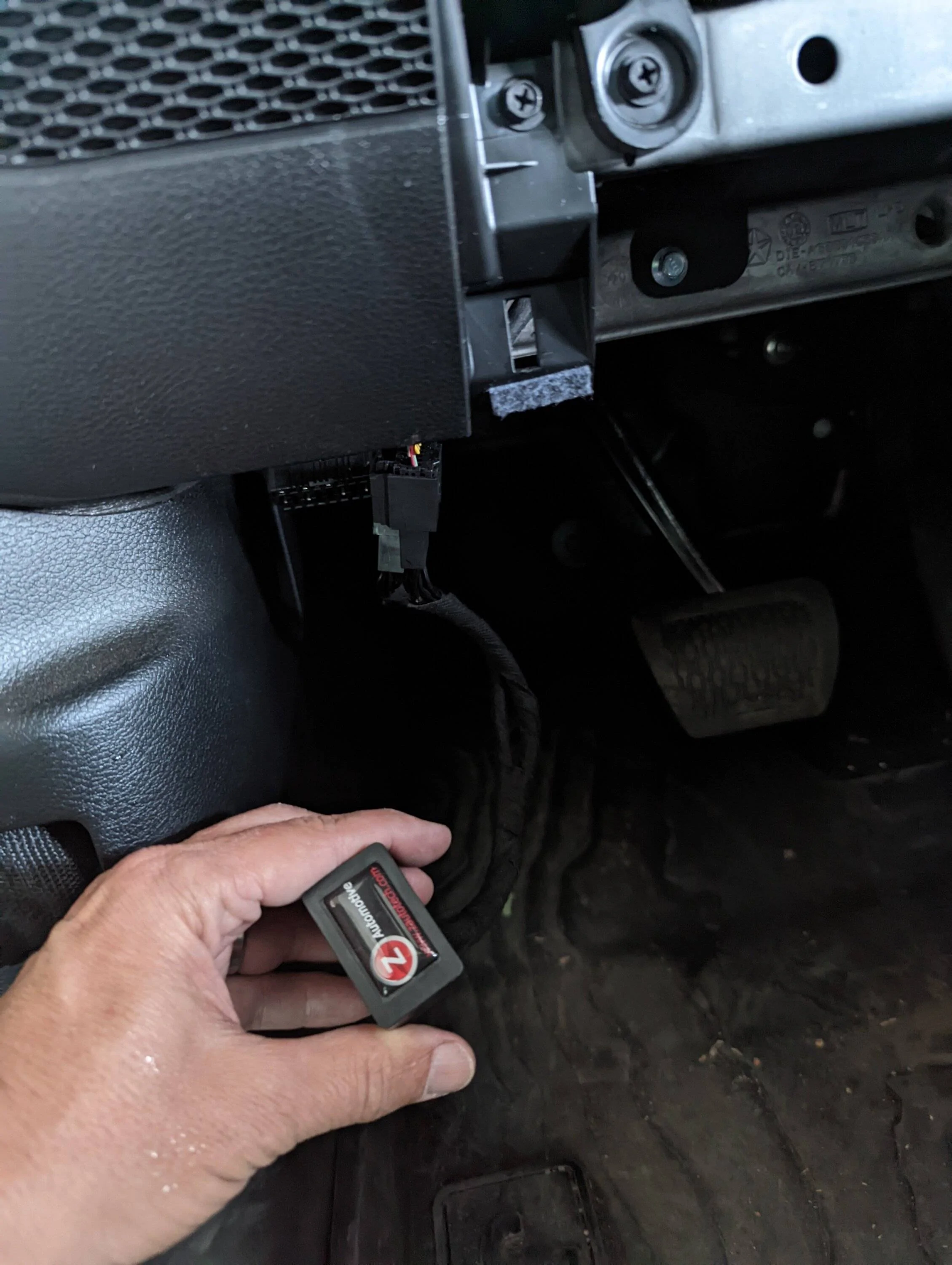

If you get a Tazer JL Mini I highly recommend getting their extension cable. Trying to get your hands up in there is still a pain in the ass, but nothing compared to dealing with those connections without that extension.
To remove the panel under the steering wheel just use your hands and slowly / gently pry from the top. The six clips will eventually start popping free.
There's a push tab on the back of the SOB connectors for the Tazer. Use your right hand to push one of those while tugging with your left. Keep trying until it pops out.
Connect the extension between the Tazer and those plugs. Tuck it in somewhere and put the panel cover back on.
