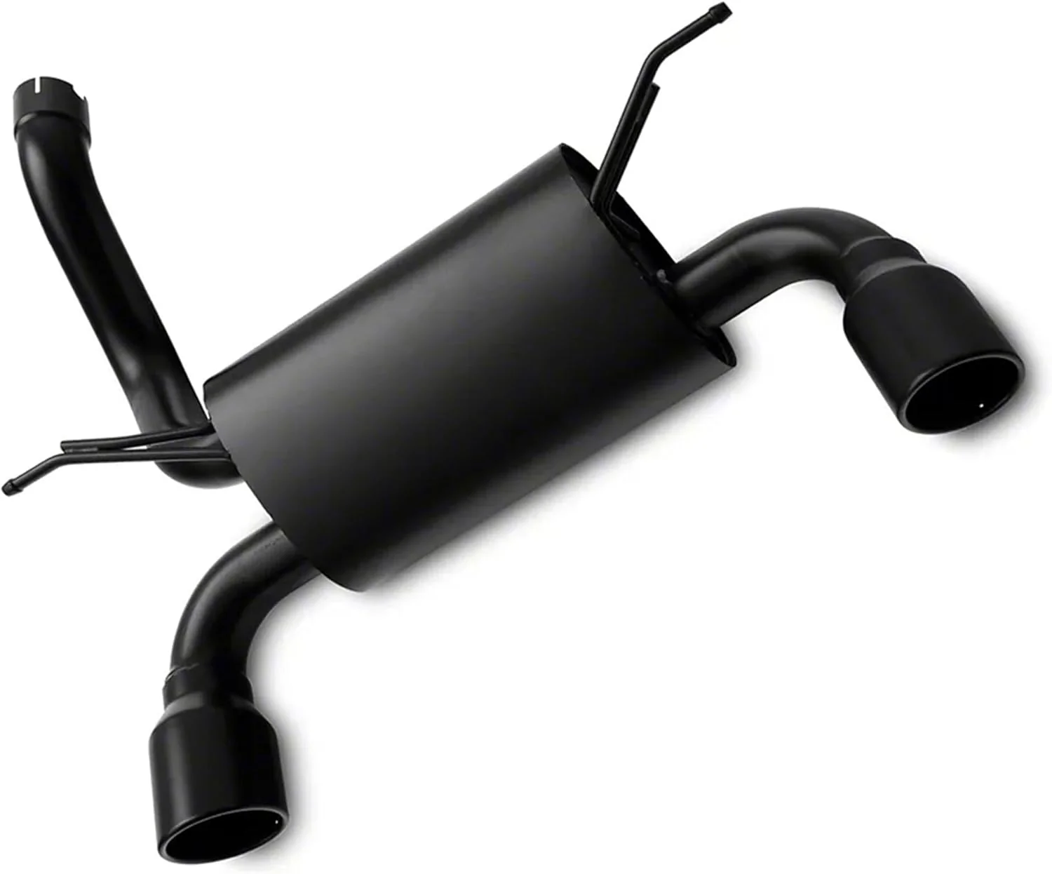

would love to hear that on a 2.0, i went from an axle back hi tuck straight pipe (https://amzn.to/3NzCWqg)
Jeep Wrangler JL Quietest Hi-Tuck muffler? 1729482169606-rz

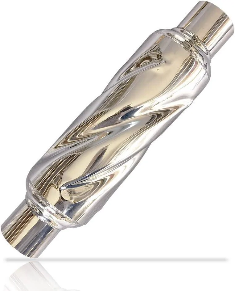

but that was too loud so I added a glass pack(https://amzn.to/3NvGB8r)
Jeep Wrangler JL Quietest Hi-Tuck muffler? 1729482256611-27
