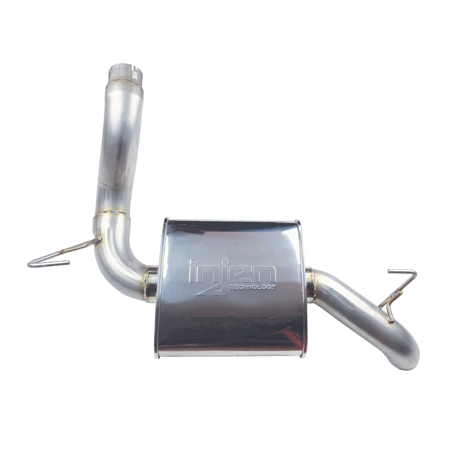

Not that I saw, I actually spread the pipe to fit it over the rivet first, but it eventually slipped back off of it.
That sucks. Thought the notch I saw in the stock photos was for the index, but looking closer at the similar AFE high-tuck muffler, the notch should be larger and on the inward side. Was pretty much dead-set on buying the Injen to get the 304 stainless, but fuck if I'm spending $700 for something I'll immediately have to start cutting up. Guess I'll just get the AFE w/409SS when it's on-sale for $400 again.
@kah.mun.rah Do you remember how yours was when you got it??
Yeah, it looks like that's just a bit of a clearancing affordance cut to make sure it will fit. The cutting wasn't bad though, bit of time with the dremel wheel - and that's on the OE mid pipe, I haven't had to mod the Injen at all. I've loved it for the most part, but I want to sort out the burble for sure as that's not a sound that gives me many warm fuzzies.
Everything slid on pretty easily without any extra cutting. Mine looks like this though so I am not sure if they have the same connection design:
Think you're right. Not sure about the burble, but when I swapped out my muffler on my last vehicle (Evo X) to a more free-flowing one, I got a lot of burble and even some pops, especially on deceleration. Afaik, it was just allowing me to hear things that I couldn't before (unspent fuel combusting in the cat). I really like hearing that kind of stuff though.
Iirc, I thought Robbie Ferreiri mentioned his having a burble somewhere in one of his vids and he had a the 3.6L (would think the 2.0T would have a bit more). Looking at his install video, there definitely isn't a notch cut out on the Injen. Kinda hard to tell, but it looks like it's only over the midpipe and butted up against the indexing rivet, but not over it.

I think pulling the Injen exhaust over the notch is a pretty dumb idea (how exactly are you expecting an equally distributed clamping force if you are doing that??? Of course it will be loose). Just rest it against, and tighten. The indexing notch is just that, so the factory monkeys don't bolt down a misaligned exhaust.

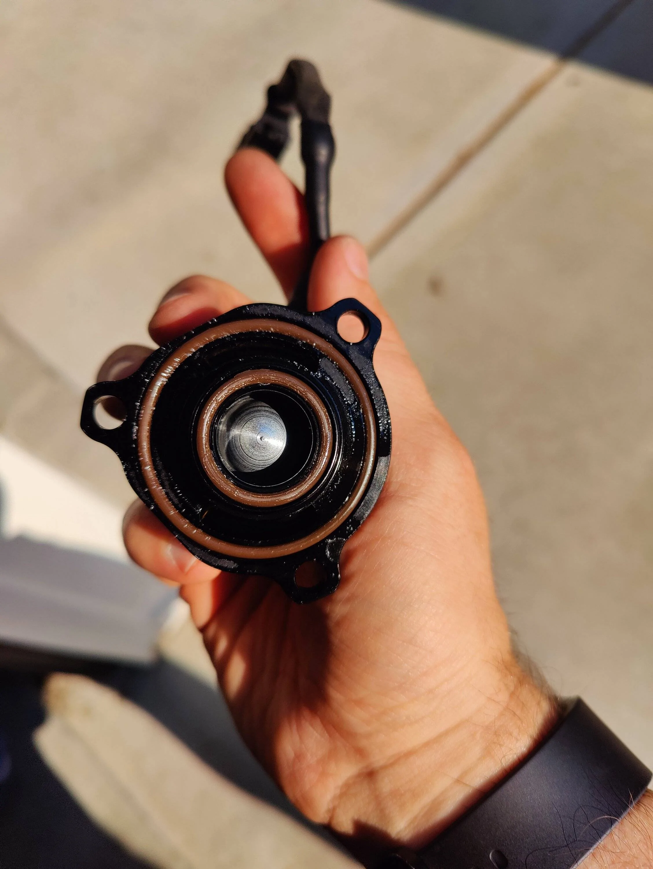

Here's another sample after I replaced the TurboSmart BOV with the OE plumbback and took a spirited drive around town. Also a shot of the BOV - doesn't appear damaged in any way, still nice and greasy from install a little over a year ago. Next step will probably be checking spark plugs, but I think the Injen exhaust, while being the primary indicator, can likely be ruled out as the cause.
Jeep Wrangler JL Injen High Tuck Muffler IMG20230524090632
  • Like
Reactions: AFD
That clip sounds really good imo. Just a nice amount of light crackle from hearing the unspent fuel ignite.
No idea about the BOV. I know some turbo vehicles react badly when changing out the factory BOV, depending upon the amount of vent to atmosphere vs re-circulation, but honestly no idea what works or doesn't for the Jeep's 2.0T engine.

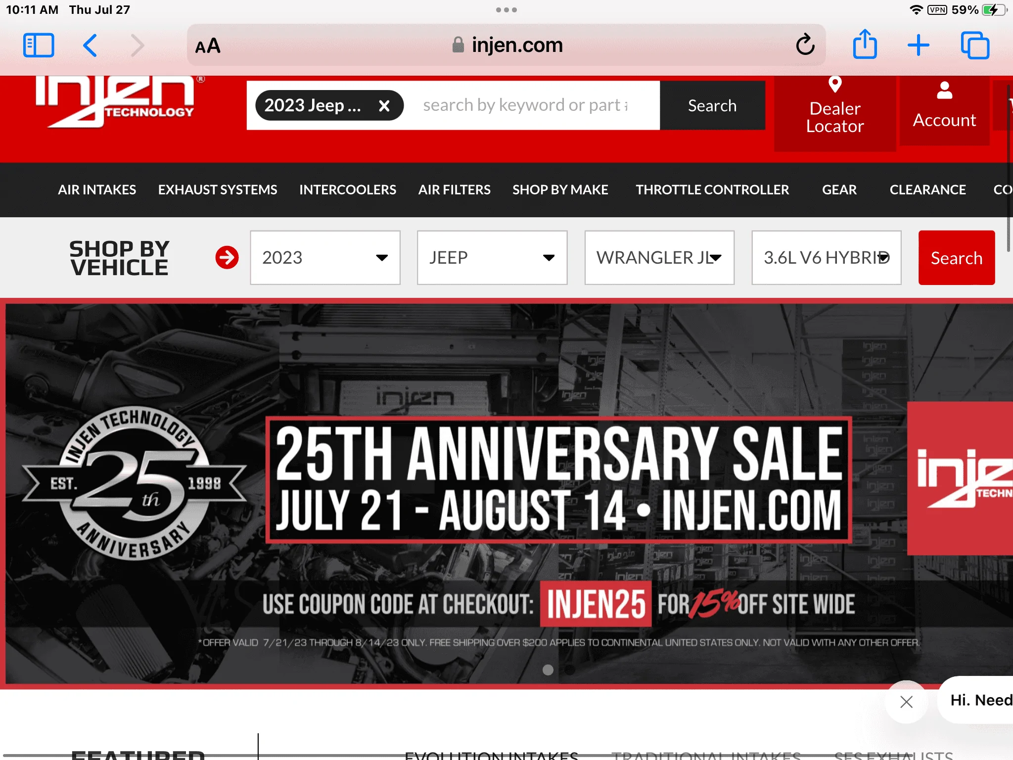

In case anyone is looking for a discount on an Injen high tuck exhaust…not cheap, but still aound $100 off. I’m still debating.
