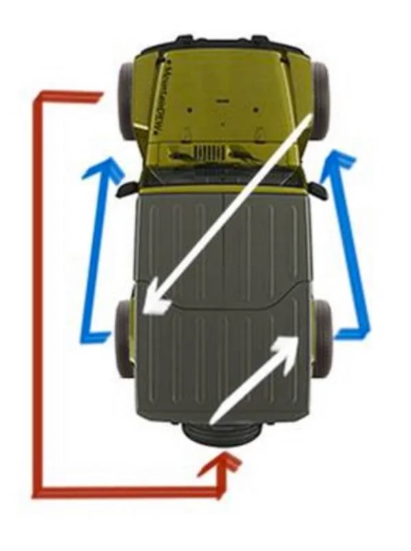

I only do a 4 tire rotation, X fronts to rear and rears to front same side. I have done this on all my rigs since I got out of the military at 5,000 mile intervals and have always gotten even tread wear and long life from my tires...
Lot's of opinions on this but Ford recommends this for their Raptors, RAM recommends it for my TRX, Jeep shows it in their owners manual...Plus if you do decide to change size or brand of tire, you now have a never-on-ground tire to sell to help offset the cost of your new ones!

They do not mention 5-tire rotation on that webpage.
read it again; they absolutely do, and they describe why.
a 4WD system will have a lower chance of binding up and will work better if all the tires on the ground are close to the same tread-wear and have the same roll-out/circumference.
Our owners manual states:
This spare tire may be used in the tire rotation for your vehicle.
That's the same text that's in the RAM manual.
Sure, you can enjoy the "pleasure" of attempting to sell an aged single tire (everyone loves doing that, right?) at a reduced price compared to new from a shop, or you can get ~20% more life out of the set and actually use what you paid for.

It is foolish to not do a five-tire rotation if you have a full-sized spare. You are basically throwing away a new tire at some point.
