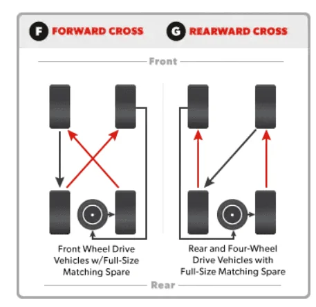

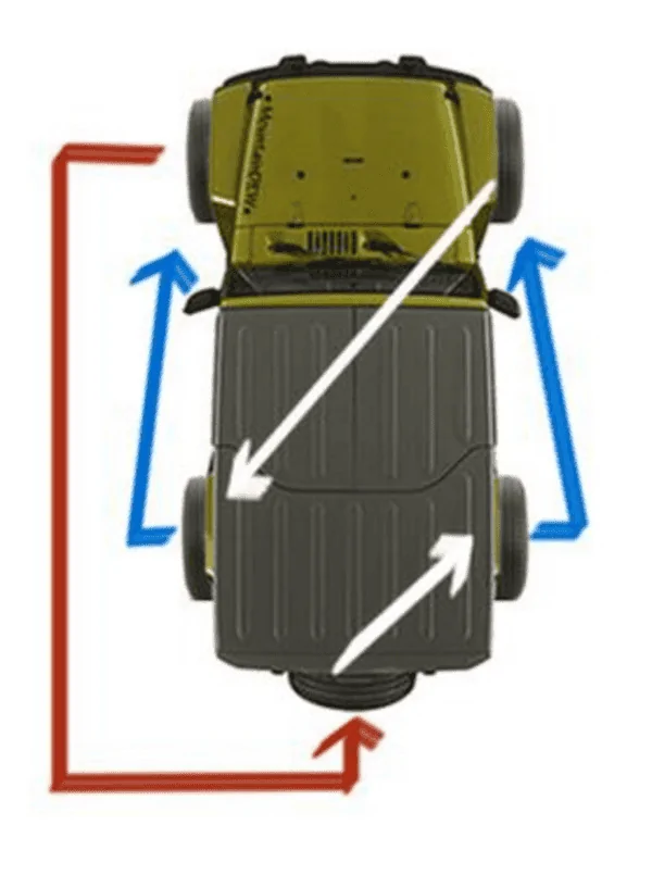

From Tire Rack (and the pattern i use on my JLU and Gladiator)
Jeep Wrangler JL 5 tire rotation question? 1707709491225
