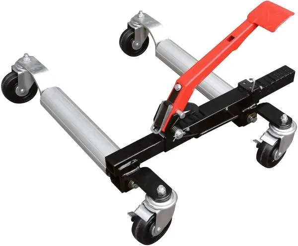

Stick with a pattern. Put a copy in the glove box. I have a Sunex tire caddy that I use to lift the wheel to the hub so that I don't have to wrestle with lifting the heavy tire and lining up the studs. The rear spare is the only heavy lift and don't scratch your backup camera.
Jeep Wrangler JL 5 tire rotation question? Sunex dolly

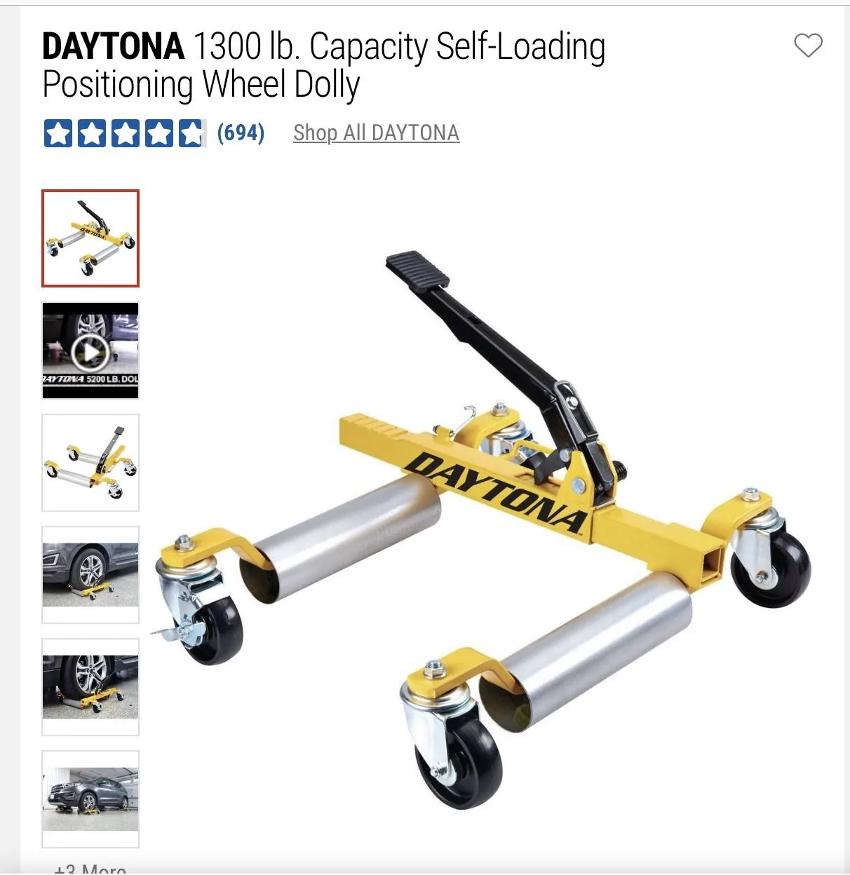

In the garage, I use this to lower the spare…
Jeep Wrangler JL 5 tire rotation question? IMG_0744

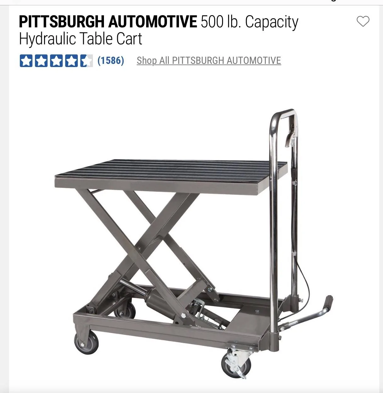

…and then this
Jeep Wrangler JL 5 tire rotation question? IMG_0745

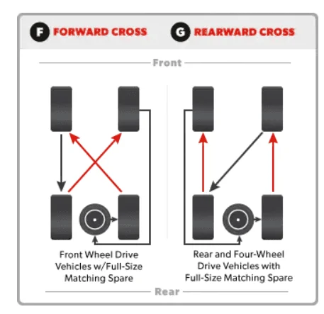

Just be sure to stick with one pattern.
If you go to Discount, I'm sure they have their own specific 5 tire pattern.
If you DIY, just DIY the same pattern every time.
Rearward Cross for me.
Jeep Wrangler JL 5 tire rotation question? 1707709491225

According to the Discount Tire website they show the standard rearward cross for a 5 tire rotation.

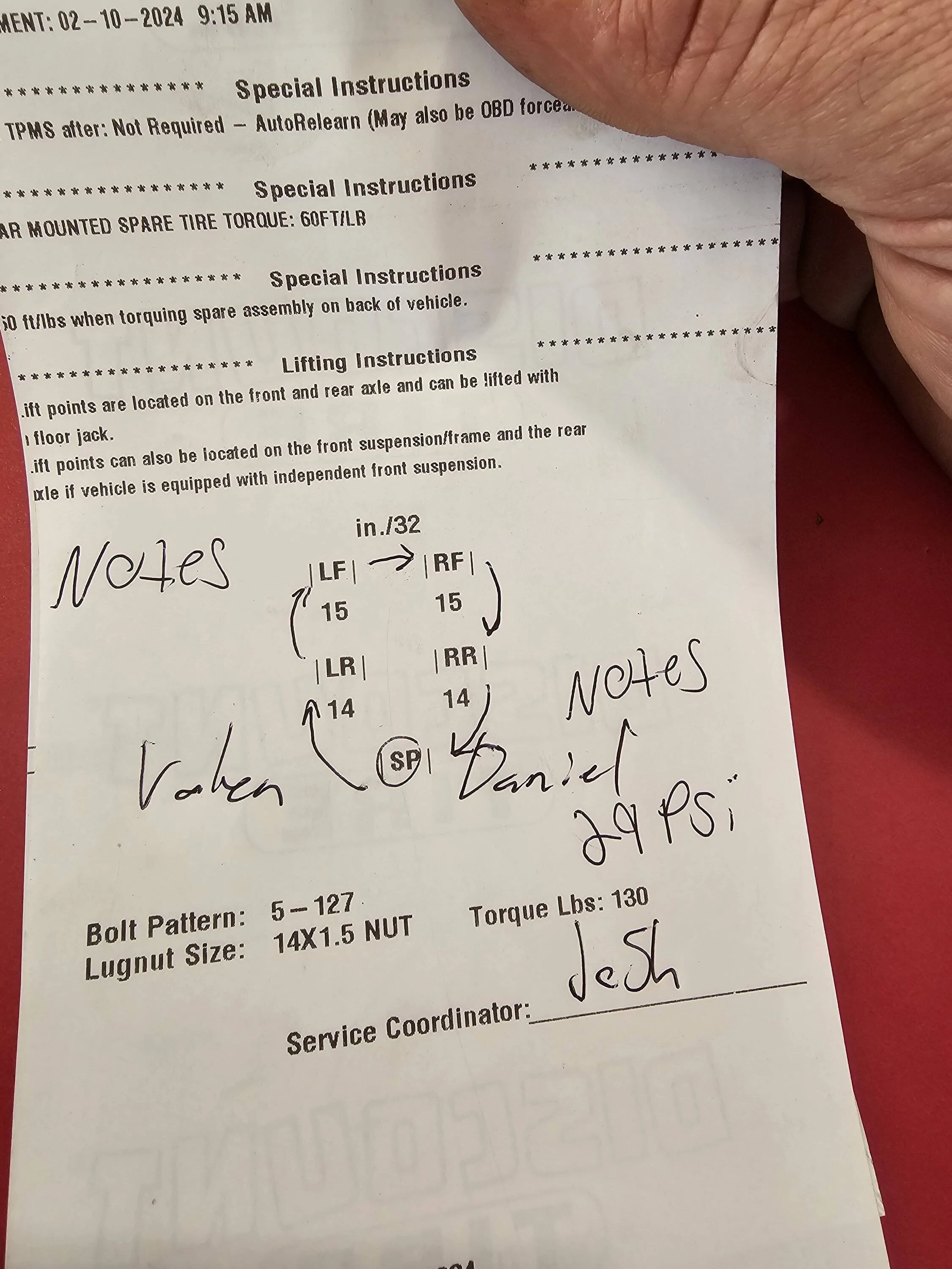

@Discount Tire, thank you for responding. I was in the area yesterday so I stopped back by and asked about it, they went back and pulled the slip from the work being done. I was impressed to see that they actually record how the rotation was done and at least based on the spare location it seems to match so I have that info now.
I don't quite understand why they did it the way they did though, as in the reading I've done online virtually no one suggests a clockwise rotation like they did. I think I'm going to pull them and move them into the positions that the rearward cross rotation would put them. Considering the rear right tire should theoretically wear the fastest, that makes more sense on where the brand new spare should go to try and match the other wear.
Below is a pic of my slip that they showed me.
Jeep Wrangler JL 5 tire rotation question? 20240214_134256
