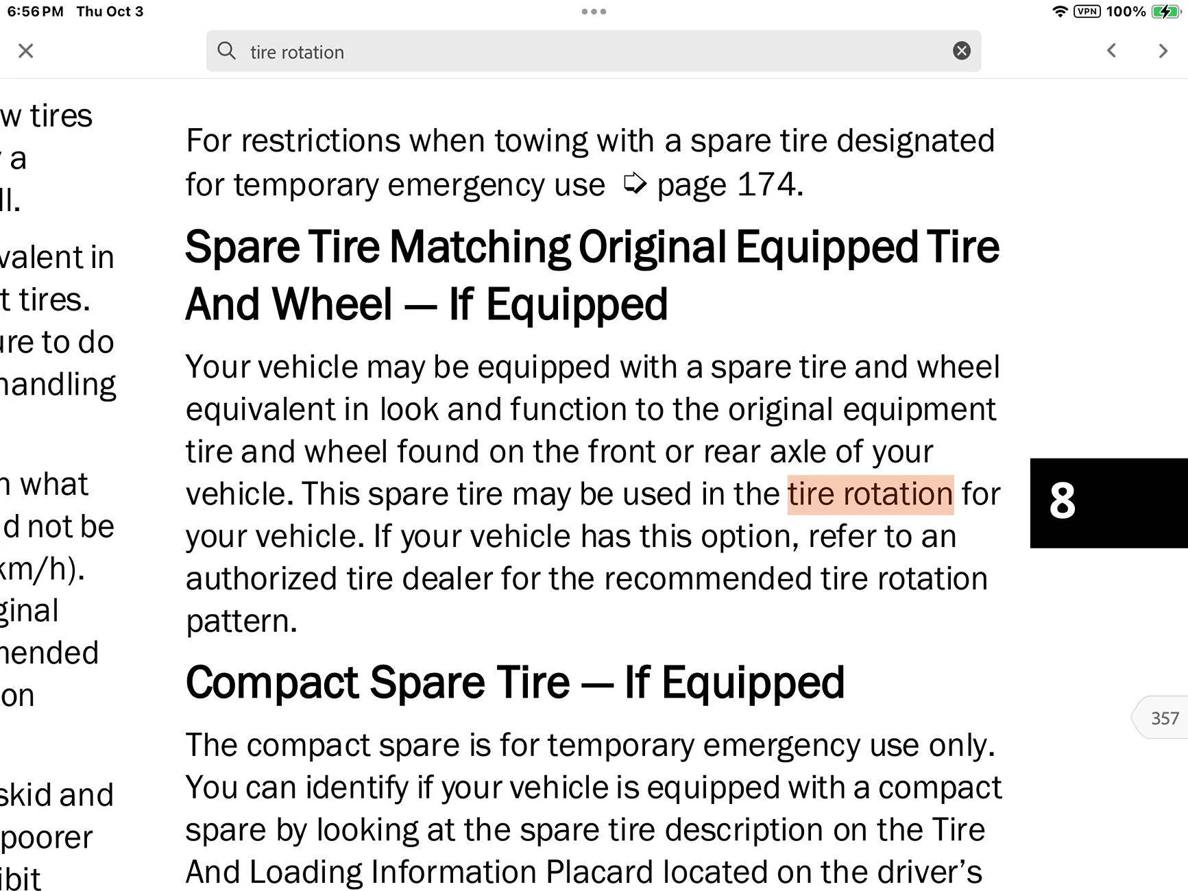

I freely admit that it might not explicitly say so in the manual, but do all 5. You'll get ~20% more life from your tires and will actually be able to use your lockers without worrying about screwing anything up with one tire being so much larger than the rest.
The alternative is to waste ~20% of your tires. You'll most likely get something different next iteration (e.g. KO3s instead of KO2s, etc), but even if you don't that tire is going to have aged.

To my rookie mind the rotation is to make for even wear on the tires you use all the time. The tire on the back is supposed to be a spare, not an everyday tire. putting it into the rotation only complicates things.
by keeping the rotation to the 4 you always use you assure even wear.
Let's change that a bit:
By keeping the rotation to 5 you always ensure even wear while also getting ~20% more wear.
