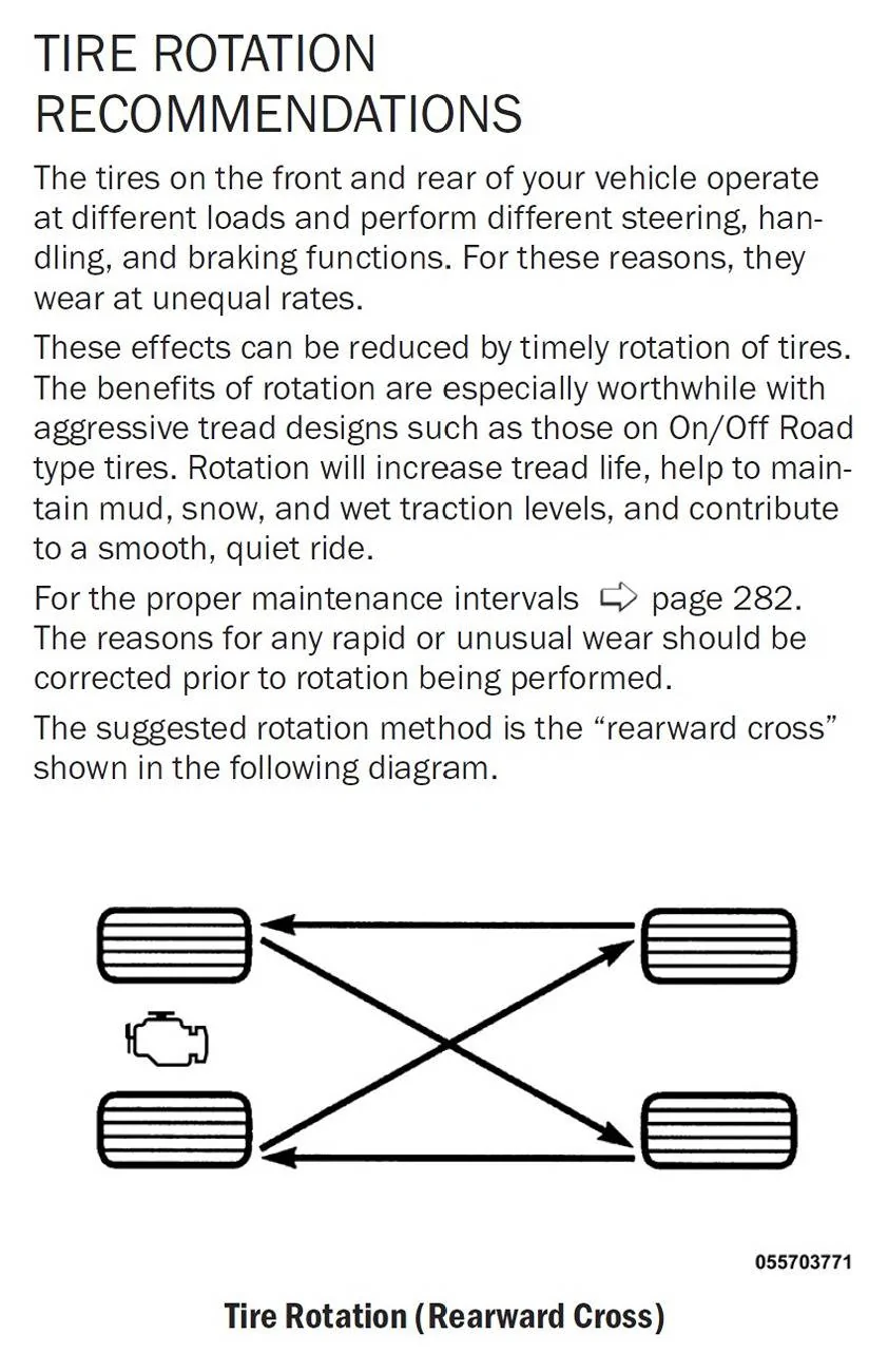

So, I'm about to take my new Jeep in for its first complimentary oil change and tire rotation.
I happened to ask them if they rotate all five tires or just the four on the ground. They replied it's my choice, 4-tire rotation or 5-tire rotation.
Well, I can easily think up why I might want a 5-tire rotation but the fact that they offer a choice instead of a recommendation made me wonder if there are owners who opt for only a 4-tire rotation, and why.
I notice the 2024 Wrangler Owners manual only mentions the 4-tire rotation:
Jeep Wrangler JL Question on 1st Tire Rotation Tire rotation from 2024 wrangler owners manual
Seems odd to me that they do not discuss a 5-tire rotation.
I read in another thread of someone who did the 4-tire rotation and wanted to change to 5-tire rotation but was told if his four tires had, say, 20,000 miles on them, it was too late to bring in the 5th tire. Too late? Okay, but does that consign the 5th tire to serve only as a temporary spare?
Anyway, I wonder is anyone has wisdom about any of this, 4-tire versus 5-tire rotation, and maybe why the manual would only advise on 4-tire rotation.
Thanks.

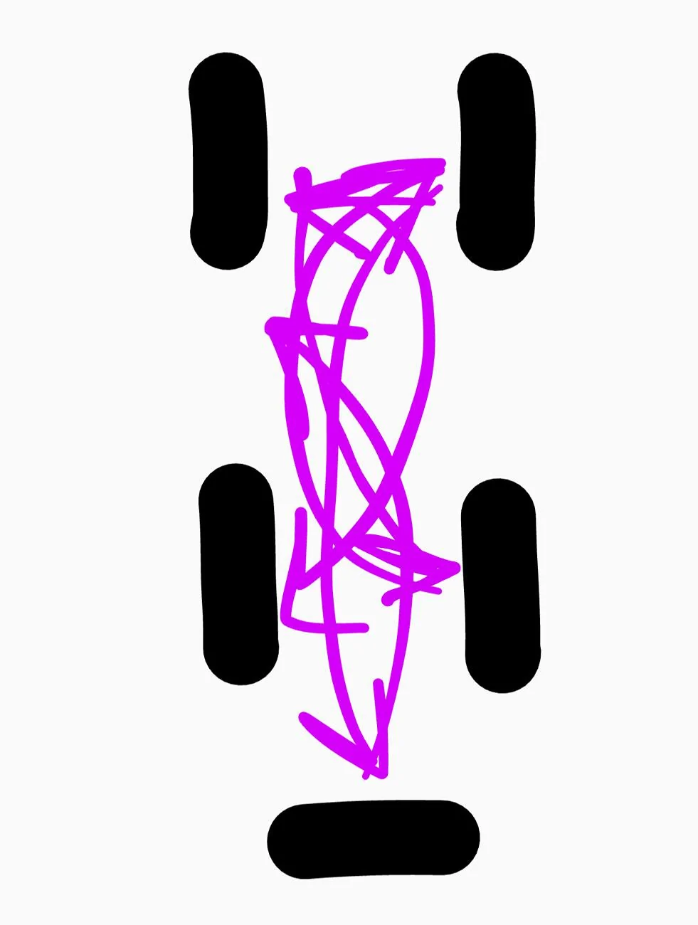

Thanks.
There’s a couple reasons guys do 5 tire rotation, one is you get 20% more wear on all the tires…. Another reason is, it sits in the weather/sunlight, and dry rot is a concern…. Me personally, I do a 5 tire rotation because I want to go to 38s next set, up from 37s and I want to wear them all out…..not because of these other reasons…..You do whichever way you want to, it’s not as big of a deal as some would have you believe…..
