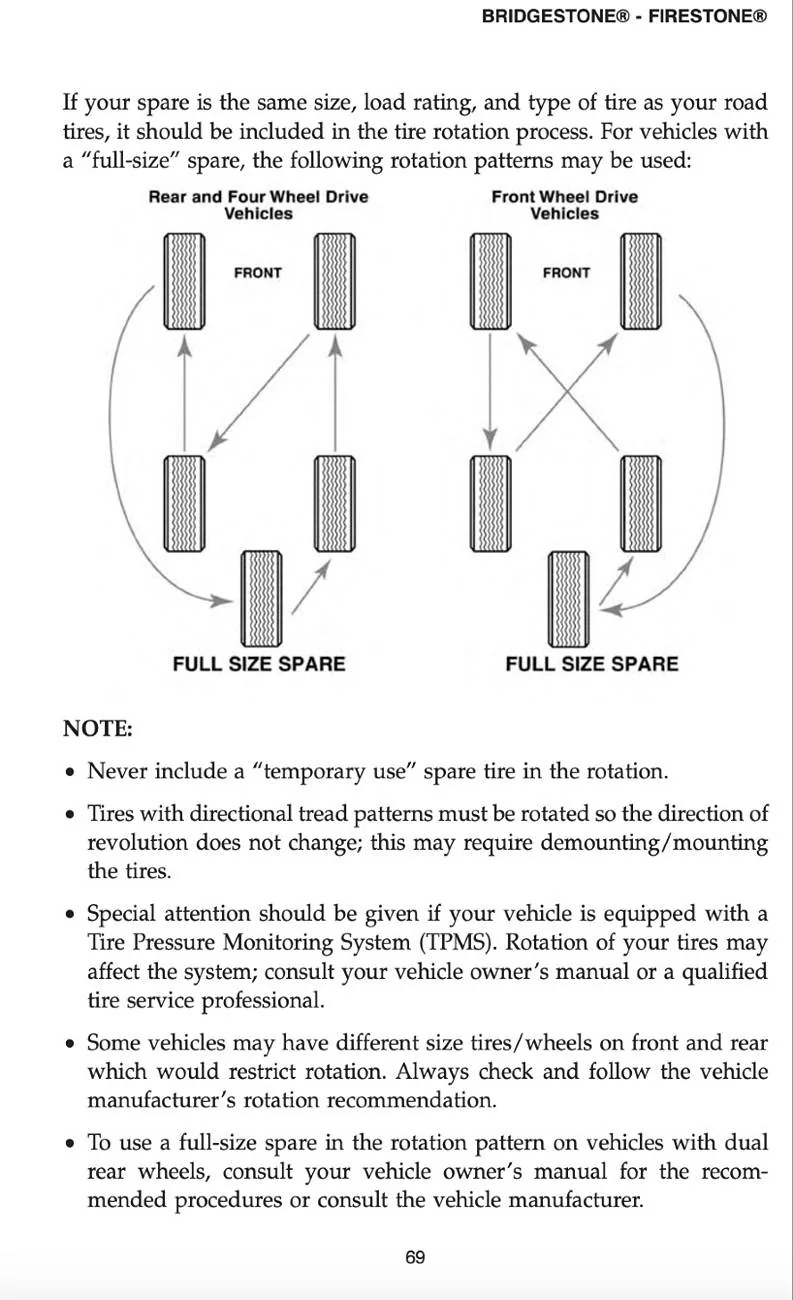

You're right. My mistake. I had done Control-F and searched for 5 and five and got nothing, and scrolling down I saw only diagrams for 4-tire rotations and no diagrams for 5-tire rotations. I didn't wade through the text.
Thank you. I've now deleted my post you had quoted, now that it's more than useless.

Please read page 69 of your tire warranty booklet.
