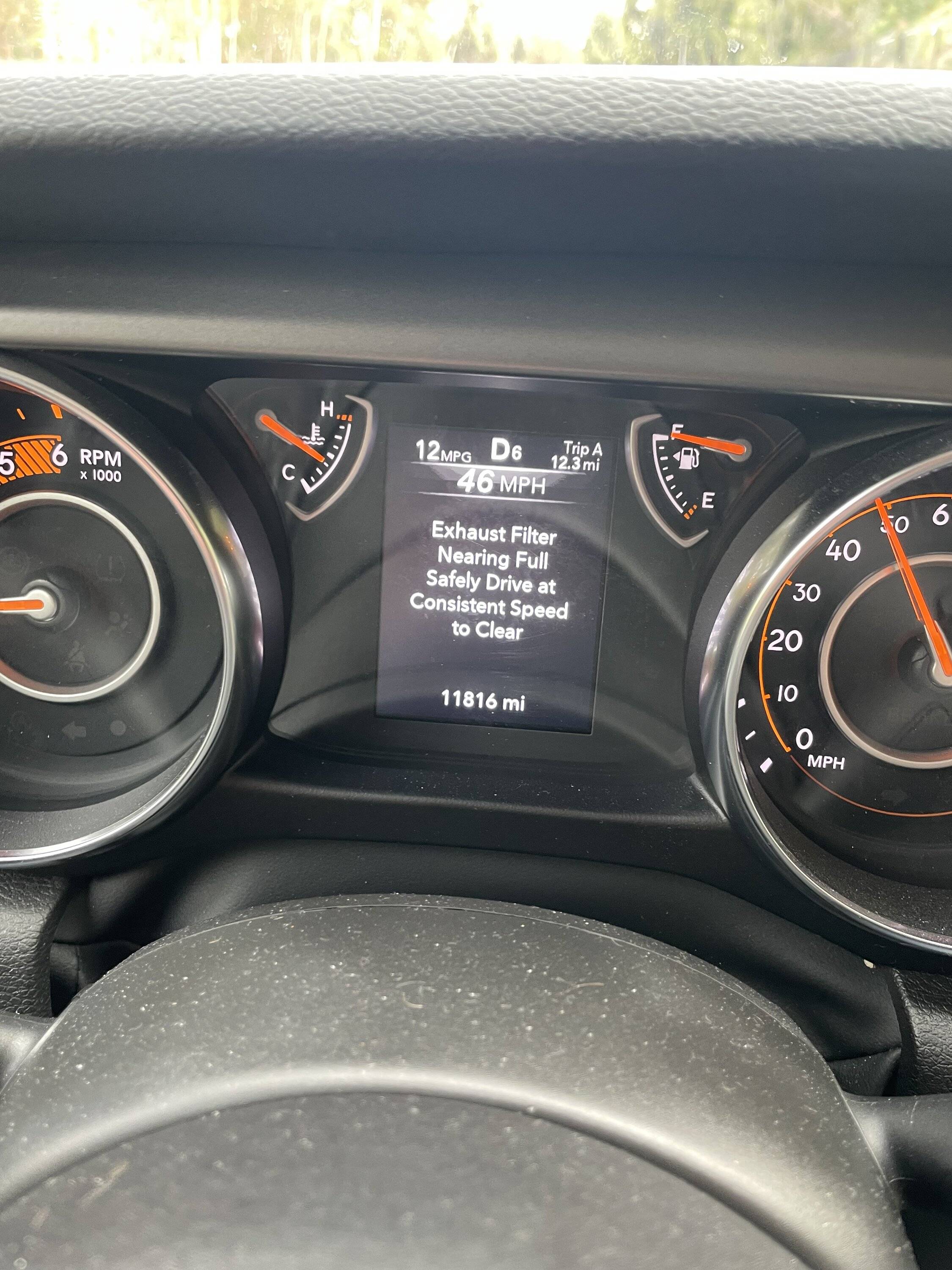

I finally got the message telling me to keep driving a regen is in progress coming home from work yesterday. For those wondering it is not a subtle one time beep. The message came up on the dash and stayed. Then every time I even slowed down a bit it chimed again to ‘keep driving’. I’m at almost 12k miles and first time seeing this. I don’t have scan gauge so havnt ever forced a regen either. It took maybe 15-20 min driveling on the freeway before it chimes in that is was complete. Here was the message:
Jeep Wrangler JL Question About Distance Between Regens IMG_2004
*Note the 12mpg was because I was driving up a hill
That's a little more of a this-is-your-last-warning message than a regen-in-process message. It means that you've shut down your engine (at 80%) so many times that the situation is becoming dire as you approach TOTALLY full. A Scangauge/iDash is really an inexpensive must for these vehicles. That way you would have seen how many aborted regens you've had.
The two must have mods for this engine are a Scangauge and a throttle enhancer.
Ok. I always take a second before I turn off the engine with it in Park to see if a ‘Regen in Progress’ message appears but never seen anything until this.
There is no such thing as a routine "Regen in progress" message - normal regens are not announced. As I mentioned, yours was a last ditch warning, not an alert. You'll really enjoy your diesel better with a Scangauge. [I know, Jeep should have made it standard equipment. :)]
