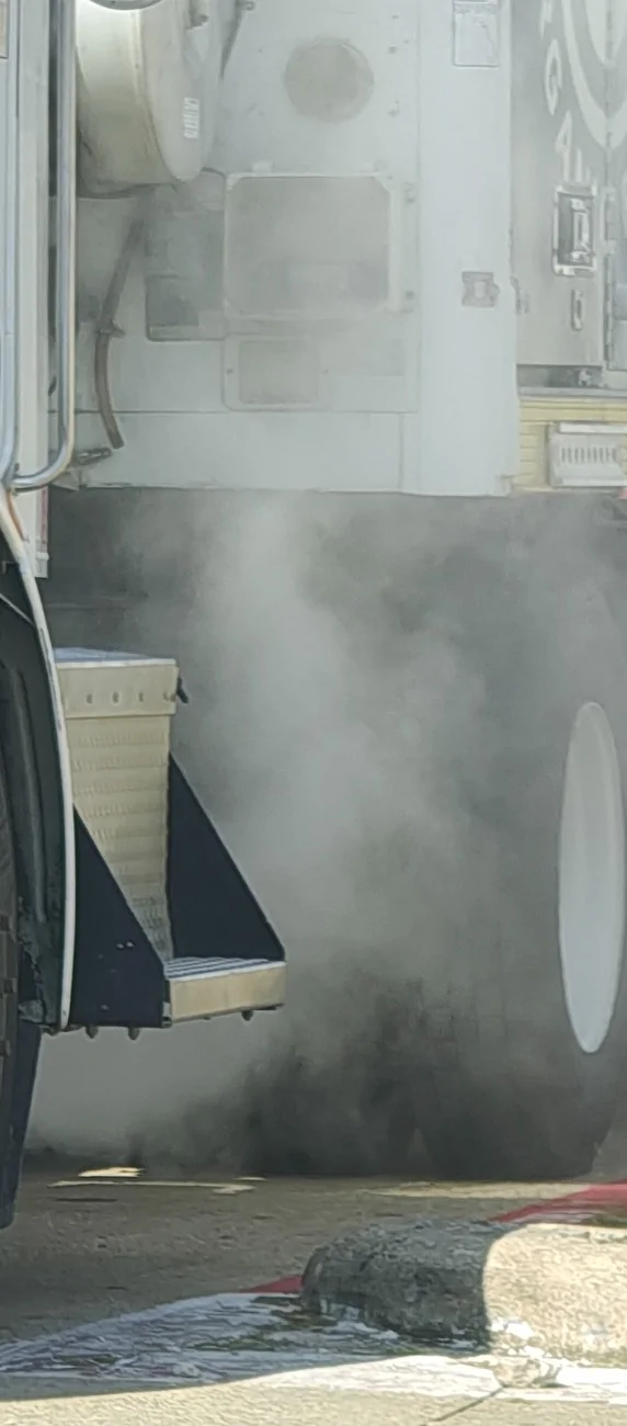

Jeep Wrangler JL Confusing Misinformation About Diesel Regens 1000014625
The Tractor with the route I'm on at work today is doing a Regen, and I'm trying to explain to the driver why we shouldn't be down stacking beer in that plume of noxious gases. He's telling me it's just water vapor and nitrogen gas which for the most part is harmless to humans.
I was trying to explain to him that there could also be ammonia gas in there.
It's one of those things where the people selling the idea that regens are actually good for the environment, aren't telling you the whole story.

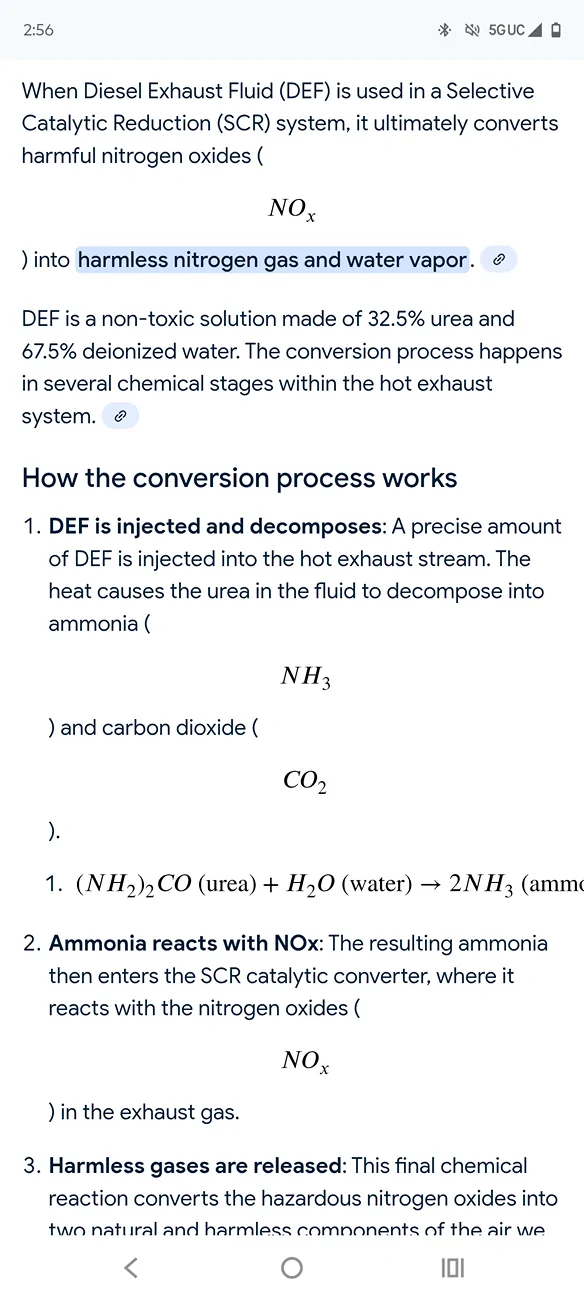

If you do a Google search for what the runoff of a Diesel Regen is, you might get an answer like this:
Jeep Wrangler JL Confusing Misinformation About Diesel Regens 1000014623

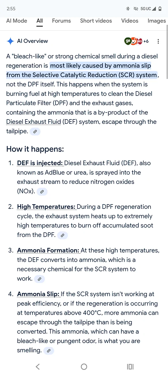

However if you've ever experienced firsthand the gas that comes out of a diesel's regen cycle, and you ask Google a different question that should result in the same answer, but doesn't, your search result might look something like this:
Jeep Wrangler JL Confusing Misinformation About Diesel Regens 1000014621
The simple answer is, not all of the ammonia from the urea / DEF process is going to burn off during the transference process. In fact quite a bit of it can reach your lungs if you breathe in this smoke. Don't believe me? Next time your EcoDiesel is regening, without breathing, go put your face over by the exhaust pipe. Not in direct path of the exhaust flow, but just off to the side will do the trick. The second your eyes start burning, and if you breathe in any little bit you'll start coughing... THAT'S AMMONIA!!!

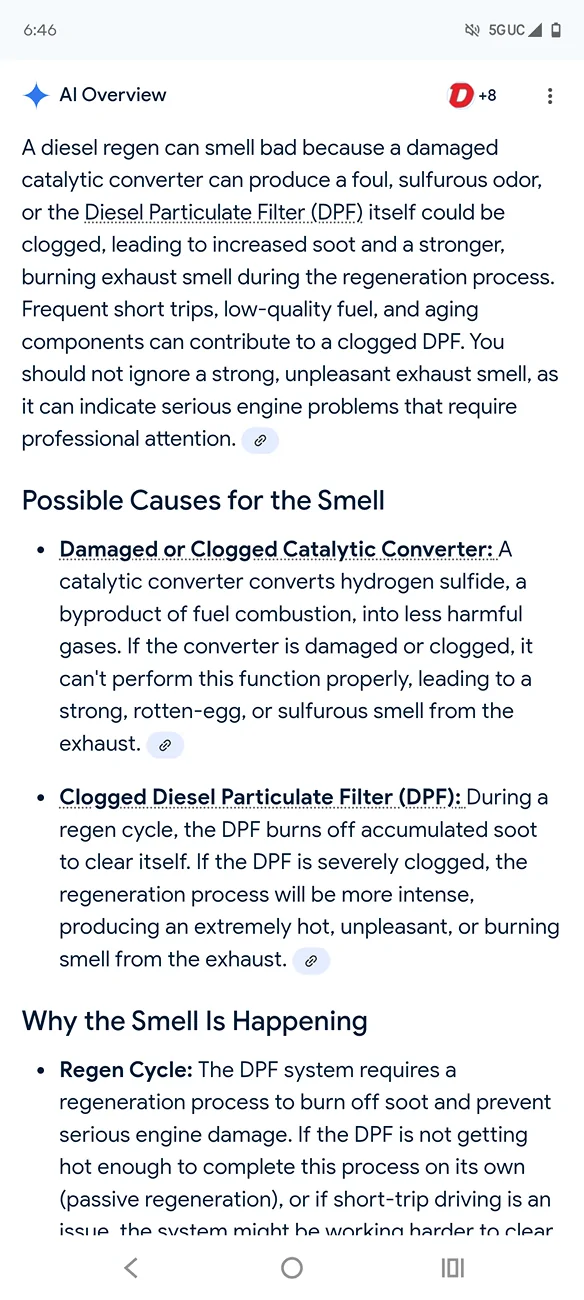

Yeah in general the whole thing isn't as safe and healthy as they want you to believe. The reason I said it smells like bleach, is because it has a very strong, sharp, choking smell to it, but you can't ask Google "Why does my diesel regen smell like choking death?" If you were to, you would get response like this:
Jeep Wrangler JL Confusing Misinformation About Diesel Regens 1000014651
None of which tells you any of the information I provided above. That's the downside of search engines, depending on the quality of your search terms, you'll get a varying degree of helpful responses. My "bleach" related search provided a direction for me to go with scientific data. So whether you like the smell relation or not, it provided the correct information in the end.
Also too, the amount of ammonia in window cleaner is pale and comparison to the amount you will be inhaling if it gets into your cabin. I would be apt to say that most people don't have a full understanding of what ammonia smells like. Which is why hanging out by your tailpipe while it regens is such a great idea. :CWL:;)
