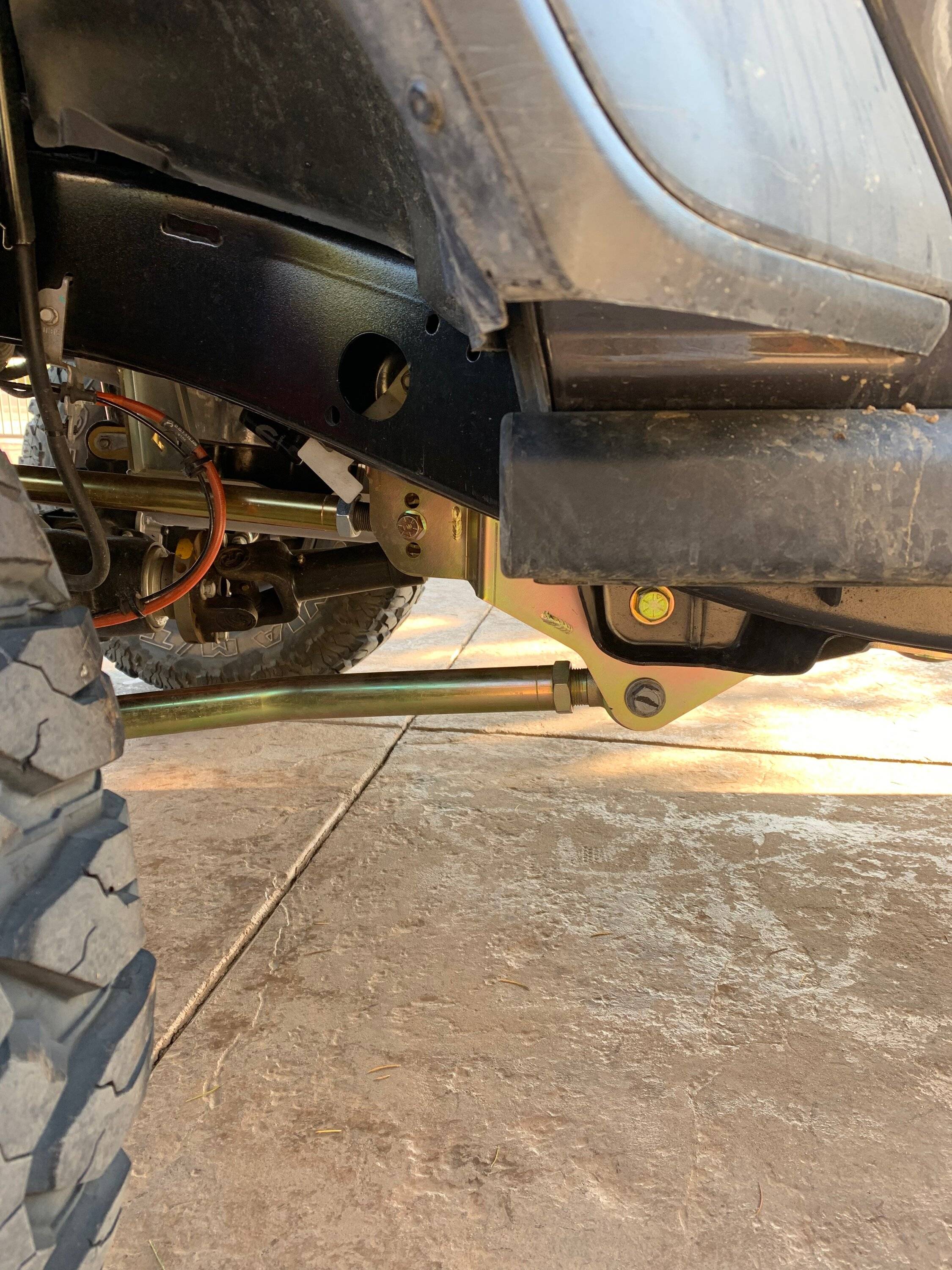

I had the MetalCloak lower control arms installed today at an alignment shop. So far it doesn’t seem like it’s really changed any of the drifting wander loose steering issues I was having. It did however eliminate the vibrations I was getting at around 50-60 MPH. I’m thinking the caster is is to low as it’s listed at being 4 degrees. Any suggestions ?

Isn’t the jam nut supposed to be on the frame side? And why did they zip tie the brake line bracket to the control arm? I don’t think those are installed per Metalcloak instructions.

First of all your Metalcloak lower control arms are installed backwards. The adjustment bolt goes towards the center of the jeep and the fixed bushing goes into the axle. You need to have the shop swap the arm locations and rotate them into the right orientation. Second you need to add more caster. 6 degrees seems to be the sweet spot between improving the JL's driving characteristics and not exacerbating pinion angles (can create vibrations) in the front end.

Ouch. They are installed backwards. They are side specific too. 4 degrees is way to low, aim for 6 degrees. Paint mark those control arm bolts...I bet they are not torqued to spec, and may back off.

Apparently the installer didn't read the instructions.
