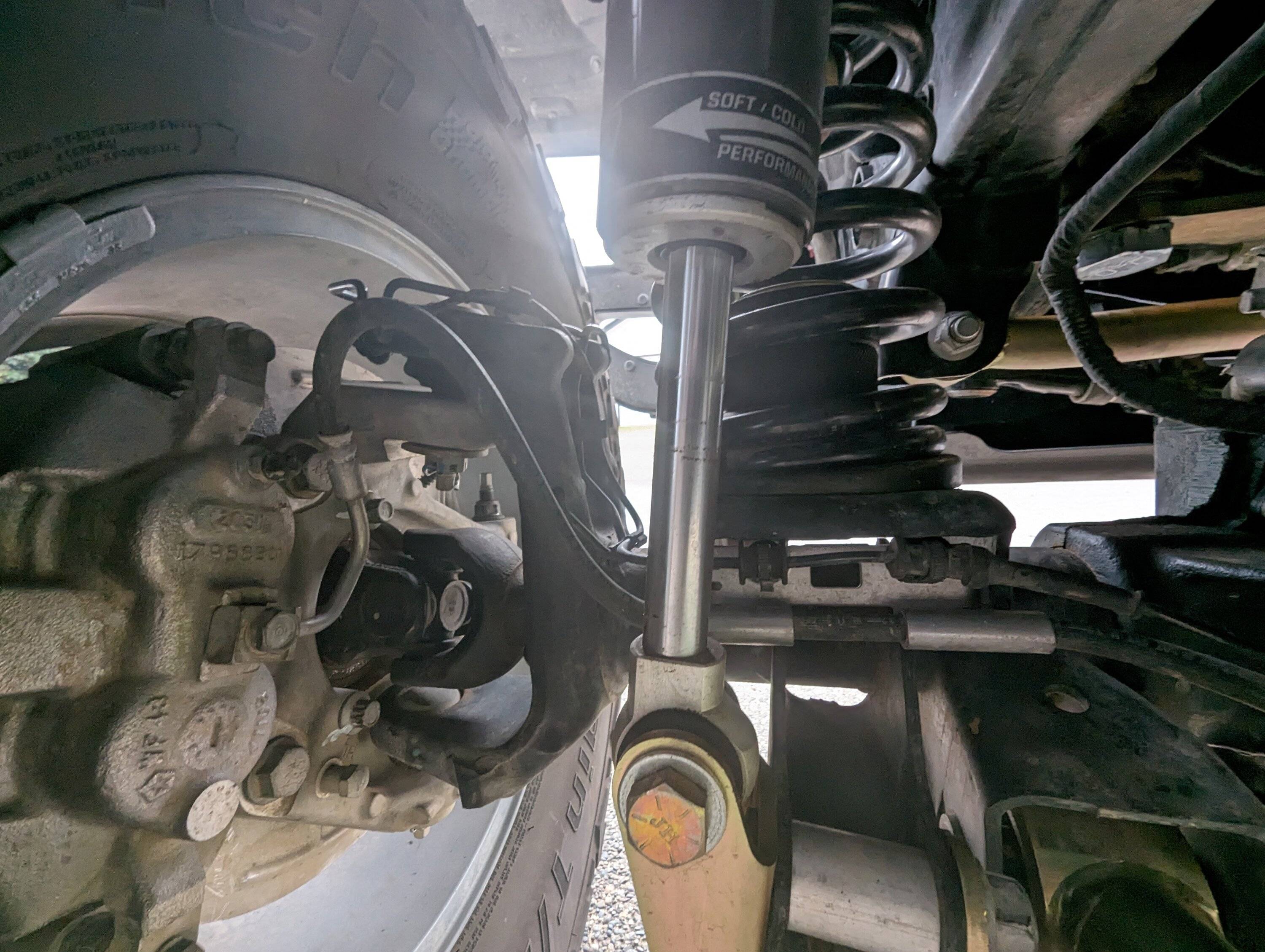

Ok so I'm almost "done" installing the front in my 2024 4xe JLRU. I have a few questions. 1st what do I do with the bottom brake bracket? I know the top one I leave screwed in and the middle one I pry off but what happens to the bottom one? You cannot screw it back into the knuckle because the front LCA drop bracket goes into that hole. Do I pry that off too (see below)

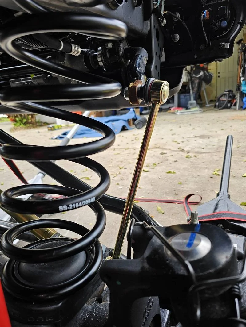

2nd question is do my sway bar looks like very crooked? Should I have mounted them to the inside of the sway bar?
Cut the bracket off, and put the axle at ride height and see if it straightens out…..

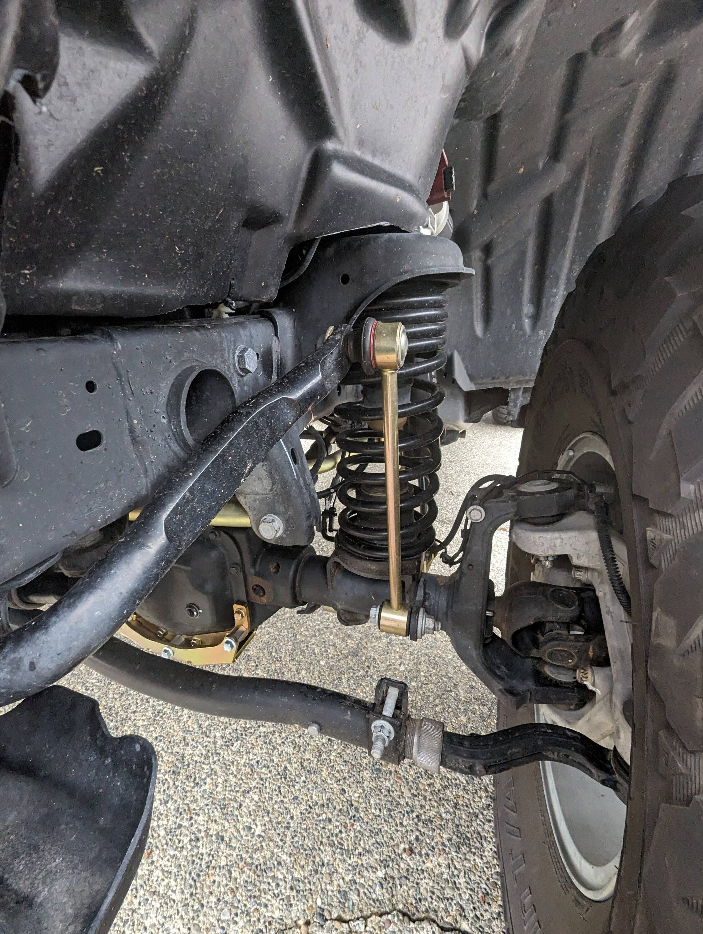

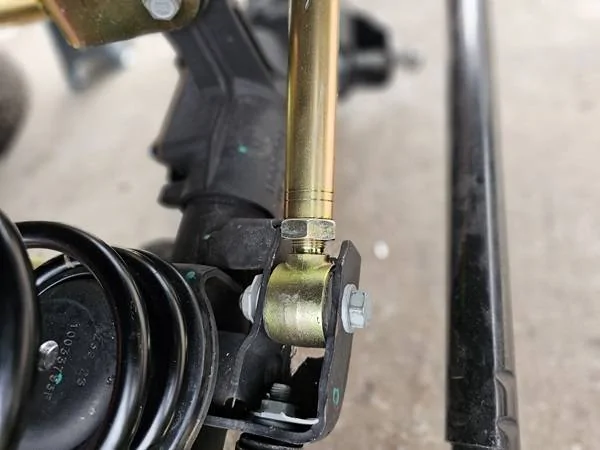

The brake bracket goes back where it was. See attached pictures.

And here are my sway links for reference.

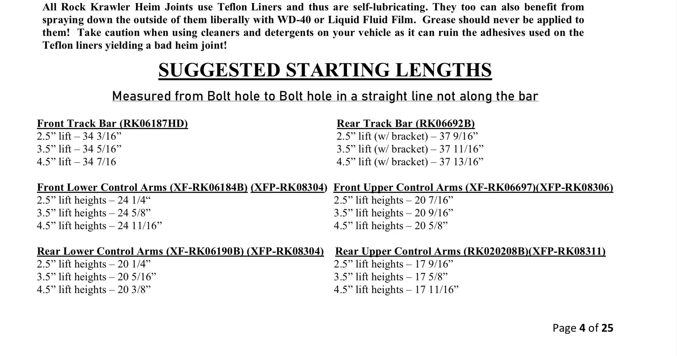

So I think my whole axle is shift way to the drivers side. I guess I ratched it too much to get the track bar in and didnt lenghen the bar (couldnt find the spec). So should i disconnect track bar and increase length?
Start with 34-3/8” you’ll still have to dial it in but that will get you close enough to start with….

2.5” or 3.5” lift? In my 3.5” GC I used the starting lengths for the Rock Krawler 3.5 and caster and track bar length turned out to be spot on up front. The only adjustment I had to make anywhere was the rear track bar (probably because I’m not running a rear track bar bracket). Mine is a 2.0 Rubicon btw.
3.5" Where did you find the rock crawler specs
