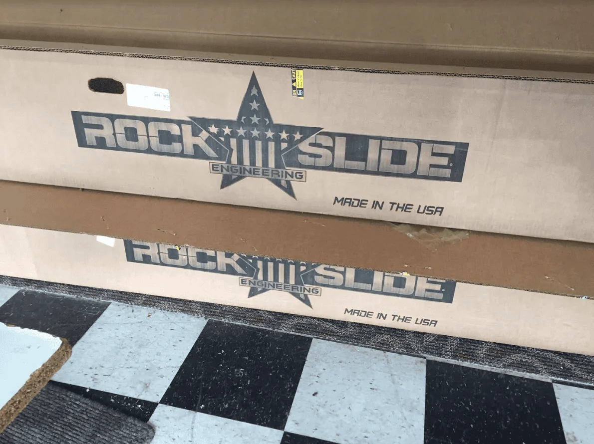

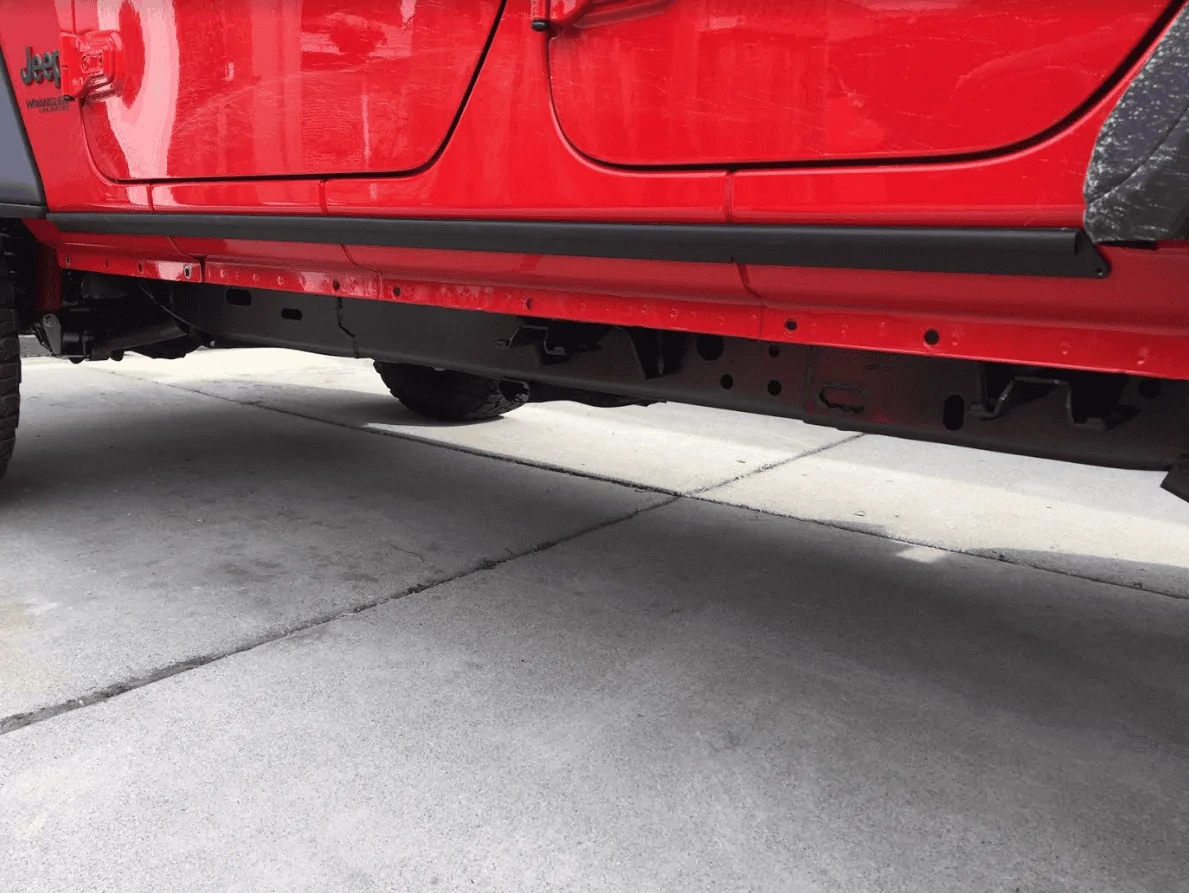

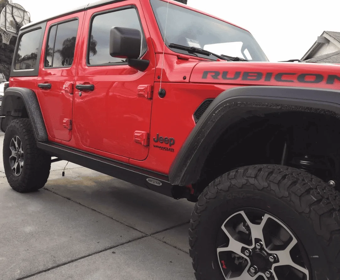

The body bolts did not end up being too much of an issue. Once you give them a half turn each direction to get some friction in there, they free up fairly easily. Just repeat the process throughout if needed (half turn in, full turn out) until free enough to get the bracket in there.
Also had to work the threads above the washer with a file on a couple but was just a bit and was then able to 'influence' them on.
Physical install was overall easy though.
Then I plugged it in :(
Got to the part that you plug the fuse back in and it immediately blew. Checked the switch and it was fused shut (no longer rocked off and on). I tested the switch prior (physically) and the button was fine, so it took some juice and fused itself shut.
Will give them a call in the morning and go from there. Would really love to try another fuse and switch but I'll just wait to talk to them first.

Yep, was just the switch. Found another and replaced it and the fuse. Presto working. Done.
Real happy with the steps. The are a little on the thin side for my wife but she says she will get use to them. Agreed!
