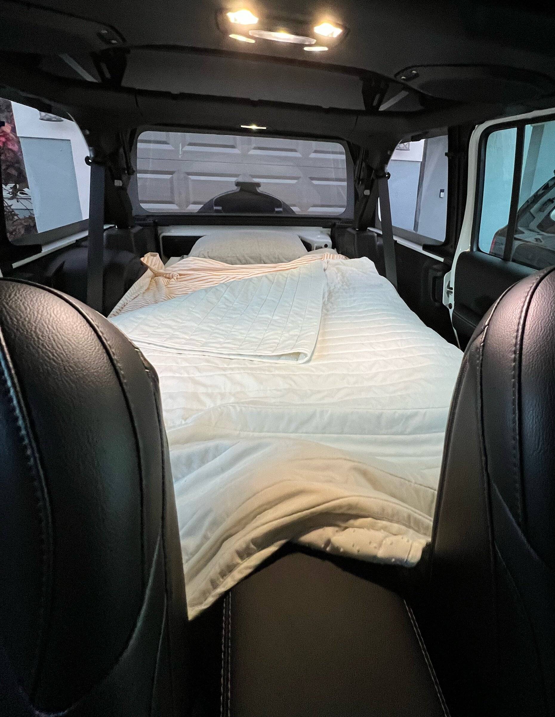

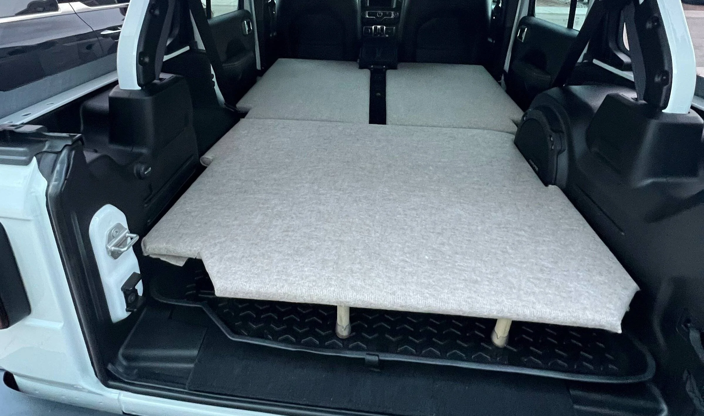

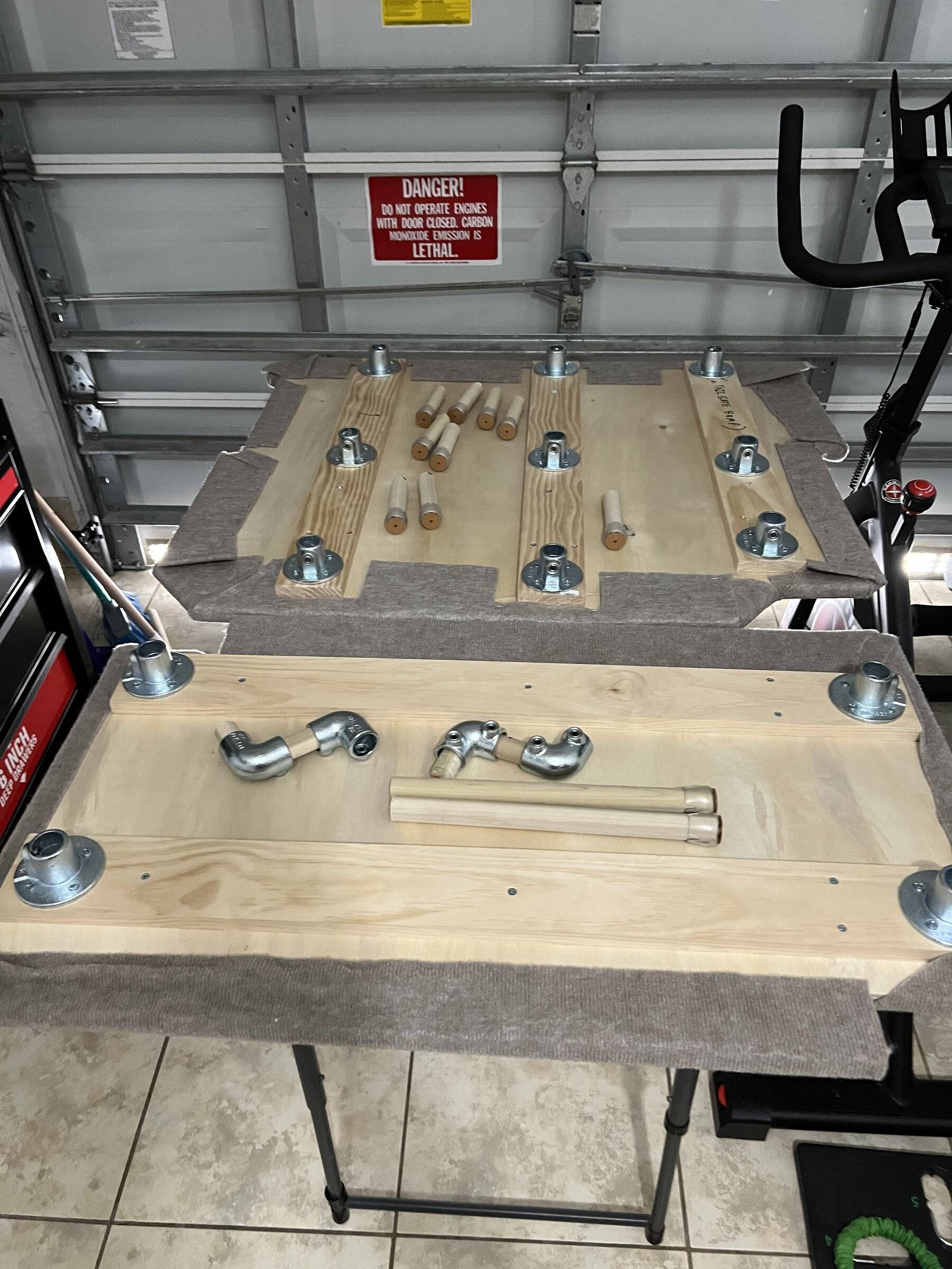

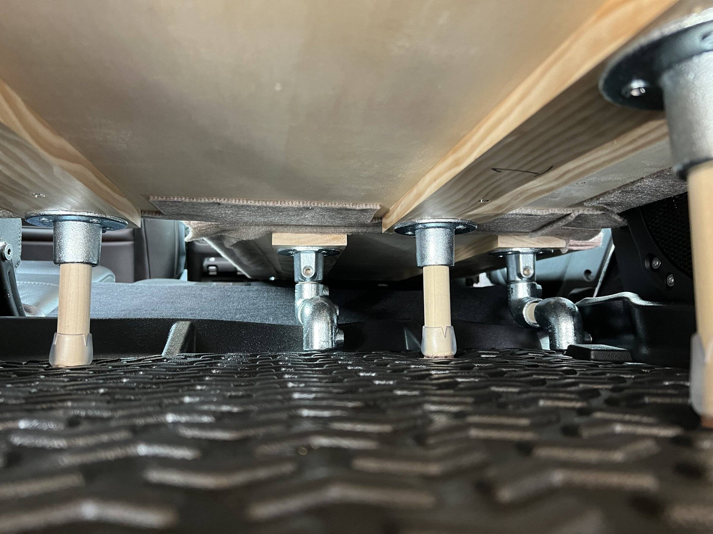

The creator of this thread inspired me to try building something similar. It turned out well and I learned a lot. I used the same Steeltek hardware and overall concept. It breaks down in the same way as the original poster’s. One contribution I can bring to the group is that I found a way to land the middle row’s rear supports in the cargo area using elbow joints. I didn’t want them pressing into the seats and damaging the leather upholstery.
