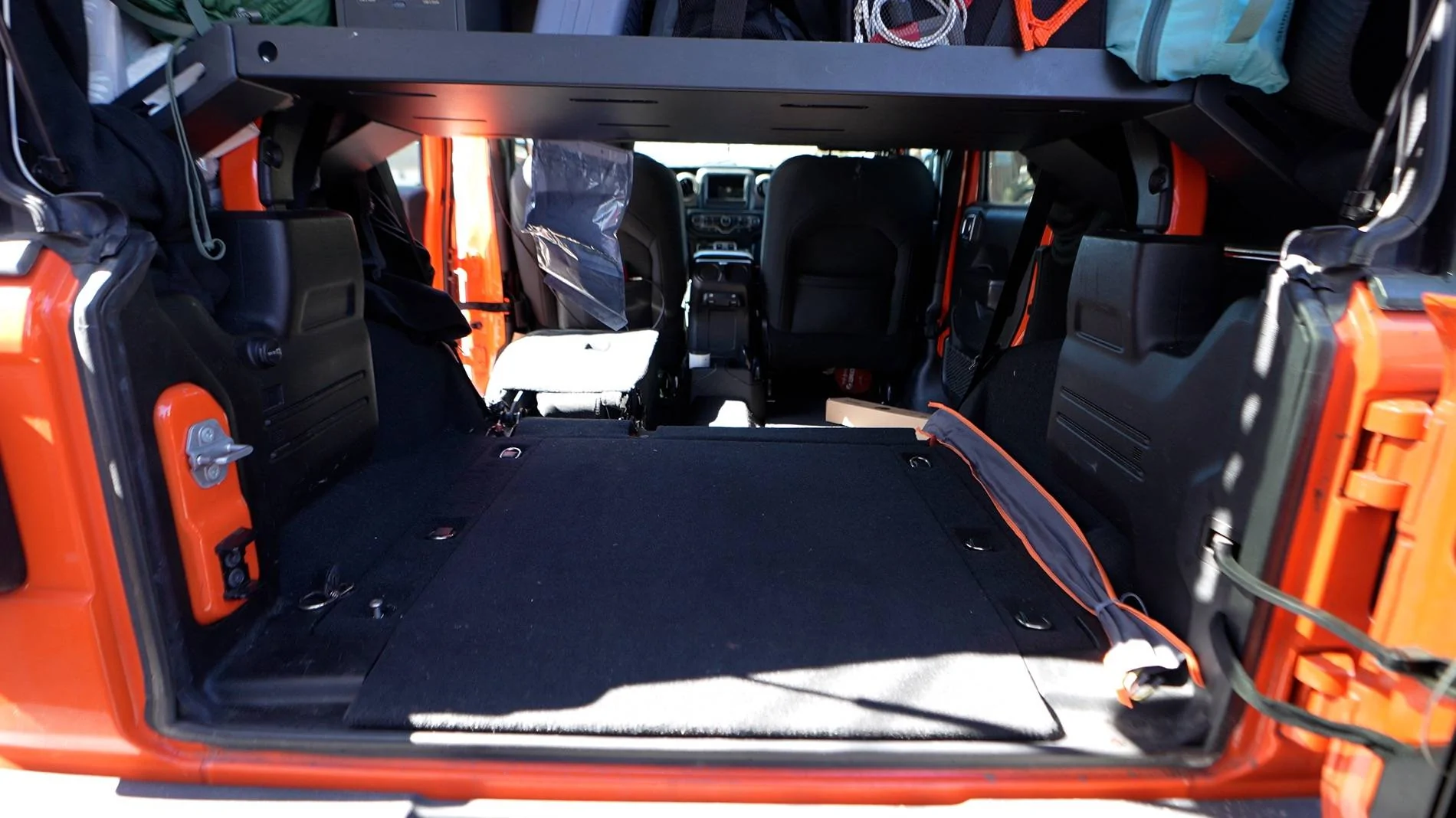

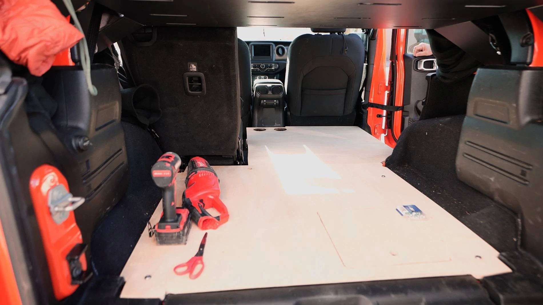

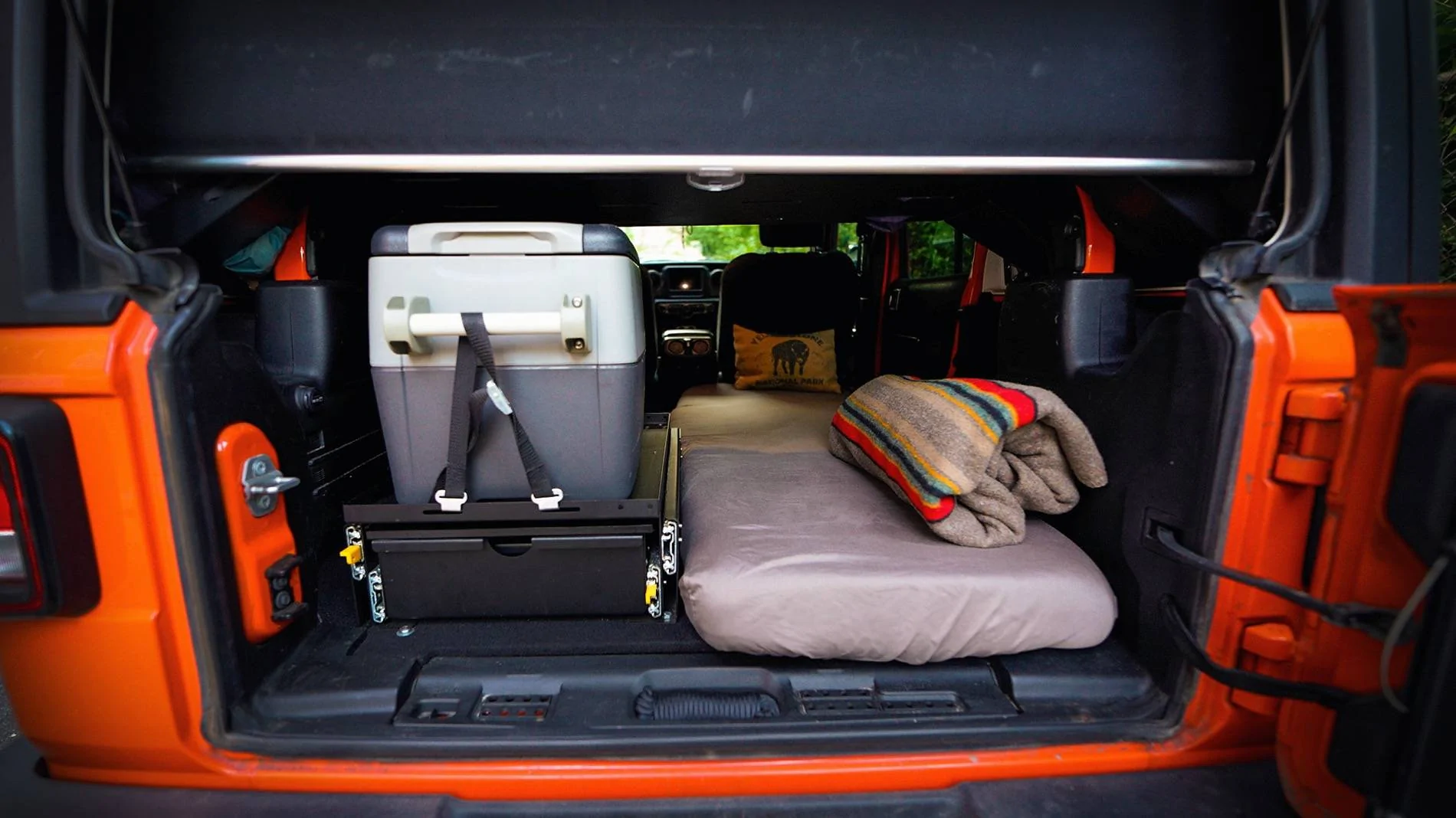

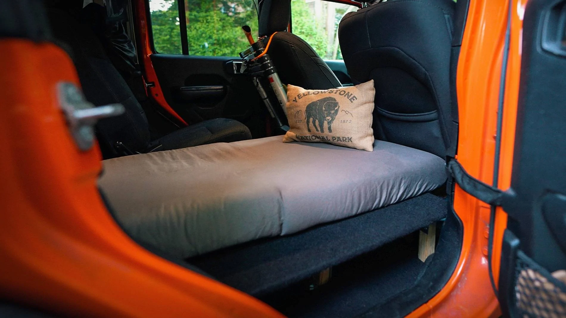

I built this relatively easy and cheap seat delete platform that I’ve been using successfully for about a year for both camping and Overlanding. I wanted to share some photos and a video on how I did the entire thing!
Materials
1/2 4X8 SANDE PLYWOOD
METRIC BOLT P/1.75 12X35 ZINC
UB88 G90 CORNER BRACE
Black Carpeting Fabric
Here’s the full how to:
