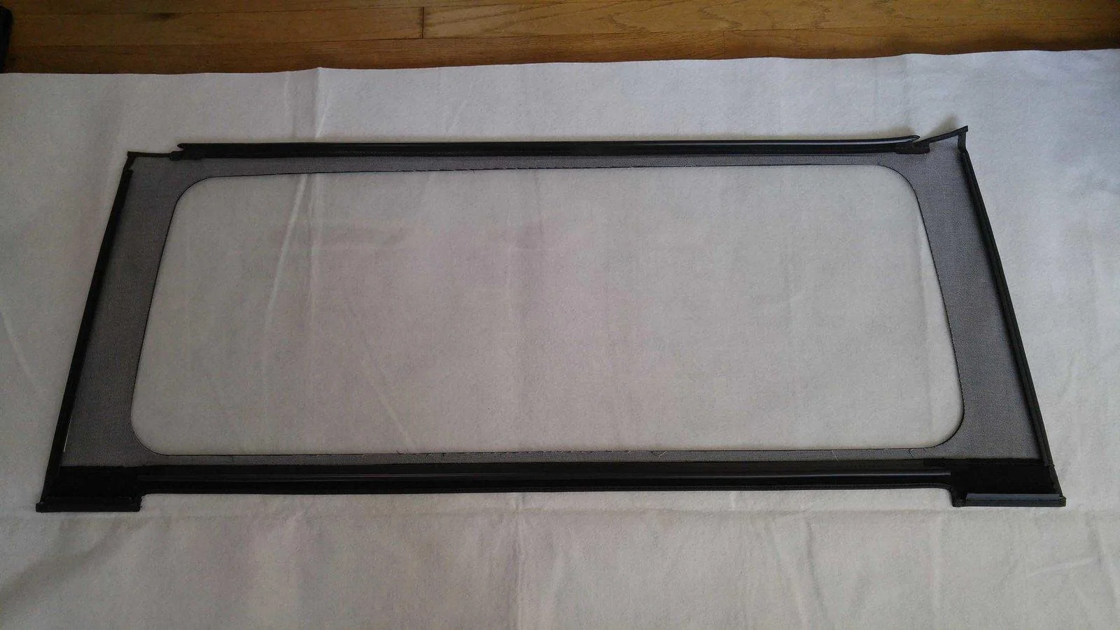

While waiting for the arrival of the Mopar Soft Top Window Storage Bag, I decided to see what DIYer could do without any sewing required. I actually found some of the same vinyl covered felt used by the Mopar bag at the local Joann fabric store. This is the exact same stuff, same as Bestop uses on their seat covers. The piece shown here is 80". You will also need a couple yards of felt for the pieces between the windows a couple of 5' nylon straps, mine are 2" wide. Vinyl was about $20, felt and straps about $10 each. I'm doing this with JLU windows, a JL will have longer side windows.
First picture is the back window centered on the top half of the vinyl.

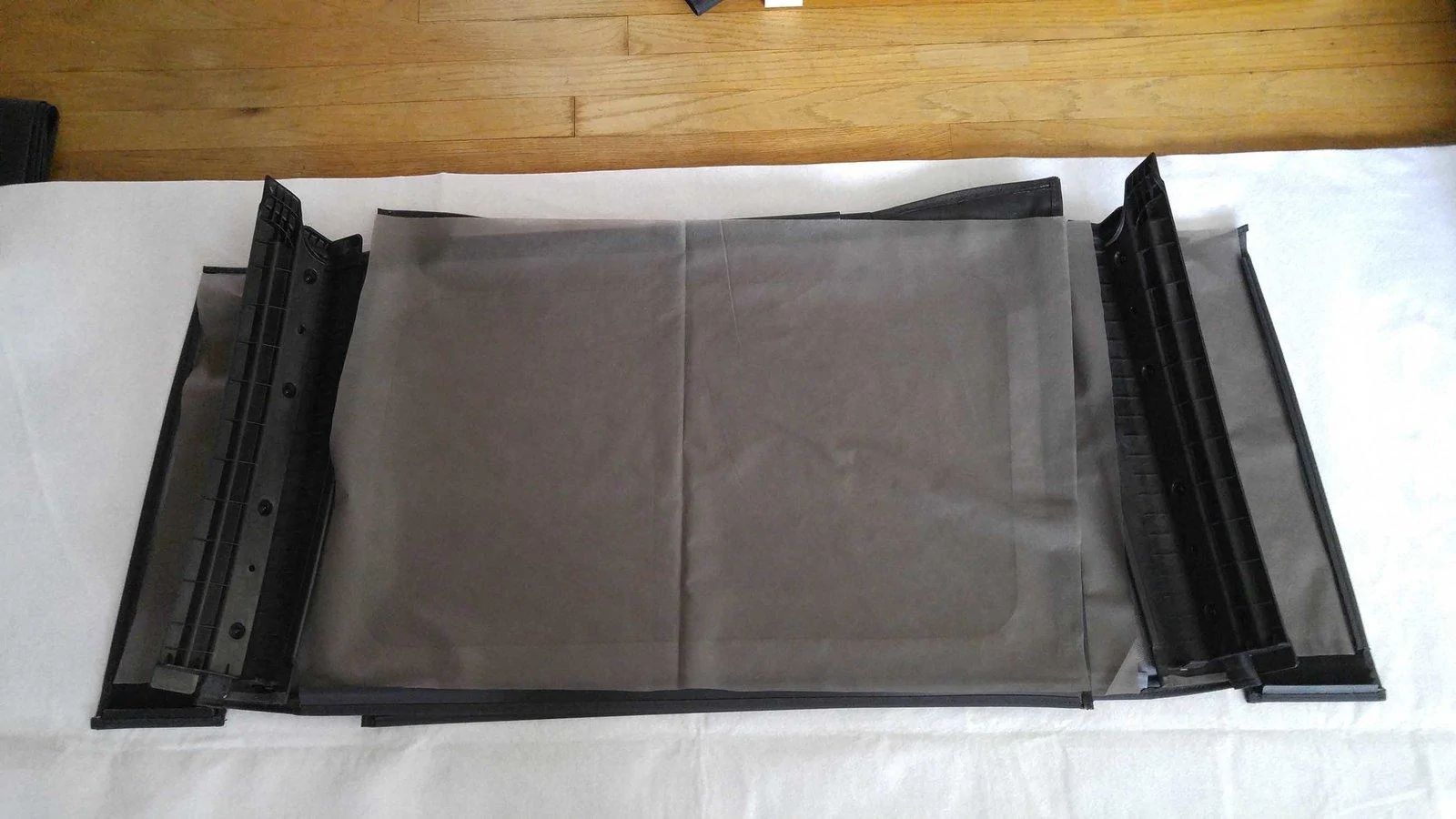

Second pic is the side windows centered on top of the back window, with felt between all the windows. The side windows are as close as they can get to each other without risking any scratches. Note the hard plastic corners, when I install the straps in the next pic, the straps are on the plastic corners. The tightened straps are not apply any pressure to any other part of the windows

Third pic is the bottom half of the vinyl folded up and the sides folded towards the middle with the straps holding everything in place. It looks a little sloppy and would definitely benefit from some trimming of the excess vinyl.

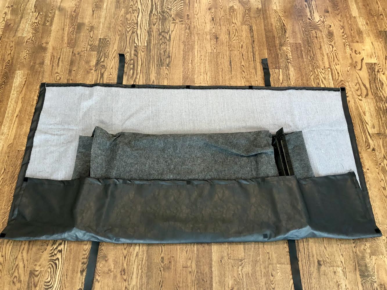

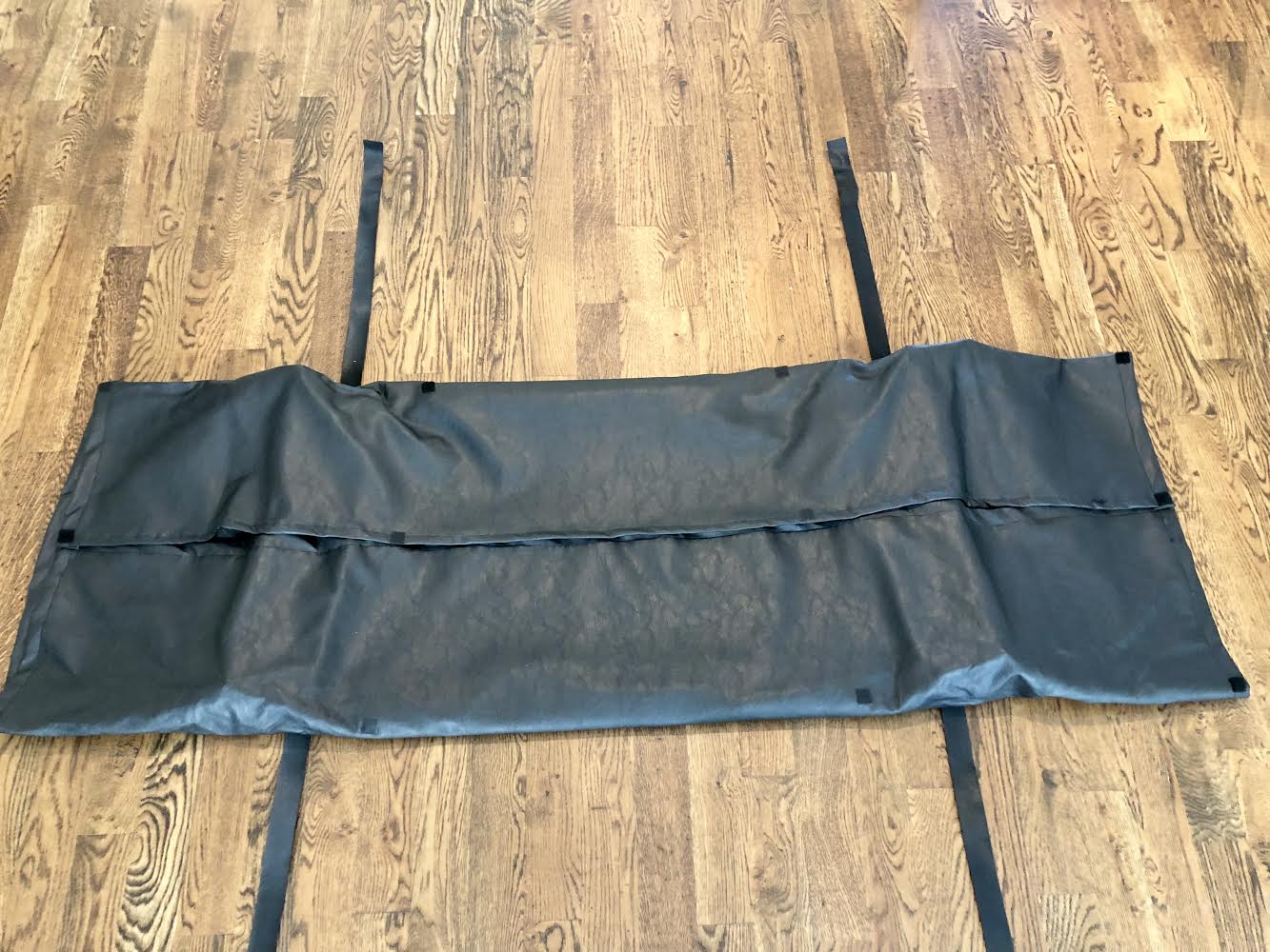

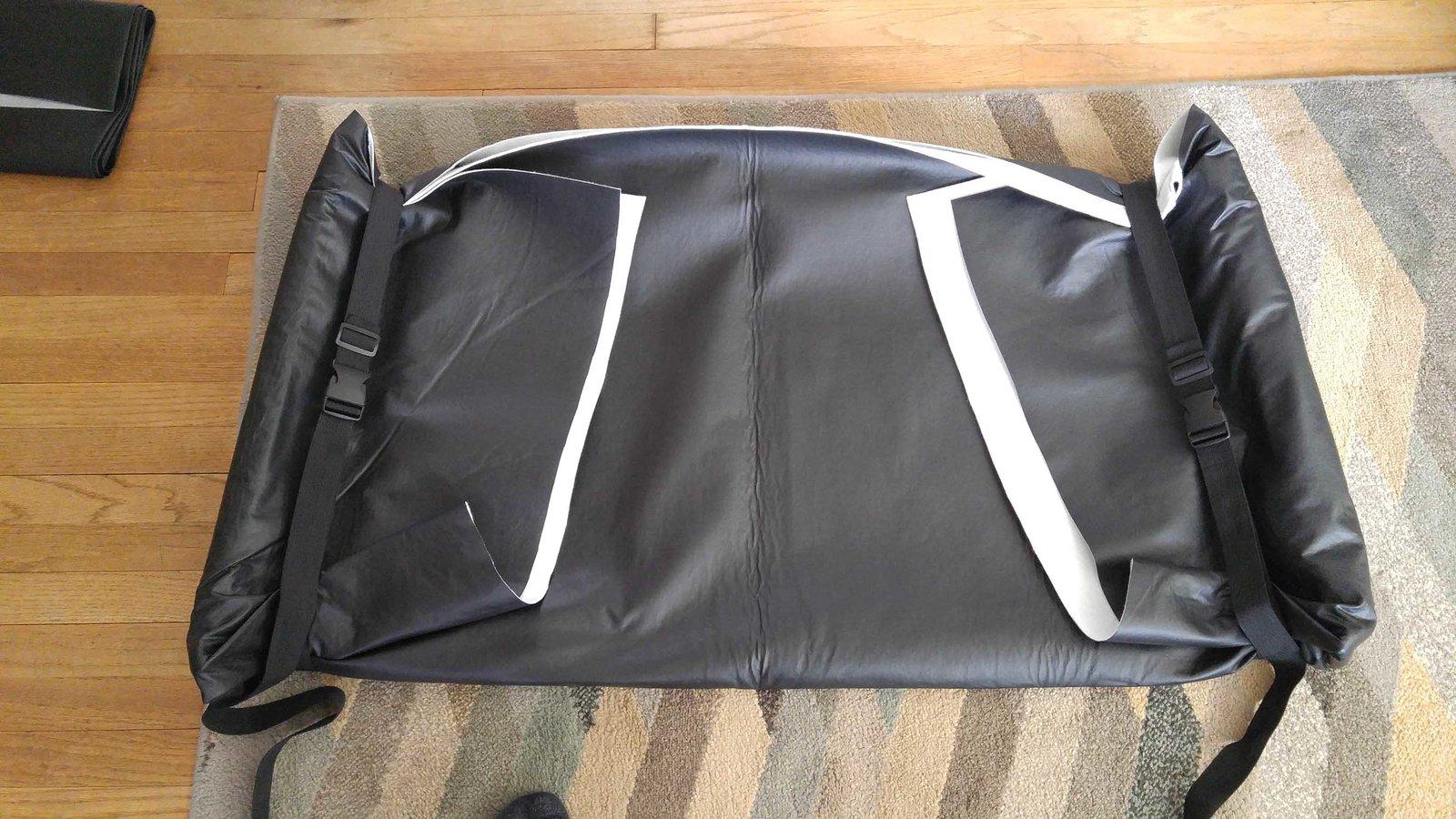

Caught some quick sewing instructions from my mother via FaceTime today and knocked this bad boy out. Fits PERFECTLY behind the rear seats of my JLU. Thank you VERY MUCH for the idea and inspiration!! BTW, I used some small self-adhesive Velcro square to secure the edges of the vinyl together once folded.

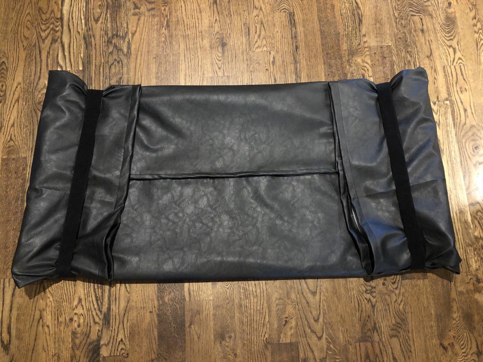

I pretty much store them as you described in your initial post-- lay down the vinyl and a layer of felt (the interior of the vinyl Jo-Ann's had was not as soft a felt), lay down the rear window centered on the vinyl, layer of felt, one side window, felt, other side window, felt. Then fold up bottom, fold down the top, fold the sides in, then strap closed. You can probably see the Velcro squares I stuck on in these photos, but now that I have some mad sewing skillzzz ;) I'm probably going to buy some sew-on strips of Velcro to really secure it closed. I have a feeling that between the hot sun and the wind from the top being down, the adhesive and smaller squares may not hold. I am also probably going to sew the large Velcro straps to the vinyl. Best wishes!

Yes, I like how easy this more flexible vinyl was to work with. And once you have the windows secured with the larger straps, they stand up nicely against a wall or your rear seats due to the rigid corner pieces of the side windows. Nice tag-team effort here! :like::fist bump:

The rear bar stays connected to the rear window and stored in here as well. When wrapped up relatively tightly with my velcro straps, the plastic corner uprights on the side windows combined with the rear bar provide nice little structure for it to stand upright leaning against the wall in my garage.

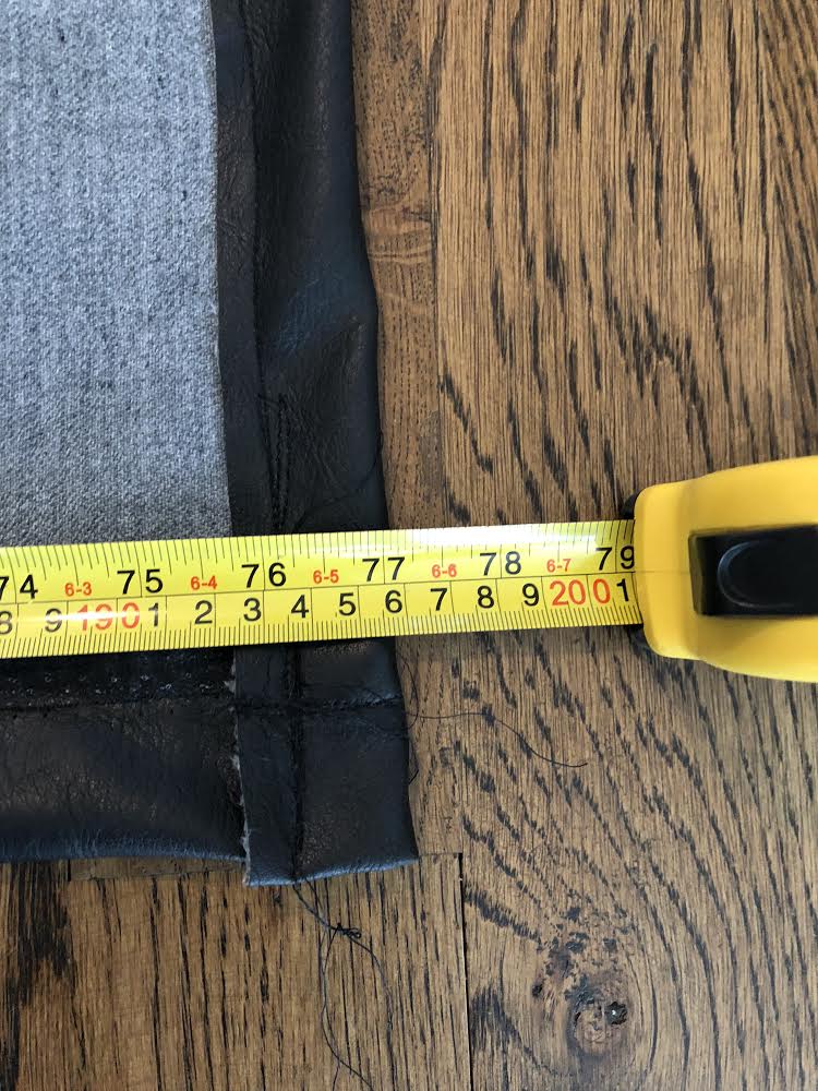

This is really awesome and exactly what I'm looking for! Are your measurements for the Vinyl 52.5" x 77"? If you have them handy, could you share the measurements you used for the felt pieces as well? I'm thinking about attempting this project over the weekend.

I know this is an older thread, but are there any updates? I was hoping to get the measurements for the material. Thanks.
