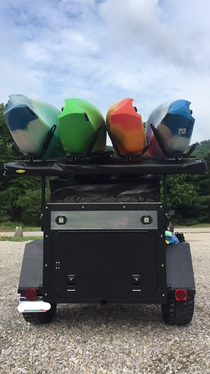

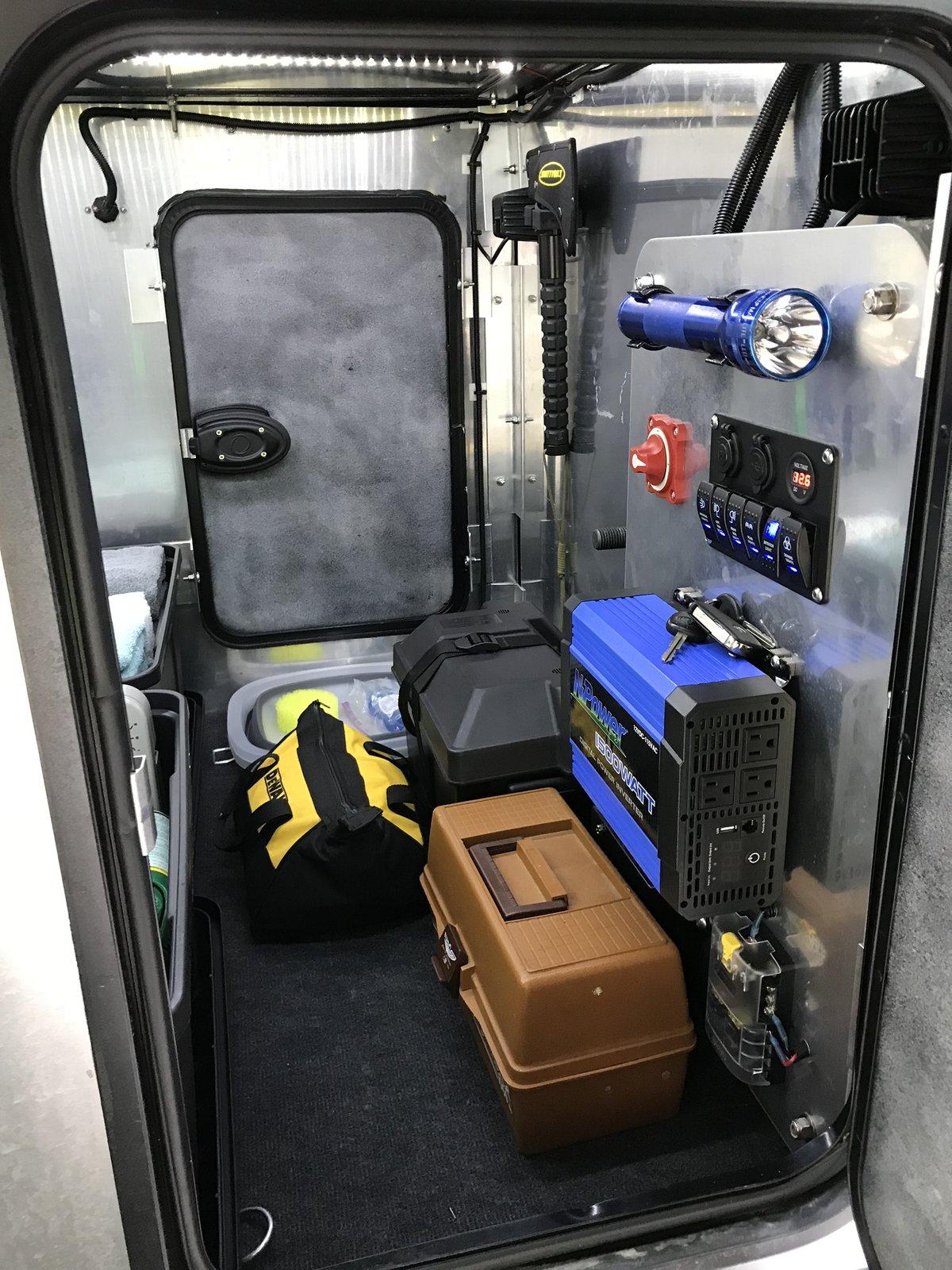

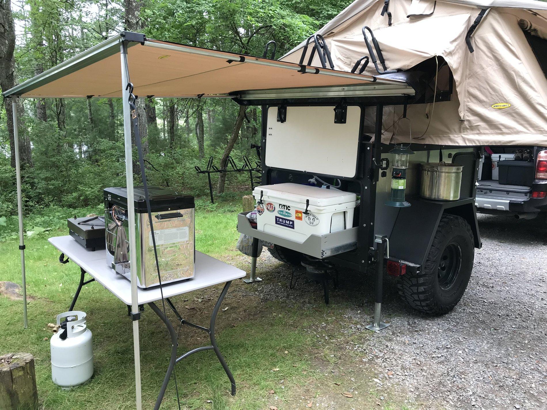

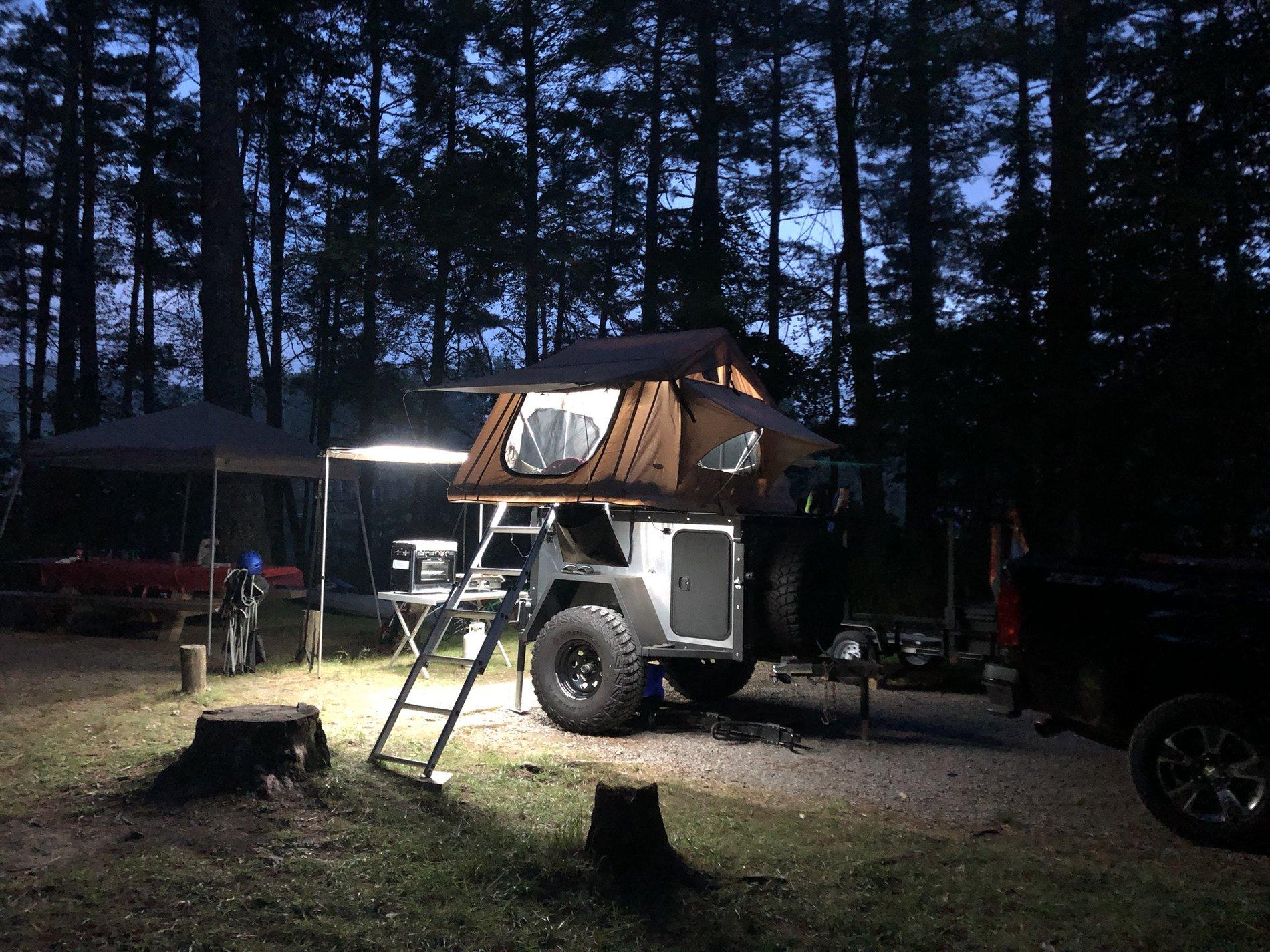

I can go super light but also built a expo/camping trailer for the cool factor of glamping. The one thing I’ve gravitated to is setting up camp then exploring in a empty Jeep.
No matter how ya go atleast you are getting out!
Would you mind giving a little more info about your trailer? This is not what I expected when adding a trailer was mentioned.
Foster_WV
Foster
Oct 6, 2019
89
204
WV
TJ & JLU
Yeah no problem, it’s 4’x6’ trailer, 35s w 3,500 lb axle. Has RTT, awning, running water, power, etc
We used the #campncrawltrailer on IG feel free any questions if u see something
