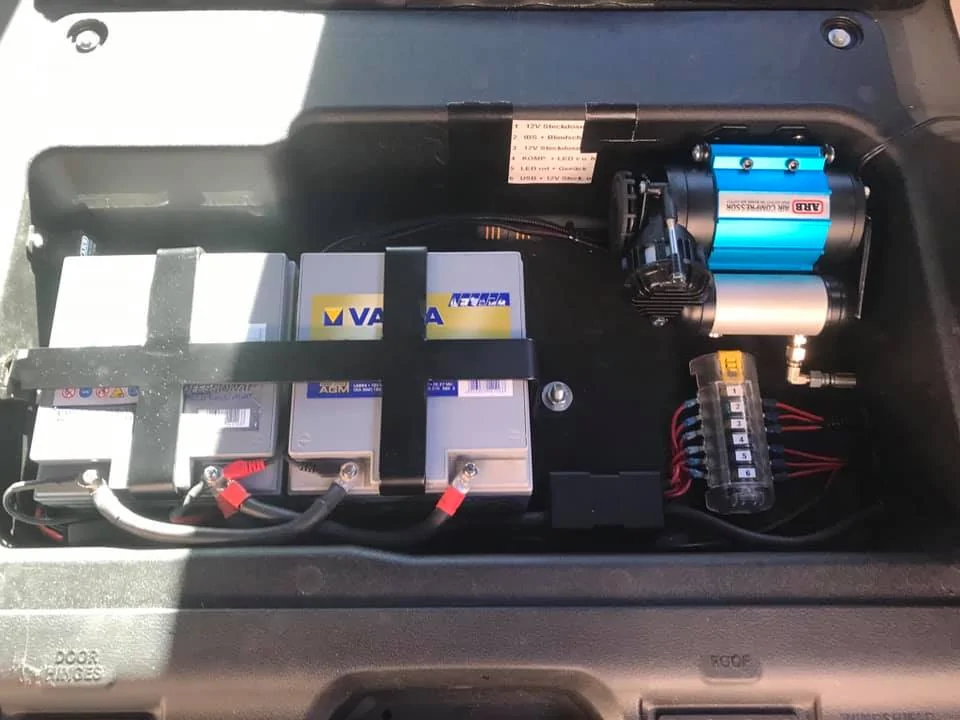

Theres a guy not he Facebook JL Wrangler Group who added batteries in the rear cubby. I'm trying to get more info from him but they charge as he drives and uses them for his fridge and ARB pump. Heres a pic of the setup. I think it would be cheaper than the Genesis unit.

Looks like there is a charge control relay in there, something like this. This probably isn't the best solution with a smart alternator. Smart alternators won't generate sufficient charge voltage under normal conditions. Battery capacity is reserved and charge is dumped to the battery during braking under alternator control. This is done for fuel efficiency. To sufficiently charge a house battery a DC to DC converter needs to be used. Something like offered by Redarc or Sterling.

Looks like there is a charge control relay in there, something like this. This probably isn't the best solution with a smart alternator. Smart alternators won't generate sufficient charge voltage under normal conditions. Battery capacity is reserved and charge is dumped to the battery during braking under alternator control. This is don't for fuel efficiency. To sufficiently charge a house battery a DC to DC converter needs to be used. Something like offered by Redarc or Sterling.
Wonder if instead of using the alternator one had solar panels on top roof rack? Then we'd be in business with a cost effective setup like that.
You can do that, but then you need a solar charge controller (MPPT is best) which costs about the same as a DC to DC. Redarc does make a combo unit for about $100 more if you want both alternator and solar charging. Victron makes some nice solar chargers.
