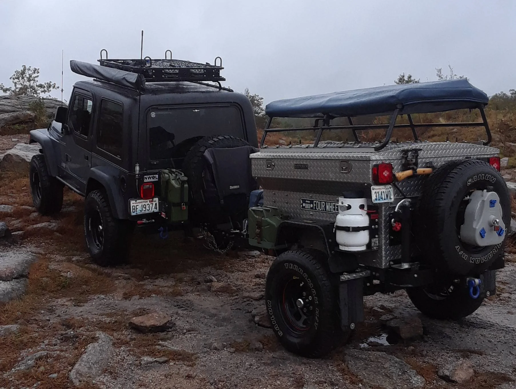

I built a small trailer for overlanding that can be pulled behind my Jeep. The base of the tub is 40" x 50" (the old WWII trailers were 40" x 72"). It is built off a modified trailer frame I got at Harbor Freight. I had the tub built by a company that makes dog hunting boxes for trucks. It has literally been across the country more than once, and up to Alaska and Canada more than once. The trailer's track width is the same as on the flatty, narrower than the TJ's, and even more so compared to the JLU. Definitely easy to thread between trees - it can go wherever the Jeep goes. I'm running a pintle-hitch set up (I also have a rotating pintle hitch - it is a NATO hitch).
There's nothing fancy about the tub - just a box with a hinged lid. I had it made tall enough so two 8-gallon ActionPackers could stack on top of each other, and the lid still be able to close. It is amazing how much stuff I can put in this lil' adventure trailer of mine.
Build thread (and then some): Mini Harbor Freight (type) Trailer Ultimate Build-Up Thread | Jeep Enthusiast Forums (jeepforum.com)
It is plenty sturdy, and not expensive to build. Send me a PM if you have any questions. If you're in the PNW and want to see it up-close, let me know. The factory slipper springs have been swapped out for real springs with a shackle on the rear, the axle is a 3500lb axle with electric brakes, and it has shock absorbers.
I've yet to pull it behind my new 23 Willys JLU. I've got the towing package, but I don't have a brake controller for it yet (I need to see if the 7-pin connector on the JLU will still work the brake lights/running lights and turn signals if there's no brake controller). But here's a picture of it behind my TJ, and behind my other Willys Jeep.
That's a Cabela's double sized tent-cot on the lid of the trailer.

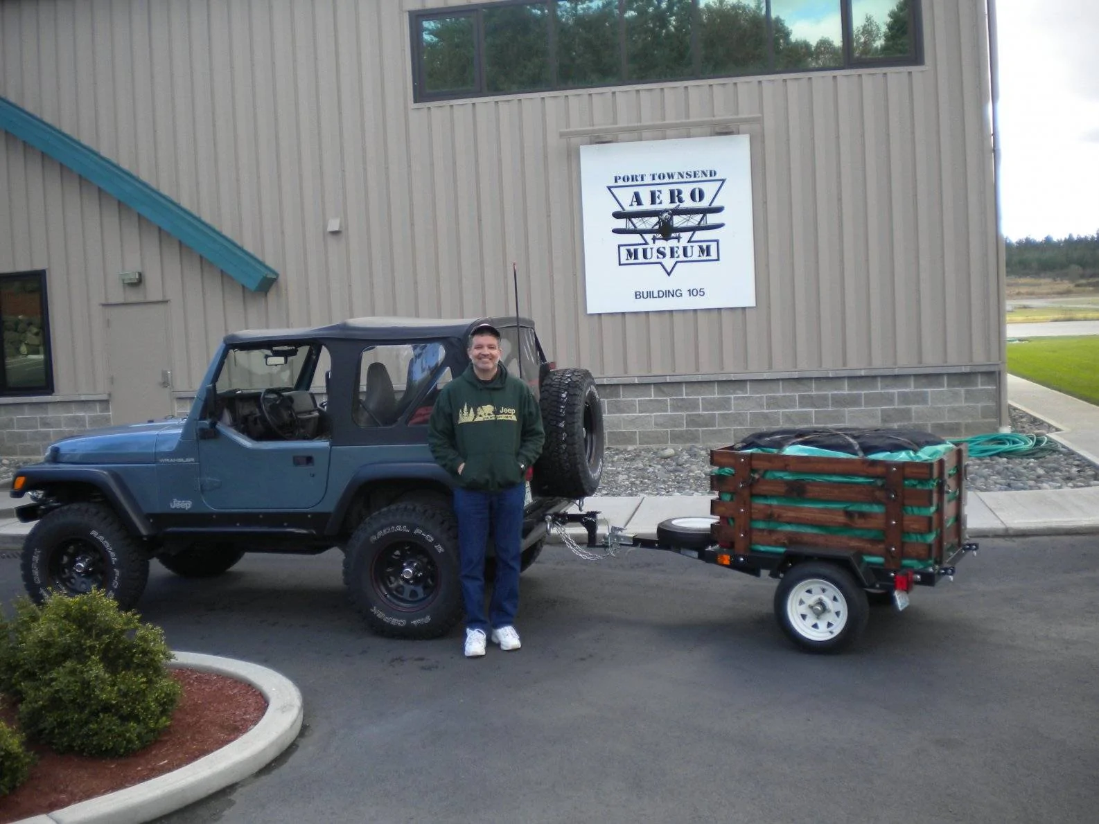

It is a very lightweight but sturdy lil' trailer. I weighed it once fully packed, and it was like 1200 lbs. My TJ is only rated to pull 1500lbs.
When I originally built the trailer, it didn't have brakes. Over the years as the trailer got built up, I decided to upgrade the axle to a 3500lb axle. Which now gave me the option of having trailer brakes. Being pulled behind a short wheelbase TJ, I figured it can't hurt, might help (sometimes on slick roads the trailer wants to tell the TJ where to go). So I also rewired the trailer for a 7-pin connector go to along with the electric brakes. I'm glad I did the electric brakes - and I think the TJ is grateful. The JLU is rated for 3500lbs. I'm sure the JLU will pull the trailer better than my four-cylinder TJ, and while I'm sure I would be "ok" pulling the trailer without the electric brakes hooked-up, it would only make things better pulling the trailer (more like when stopping with the trailer) once I get a brake controller installed on the JLU.
Here's a picture of my buddy beside the trailer when I first built it and on our first lil' trailer adventure (running the Highway 101 loop around the Olympic Peninsula). The trailer did great, but we learned a lot about trailering on that trip. The trailer was pretty much stock; factory axle, slipper springs, 12" trailer rims, and of course, no brakes. Of course, it weighed a lot less too.

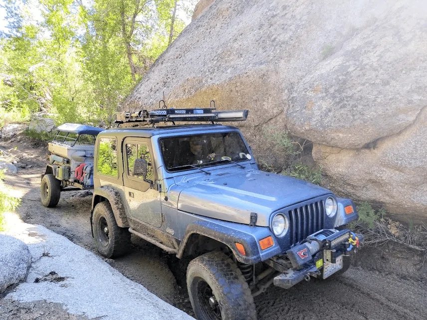

The trailer's done the WABDR, the TAT, and other overland trips (all over the USA and Alaska/western Canada). Having a lil' trailer makes things so much easier - so much less I have to pack in the Jeep. It follows the Jeep like it isn't even there. Where folks go wrong is getting too large of a trailer - one that is wider than their Jeep, weighs more than it should, and then they're limiting where they can go with their Jeep.
This picture is me and the lil' trailer somewhere in Colorado.
