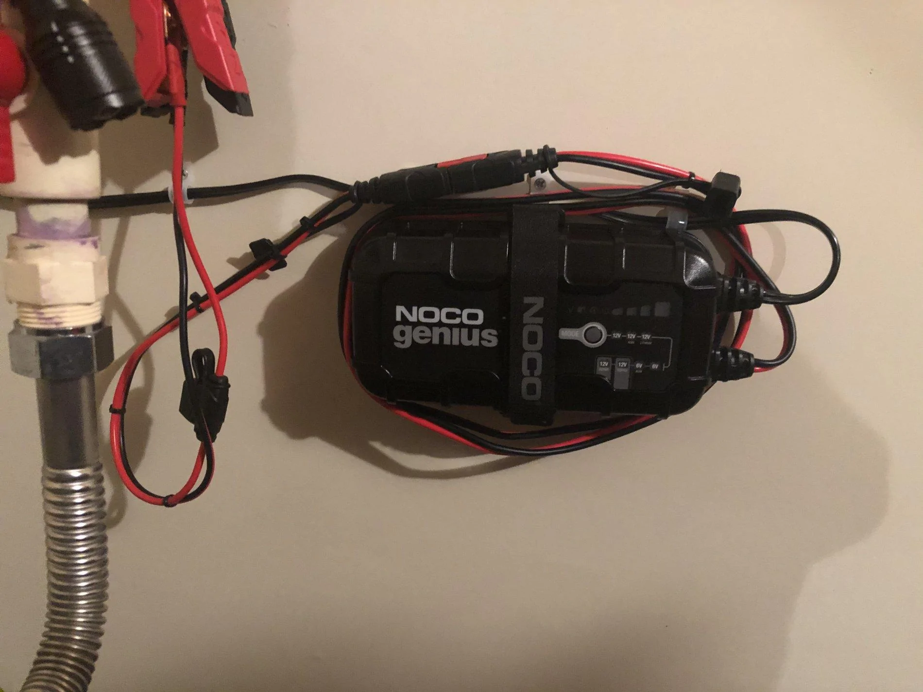

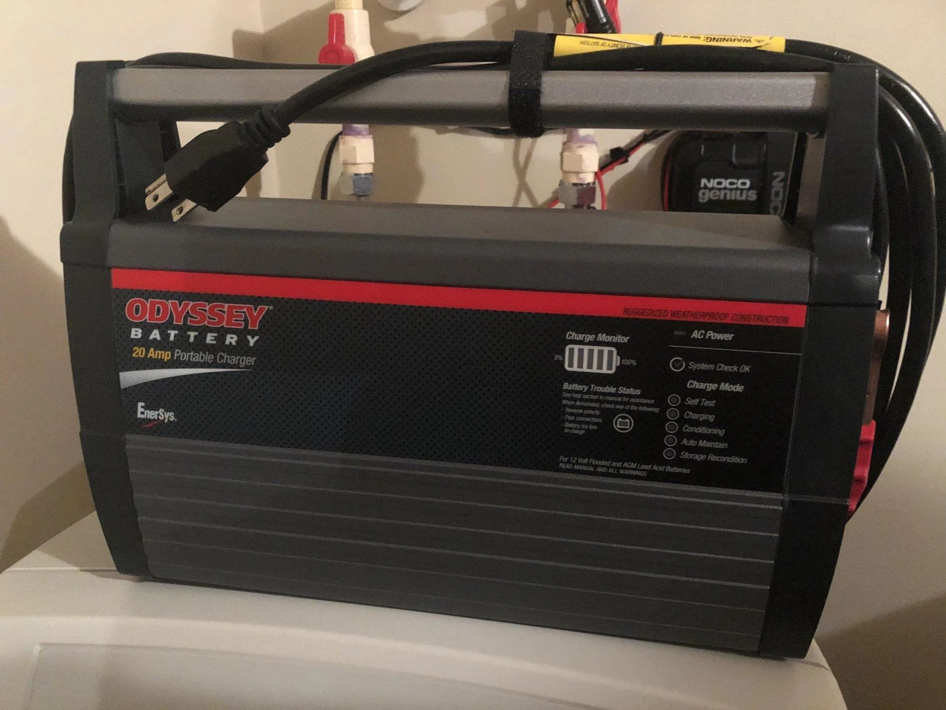

Noco 10 for the quick weekly top off
Odyssey 20 for the monthly recondition, I like the Odyssey for this as it has a deep condition cycle and it holds the voltage at 14.5 for several hours.
You know, I wish I’d paid more attention to what you’ve been saying in all these threads. This is the way. Full River, Odyssey, etc. are not the flooded lead acid batteries we group up with. As confident as I’ve been that slow and steady with a tender is the “right way,” I was confidently incorrect.
Enersys, by the way, is a wealth of information and they happily share it. Awesome customer service, and some good YT videos.
I’ve learned the hard way (thanks to covid making me a remote employee that never drives more than 10 minutes at a time) that these quality AGM batteries need a lot of current to obtain a full charge. Enersys (Odyssey/Northstar) says 40% of 20hr Ah rating is best - that’s like 30a for many of their batteries. 10% is minimum, which is like 7a for what we’d put in our Jeeps. My Noco-5 can’t do it.
My Odyssey OBC-20a should be here on Monday. I wish I’d sprung for the Noco-10 back when I bought the Noco-5, too…
