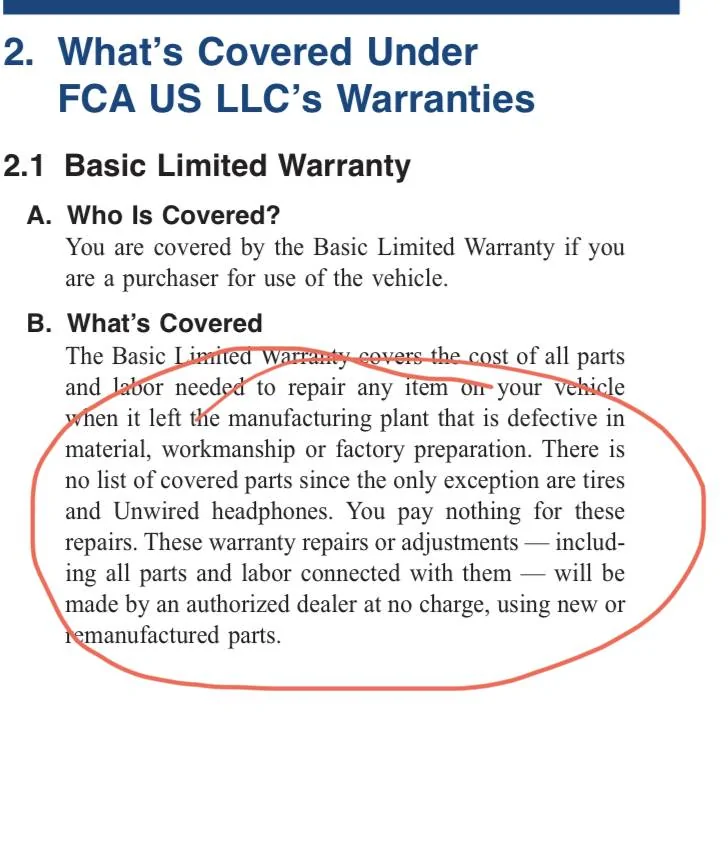

Yeah he should probably read the warranty booklet as it clearly states the only parts not covered are tires and headphones.
