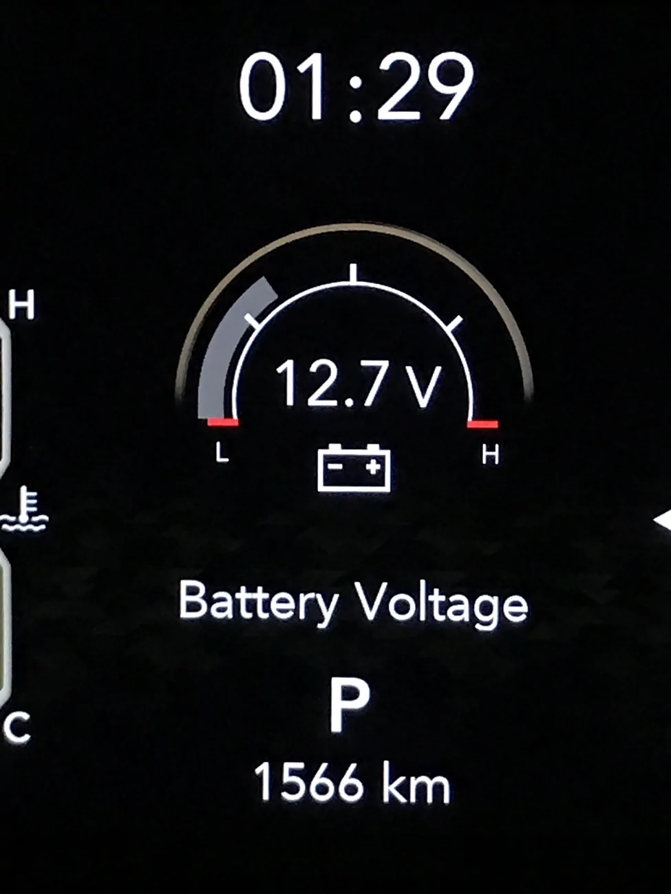

Hey guys, new to Jeep and it’s charging system. Had a failed aux battery that was dead after testing by dealer, replaced it under warranty. Considering it was dead, the whole time the power was being pulled from main, how much voltage life now would main have, and if the aux battery got replaced because it was tested as dead, should the main also be replaced coz of how power was being drained off of that for stuff the aux would have been doing but didn’t?

Starting a hot engine is not that bad on the battery. At 12.7 your battery is mint, especially you did not go like this for long at 1 500 KM on the odo. Maybe you can argue with the dealer about the wear and tear on the main battery and request a replacement, but keep in mind FCA battery are not that great. We usually see a 3 years life from them.
This is actually cold engine, I just got off work and was warming up my Jeep not even 2 min. Jeep is new(2025) but the engine light and “Avengers” symbol was lit up when I purchased coz initially it was sitting in their show room(13kms on the dash). They had a tech just reset the code so they disappeared, but that’s when my OCD said that’s not fixing the problem, that’s when I had forced the issue for them to test the battery. My OCD lit up again when I noticed the cover panel in front of the gear shift was open(where the pull lever is to disengage gear so you can put in “N” to be able to tow or move Jeep if it’s stuck), is this some reason to be opened if there’s battery issue?
Also my previous Jeep(2024)was holding 14.0 even up to 2yrs. of owning it.
14.0 is actually the alternator supplying voltage to charge the battery. the battery itself is 12v.
When cruising you should see 13~14.7. I suspect the 12.7 was during a stop where the engine was shut off.

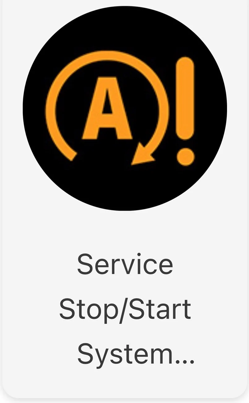

"Avengers" symbol?
ESS Warning <——> Marvel Comics Avengers Logo
