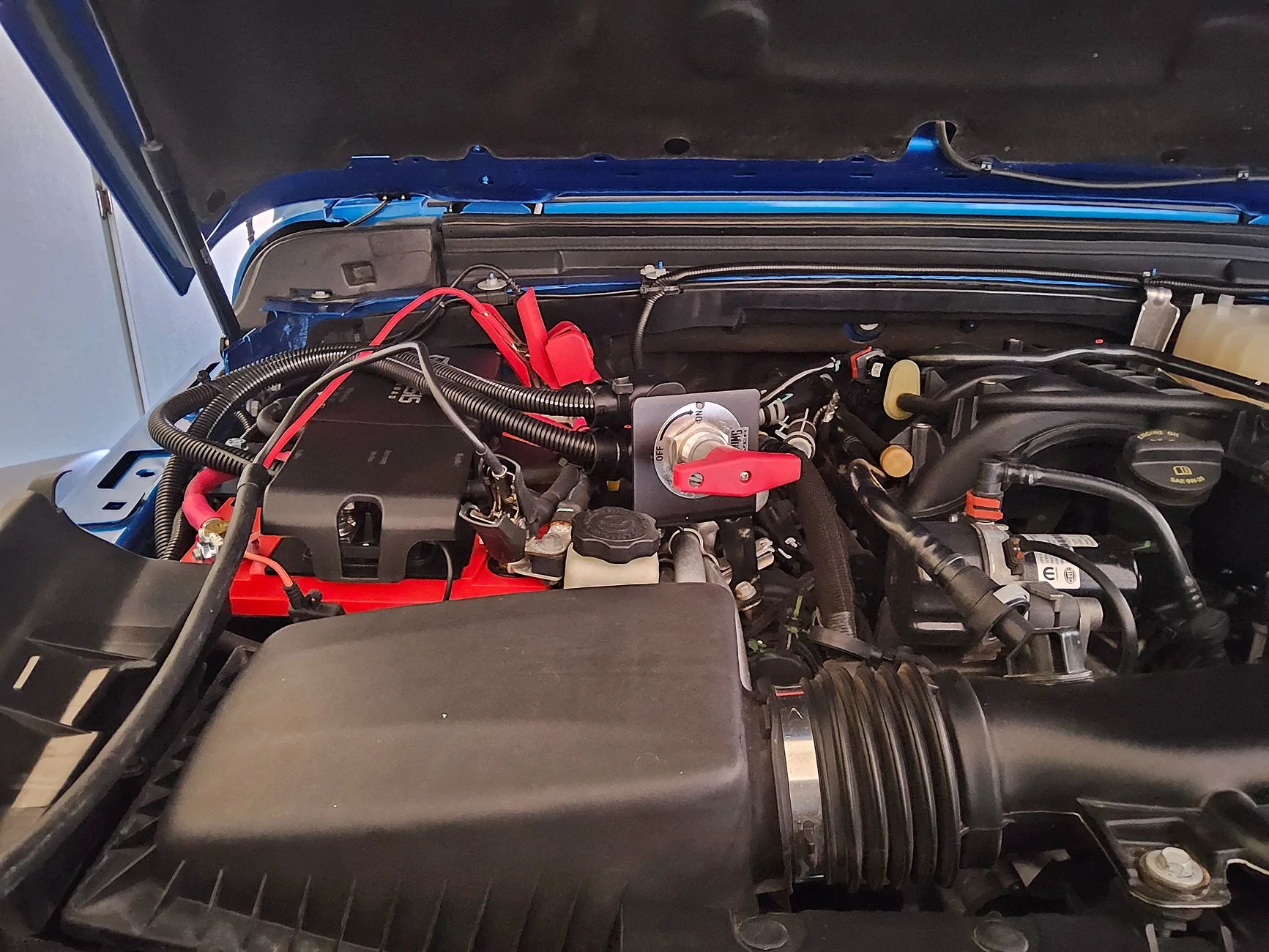

Last year, I installed the Genesis Gen 3 Dual Battery System with the Odyssey 25 batteries in my 23 Wrangler Rubi 2 Dr. 3.6L eTorque. It has been only a year and so far so good.
Since, I don't drive my Jeep daily, I use the Odyssey 25 Smart Battery Charger to main the batteries in the Jeep between the times I do drive the Jeep. The Odyssey battery charger is not cheap and will cosf around $500. The secondary battery in the powers the refrigerator, winch, air compressor, and some minor accessories.
I do have the Auto Start Stop feature, however I have the Auto Start Stop Eliminator Harness installed and I keep the feature constantly disabled. I still have the 48 Volt Lithium battery installed in the rear underneath the vehicle. I'm not positive on this, but I think the battery is still required for the eTorque system to function, so I'm leaving it alone and I'm not seeing a reason to take it out.
I have six other Optima batteries that range from three to nine years of age and they are humming along just fine mainly because I have the Optima chargers maintaining them. I have been using this method of maintaining them for almost 30 years and never had a battery failure situation.

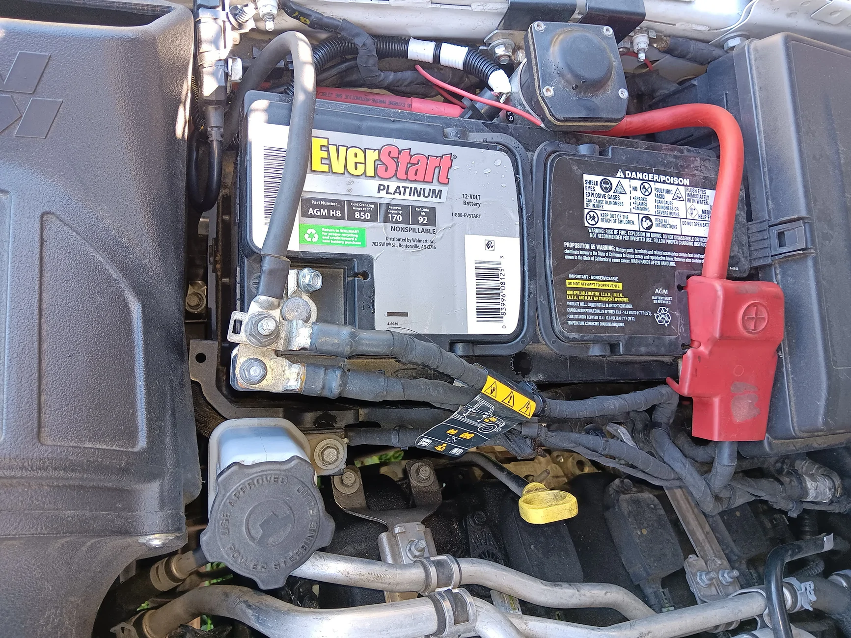

Somewhere in a thread I made here over 13 months ago shows what you can do to fit a H8 battery. I think you need to cut a 2" width at battery side of the fuse box stand end that is mounted to the battery tray.
Here is my setup...
Jeep Wrangler JL Battery replacement options 1000044786
I made the Aux battery cable a secondary body ground from the IBS.
